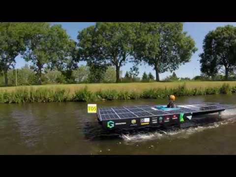

And I am now in the Dutch Solar Boat team ( 3 foil concept, large rectangular black boat :stuck_out_tongue: @2:10 below ) :
In my / our experience, where the small/big foil is placed depends on the weight shift contribution due to the acceleration / acceleration. In electric high powered boats such as solar boats in this example with about 7kW of engine power, the desire was for the two foil concept to have the small foil in the front. This was also practical for the weight distribution in combination with the hull shape ( large in the back → battery in the back ).
Funny. Last month on vacation with our boat we saw this TU Delft boat.
Ah coowl! This was probably still in the development / test phase, the PV panels seem to be missing. But they have switched back to 3 foils. I don’t know the exact motivation but from what I understood is was mainly for roll stability ( especially for side winds ).
TU Delft actually has electronically controlled foils which is very fancy and allow for super low drag racing. We still have a mechanical systems which has the advantage of being easy to repair when you are drunk :slight_smile:.
They used it to race last week. The official races were cancelled so they did a one day session on the Ketelmeer with 3 other boats I believe. The foils and struts which hold the gears with an engine in the hull is pretty cool!
