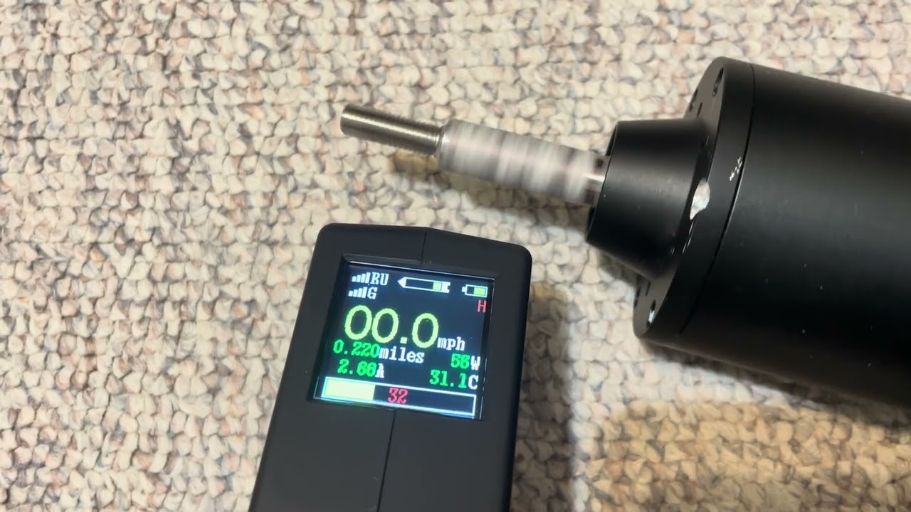

The ESC runs maximum Duty Cycle after FAULT CODE. Please look videos:
(Max Duty is set to 95% in the settings)

The problem is not the fault, but the full throttle after the fault. It is dangerous.
By “full throttle” I do not mean throttling and stopping, but rather accelerating at full power.
Does it stay full throttle even if you let go of the remote trigger?
No. It stays at full throttle until I go to 0% on the remote control. At all other values, it remains at full throttle.
