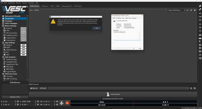

I am not getting anything popping up on the COM ports. Here are some screenshots, if it helps. Seems to be matching the baudrate with COM1, and shows that the port is working proberly.
The VESC Tool is giving me this message whenever pressing the connect tab:

That I have already tried, both relativly new pc running windows 11 home. I have seen in other forums, that perheps it has something to do with the bootloader, but I guess that wouldn’t be customizable without the connection to the VESC?
Does the screenshots attached above show that all settings are OK regarding COM port settings?
Should I do anything with the baudrate in VESC Tool or/and in Device manager?
