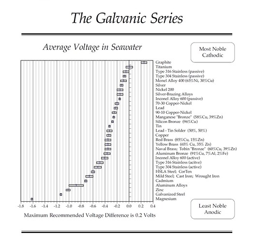

Has anyone used any 3d printed materials that contain a blend of CF for motor hubs and mast mounts for use in the sea? I have just printed some huns in PET-CF that have come out beautifully but then had a thought. The CF elements in the 3D print could cause a galvanic reaction with the motor stator it touches and my aluminium props.
Does anyone have a print with CF mix against aluminium components? If so, have you noticed a reaction and how fast is it corroding the aluminium?
I wanted to try something different to PC prints but may need to go back to them as I’m not keen on coating the parts of my PET-CF to create a barrier.
Thanks for any feedback on this.
James
Do you think your rig will be immersed long enough for that to occur?
Perhaps attach another material that is sacrificial?
I ride axis foils and notice small amounts of galvanic reaction around the foil to fuselage connections what with it being an aluminium fuse and carbon foil. Axis do put in a fibreglass barrier layer but small parts wear through over time.
I’m hopefully overthinking things. I think I’ll just give it a go and monitor it.
Yes the disruption of the surface coating will allow the corrosion to occur.
What I was referring to was attaching a piece of material that will corrode BEFORE the components you are concerned about.
