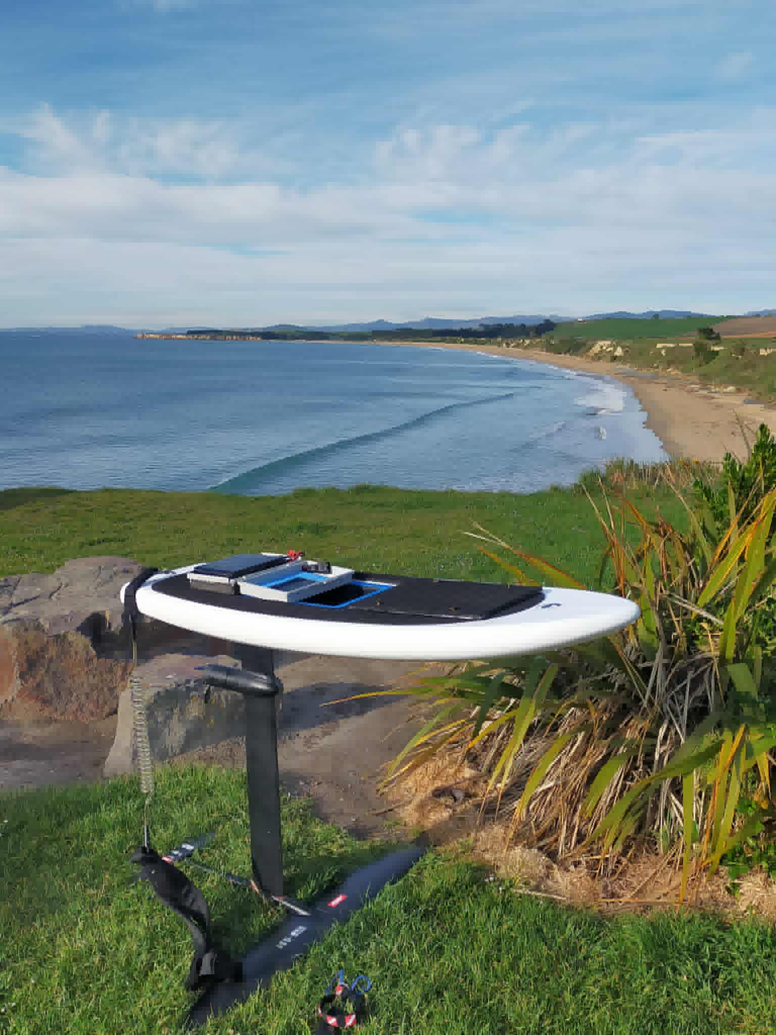

KIa ora Frothers,
I have recently finished my first build - 4ft10 x 20 in with an integrated Axis 19mm alloy mast - I had her in the water several times now and very happy with the performance of the board - having come from Foil Drive the biggest most obvious breakthrough has been smooth touchdowns without that sea anchor at the base of the mast, I would go as far as to say its the single biggest progression I have felt in my riding and has certainly changed the way I approach a wave.
This setup seems to be totally idling at cruise speed - the motor is very quiet - the pod is set at 19cm so I can usually keep th prop in the water but choppy conditions do lead to the odd free spinning event - I am using FD props in a magic hub - Mosfet is around 18 degrees
I have data logged all my sessions and the biggest negative I have found is run time - I am using 12S3P with Molicel P42A and getting roughly 35 mins if the wave riding is OK - this is constant riding with no breaks - by comparison my FD with max battery would get me around 45mins with the standard motor [not the new HP 6384]
The data log says I draw up to 60A battery power on launch and cruise at around 20A
For context the foil I have done most of my sessions on is the Axis Spitfire 1030 and I weigh around 95kg wet.
