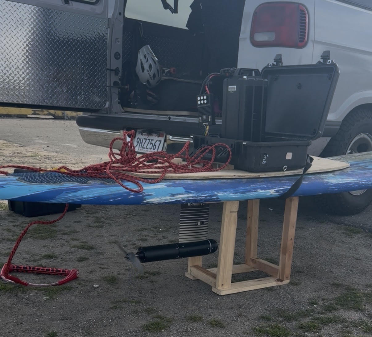

Hi, i wanted to share my tow boogie build, struggles, and successes so far.
Background:
I’ve been surfing for a few years, got into wingfoiling for the windy days, and started this tow boogie build for when there is no wind nearby. Needless to say i’m a newb foiler and i’m looking to progress - rapidly! The build is one of haste and convenience, if its not obvious :smiley:
State of the project:
Specs:
  • Flipsky 65161 120kv motor
  • Flipsky 75200 vesc
  • Flipsky vx3 remote
  • Rawrr mantis 72V/30Ah battery (e-dirtbike, thanks fb) (35 lbs!)
  • Pelican 1500 case
  • Cabrinha aluminum mast
  • 10x8M-LH APC-brand propeller (most success so far)
  • 3D printed motor mount which squeezes the mast

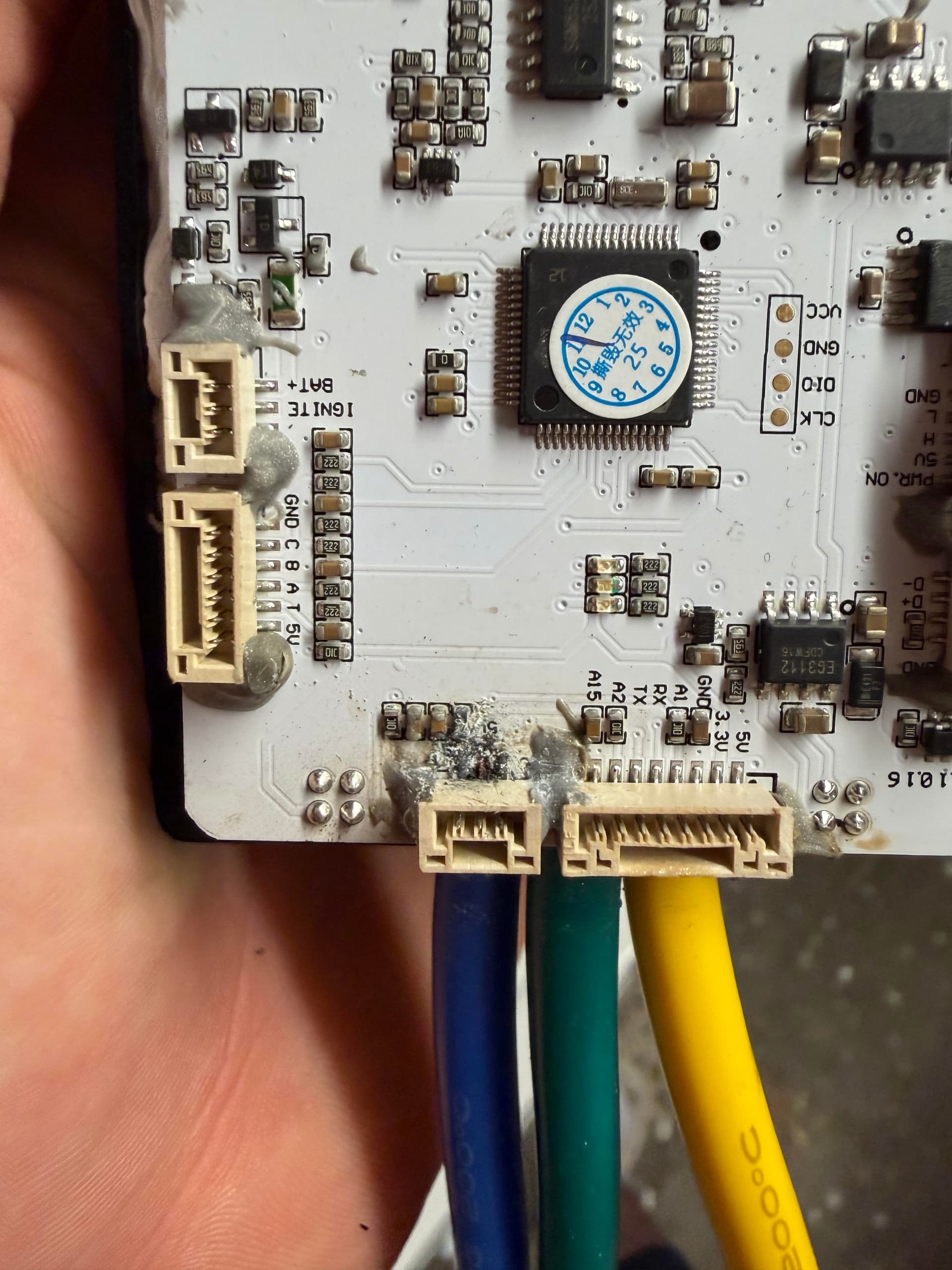

I had one incident where my wetsuit had dripped into the open pelican case unknowingly, creating time-bomb short of the receiver pins on the vesc.
When I got back in the water the boat took off with intermittent throttle leaving me behind! I had turned off the transmitter, plunged it under water, but the vesc had a mind of its own. Thankfully the boogie has a slight left steering bias and I was able to recover it ~200 yards down the dock/shoreline! Crisis averted…

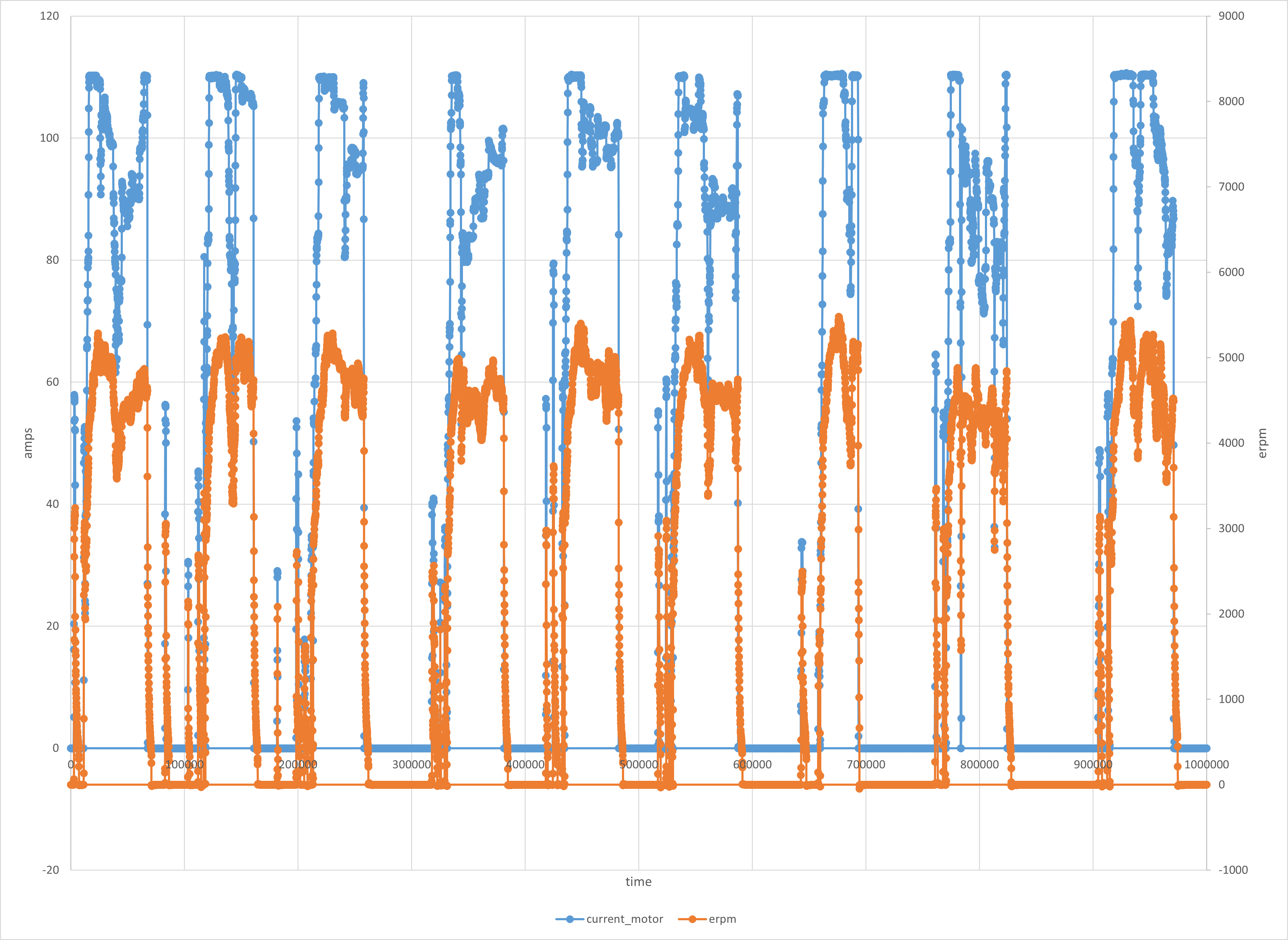

Here is a plot showing the amps and motor rpm for some 1 minute laps. The idle periods are me letting the handle go and trying to pump.
I consistently pull my software-set max of 110 amps to get on foil, and pull ~90 amps when on foil. The rpm is consistently 5000-4000 rpm, much less than my 72V*120kv = ~8640 max.
I think this suggests the prop diam is too large but the pitch may be alright. It pulls just enough to ride comfortably (albeit a pit high AoA on foil) on my 250 in^2 unifoil.

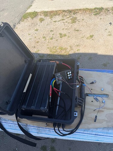

Heres the electronics in pelican case
Heres the esc with saltwater damage on the receiver pins
Heres the data of me pulling 110/90 amps to get up then cruise
