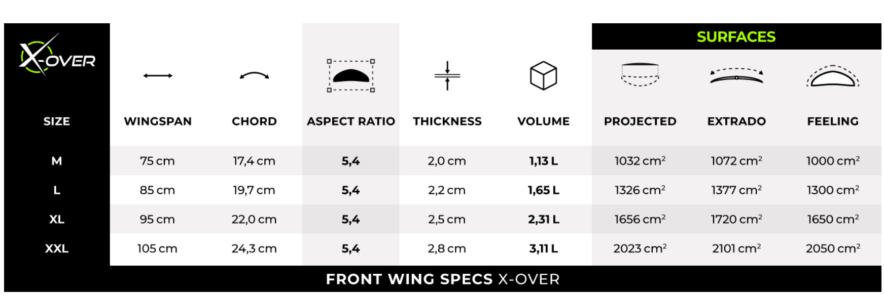

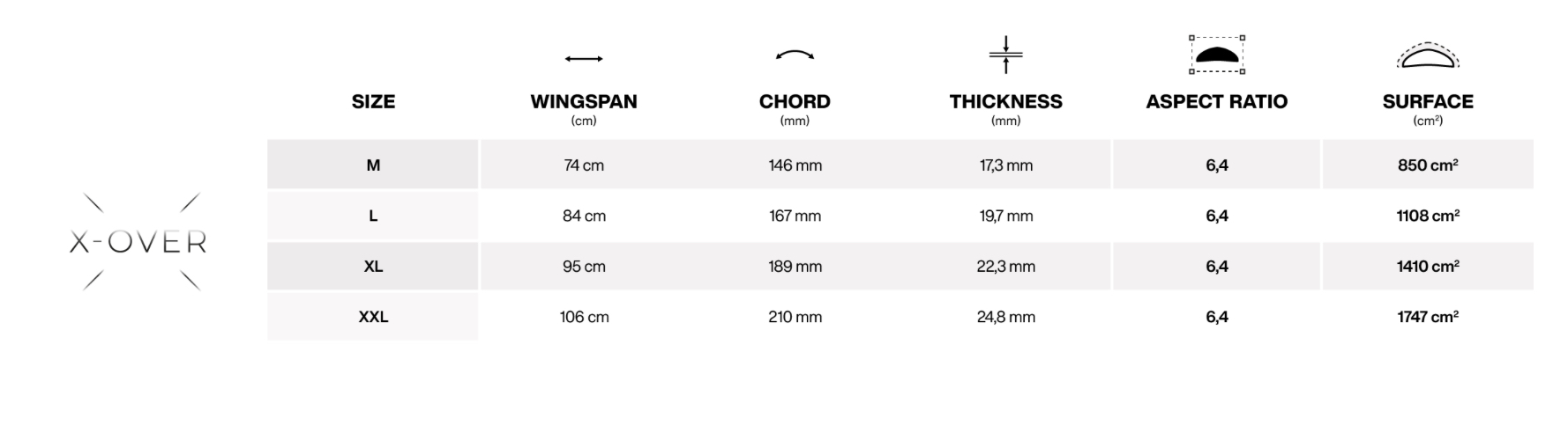

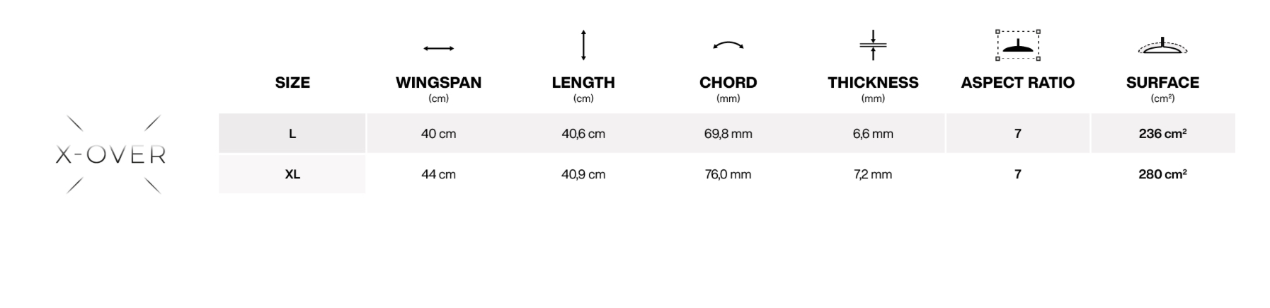

For reference these are the sizing charts from Gong for front foil and stab
V2
V3

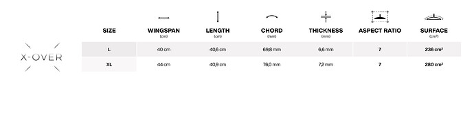

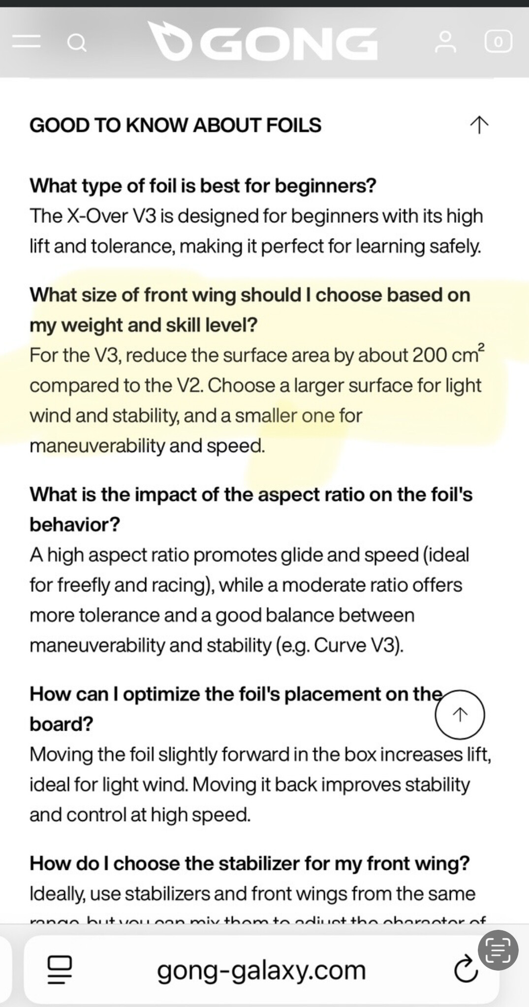

After quite a bit of interaction with Gong technical advisors I would share the following.
Due to the increase in efficiency of the V3 product over V2 they offer this guidance. In other words in my case I would chose an L size V3 to replace my L size V2

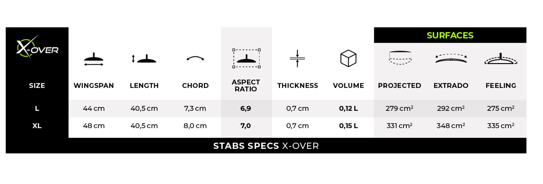

Specific to X-Over V3 they provided this chart

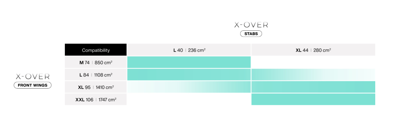

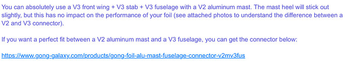

They confirmed that a V3 fuse will fit a V2 mast but would have a more efficient “fit” if you use this

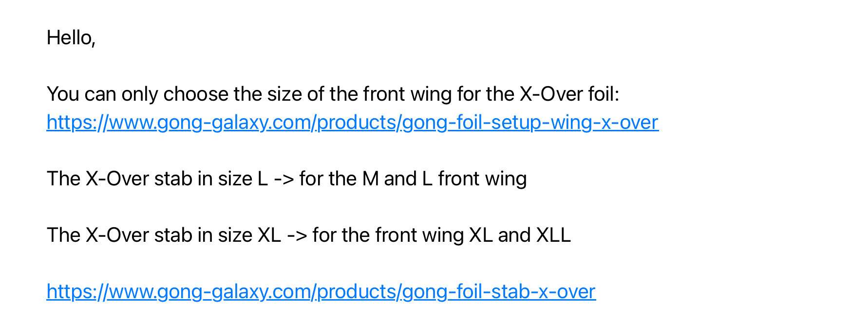

I also confirmed that you can’t specify which size of V3 X-Over stab comes with the front foil size IF you order the full rig.
