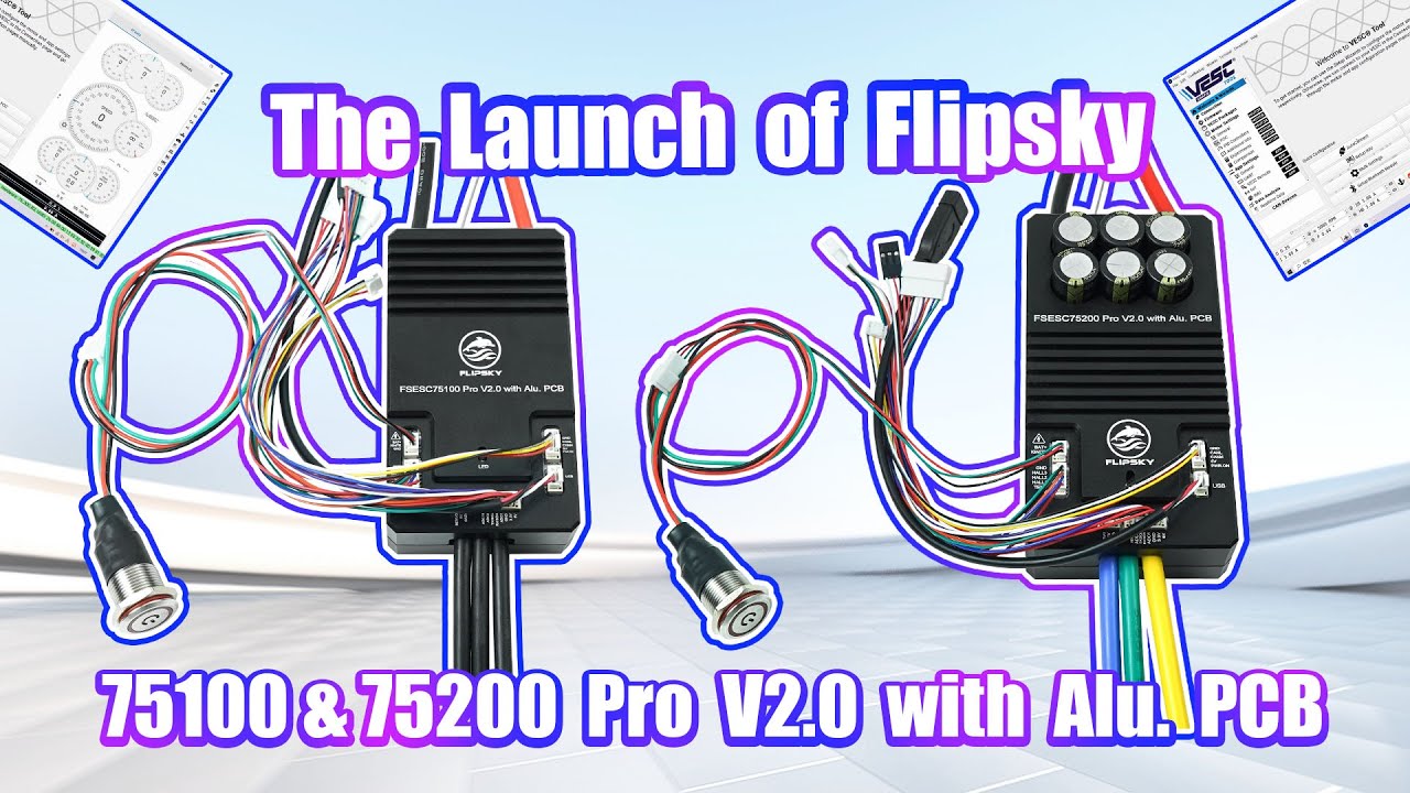

Have you seen New 75200 PRO V2 WITH Phase shunt ? Power button for kill switch?
Just seen this video about new 75200 PRO v2.0 with phase filter.
Probably they was bored about Customer service around firmware upgrade which fry VESC 75200 classical …
Link to Flipsky blog with a chart explaining differences
Boring that I bought the 75200 pro 84v 2 weeks ago from FLIPSKY …
The switch is nice feature, but only 1 uart.
Why do you want more UART? You can connect the new voyage systems to CAN and then the maytech remote to the UART and you’ll have all the telemetry you’ll ever need. Add in that the vesc also has built in Bluetooth anyway.
