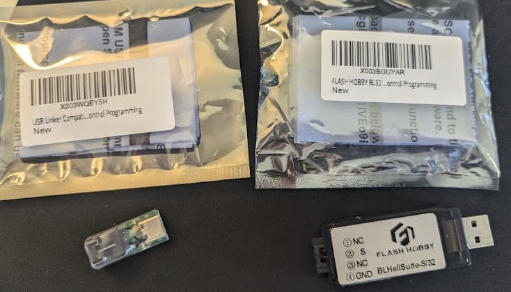

Hi man i’m back could ask you how can i connect the esc on a computer??? Finally has bought a sqesc 12200 200a but there aren’t any usb to connect him to pc….
Since your ESC uses BLHeli firmware, you need one of these:
https://a.co/d/8C5LTi6
or
https://a.co/d/6ElImM2
Then follow this link or top of the following page:
Help configuring FLYCOLOR X-CROSS HV3 using BLHeli-32 USB Linker with 6343 120KV motor - #2 by seantab
Make sure to post your results and how its running etc once you configure it, it would help others as well. thanks ang good luck.
