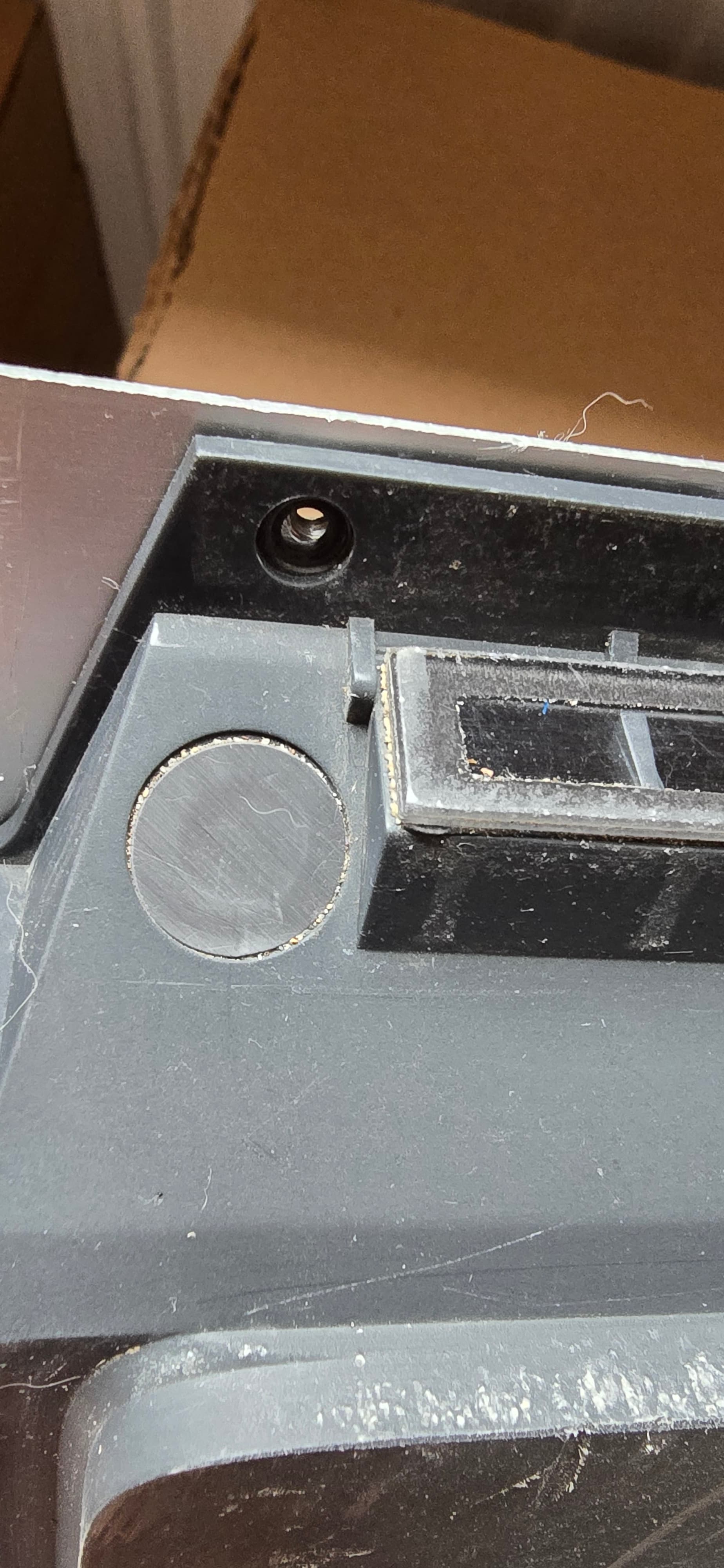

I use these patches. Before appying test with bulb for vacuum, then apply patch, done.
