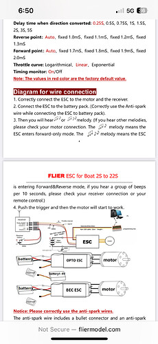

http://www.fliermodel.com/Data/fliermodel/upload/file/20230214/Manual%20for%20Boat%20ESC-1.pdf
This is the manual for that esc. Are you sure you have the receiver plugged into the signal wire correctly ? Looks like the is a signal wire as well as a usb. Perhaps you plugged it into the USB?
Does the ESC provide 5V power to the Receiver? Looks like it’s an isolated one, so you’ll need an external 5V supply, a 5V BEC for example
Oh yes, so yes supplier just said there is no internal bec so Ill need to get a external to test
But based on Flipsky manual, I can just connect Battery power to Bat+, no BEC need
I think that BAT connection is just for measuring and displaying the battery status on the remote, not for supply…
Oh I see, okay. I will keep yall posted. I need to decide if I want to get a ESC with a internal BEC or just a separate on
We used the same ESC’s (two) in our jetboard build.
You WILL need an external 5 volt power supply to power the receiver.
