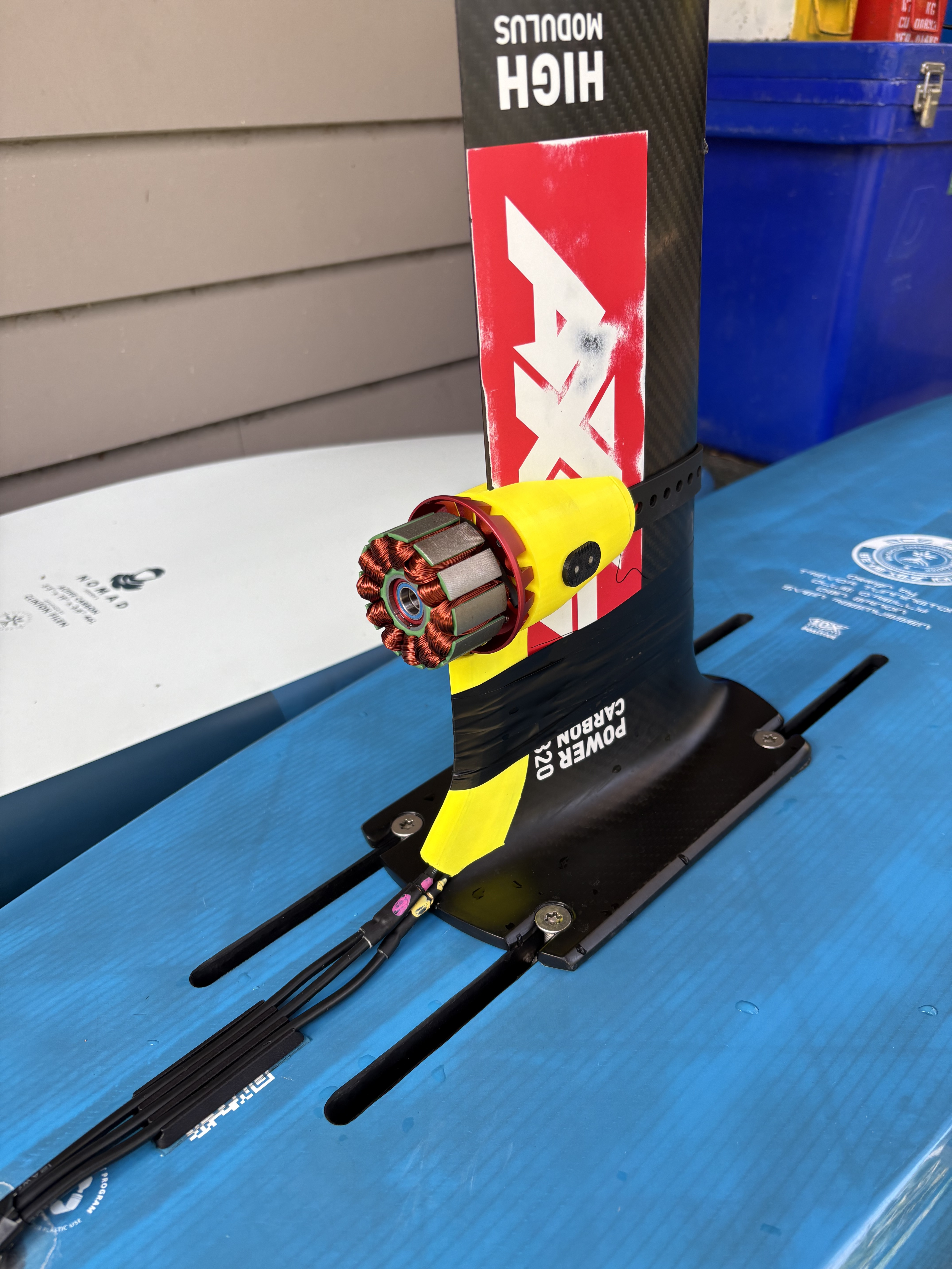

If you do a mini pod with a grunt strap it’s cheaper and less drag. Not sure if you have cad skills. I just print them in tpu and they work well.
I’m in the US (Florida). I just found in one of your other posts that you’re in Australia so maybe somebody there can do it. (Shipping would be pricey for me, same as it is for Craftcloud.)
This one looks sharp. Pretty awesome. What provider did you use? I have zero cad skills and only learned what a .STL File is a few days ago lol. What do I need to learn? Can you share the files? Cheers
