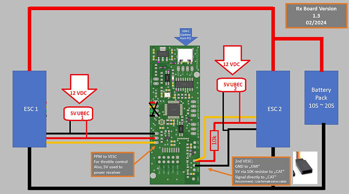

Overall wiring diagram:

Thanks @Jesserosco I’ll give it a shot. I’ve been doing that but no luck. I thought maybe on receiver side i need to adjust to reduce signal output voltage. The potentiometer and flipsky receiver puts out between .2 and .56 volts at signal but Bremote receiver puts out around .5 to .8 volts. But I keep fiddling around with x cross throttle setting. See if I can make the thing work. It works perfect with flipsky Vesc but not with xcross esc. Oh well The fun continues
