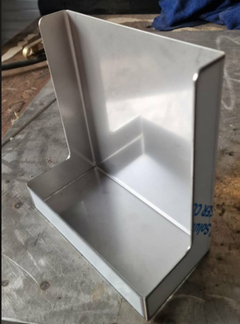

Here is the Packraft approach, Its a metal “backbone” made of sheet metal and Waterproof fabric (Packraft fabric and/or dry suit fabric). The fabric is glued onto the sheet metal then made waterproof with a zipper or just folding it over on itself (like regular waterproof bags). The main idea here is that the metal backbone will act as a large heatsink and dissipate heat the battery as well as the ESC. With plenty of room for wiring and perhaps some refreshments :slight_smile: etc.

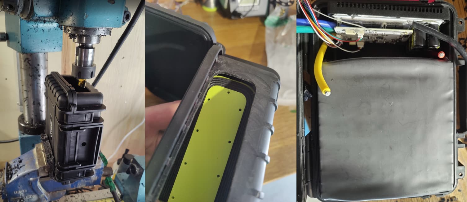

Here is the off the shelf box approach. Its similar to several builds we have seen here on foil zone. Heatsink for the ESC is milled through the side, the green part will be milled in aluminium and bolted to an external heatsink, clamping the cutout, preferably, waterproof. the box is only 500g and can just barly fit the ESC and the battery. Which we think is nice for waist mounting. The box also has these external fins, that will be nice to protect the Cable glands.

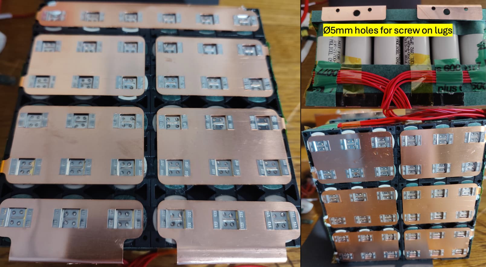

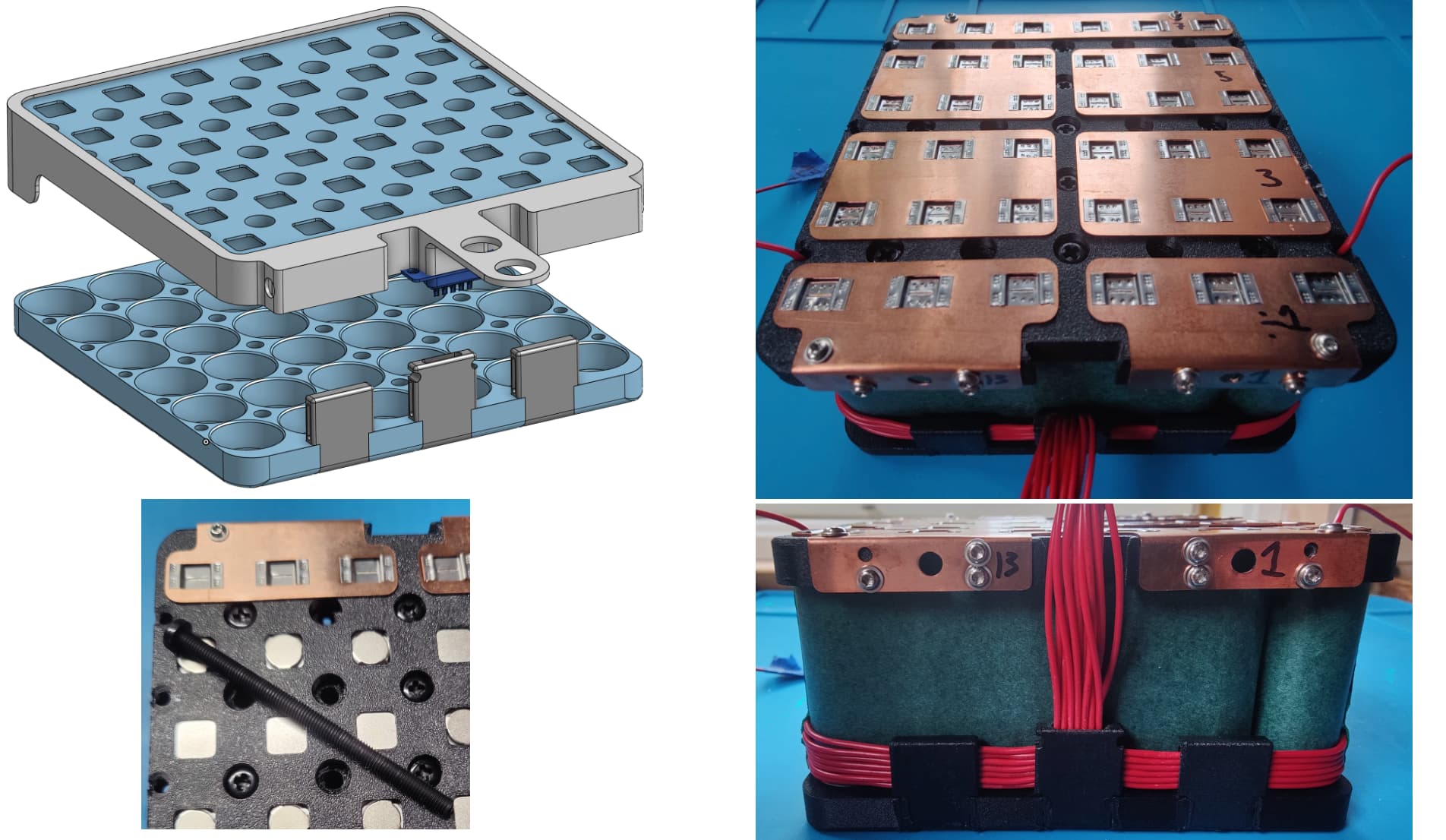

Our Battery will be 12s3p 6x6 21700 cells. We ordered 5x custom copper busbars with pre mounted nicklecopper weld strips from a shop at aliexpress - they look great! For next order we will move the balancing wire attachment as shown with the red dot, to prevent the battery from being wider from the balancing tab. We ordered a K-weld with a car battery, and started playing with welding. Having almost zero experience with battery welding, we thought we found a decent setting of 45J. At least Gemeni told it was approporatly dialed in.

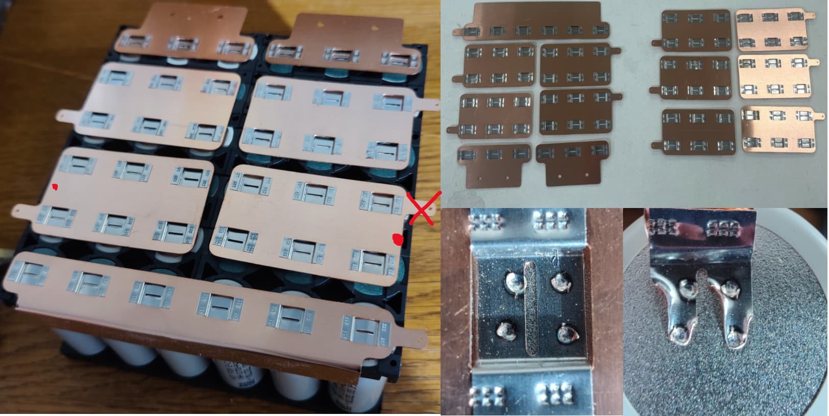

At the day of welding the first pack something went wrong :upside_down_face: After welding all the cells at 45J we found that at least 3 cells was punctured and leaking. It most definitively was user error, most likely too much force on the electrodes, incorrect/different calibration or different voltage on the battery (if that matters?). The battery was charged overnight, and the calibration was done holding the electrodes slightly different the next morning. In hindsight the welding should have been done immediately after doing the test welds. If anyone have some good tips here that would be appreciated. We are considering making a spring loaded mechanism of some sort, or weld under a microscope to make it more controlled. In any event - we have many more cells so we will just start over, and implement some improvements observed in the first build.

As for spotwelding the well go copper nickel strips, I weld them with 25J with Kweld. You might have to re-sharpen the electrodes on a lathe or drill press with sanding paper. Do some tear off tests on spare or old cells.
Thanks, will fun to build again! Awesome that the remote is still in use. We will definitely start lower on the K-weld next time :sweat_smile: tested all the way up to 80J without blowing through on some test welds on the minus pole, so was a bit surprised that 45J was enough to go through. Nevertheless a good but expensive lesson.
How many welds do you do per strip at 25J, and how do you hold the electrodes? Not that much space down in there.
Hey, nice to see you around. I was looking in to your remote the other day actually I am looking to design one my self. Did you ever share all the files for it in one place? Cheers
Welcome back :slight_smile:
The post about your DIY remote back in the days was one of the inspirations for me to start the BREmote project :slight_smile: If you want to try the new BREmote V2 nano for your assist let me know! I think it would fit nicely in terms of size/shape and functions. @sat_be is also testing it on his remote currently
I’m surprised you blew the cells with 45J. What material and thickness is inbetween the copper to which you weld the cells?
On 0.15 pure nickel I once blew a cell (VTC6) with only 30J
Damn! That is fast. Needed 50-60J to even weld 0.2mm. Might have been 0.22idk.
Which spotwelder are you using?
I assume the less expensive models may not be too accurate about the energy… and kWeld the energy is precise but peak current also changes the behavior, with bad input sources (peak currents <1000A) you tend to need more energy because the longer weld times mean the heat “runs away” from the weld if that makes sense
Makes sense. It was with a Kweld. Roughly 1150A.
Which weld do you recommend? Can be slow, but needs to be safe.
Odeer09 - I think its on here somewhere, if you cant find it, send me a PM and I`ll see if I can dig it up form the archives.
Ludwig_bre That is awesome, very cool to hear that you got inspired and are still going! We would be happy to test the nano. At this time we are leaning towards using a wired remote, as we already will be tethered to the board. Killing to motor logic mechanically through a wire seems more safe, also no need to charge the controller and deal with potential connection issues.
DutchFoiler - its a 0.15mm Nicklecopper fused sandwitch. We get 1500±100A from from a AGM car battery using the K-weld.
Newguy - I dont know much about spot welding, but I think the consensus is that K-weld is the best for small scale battery welding.

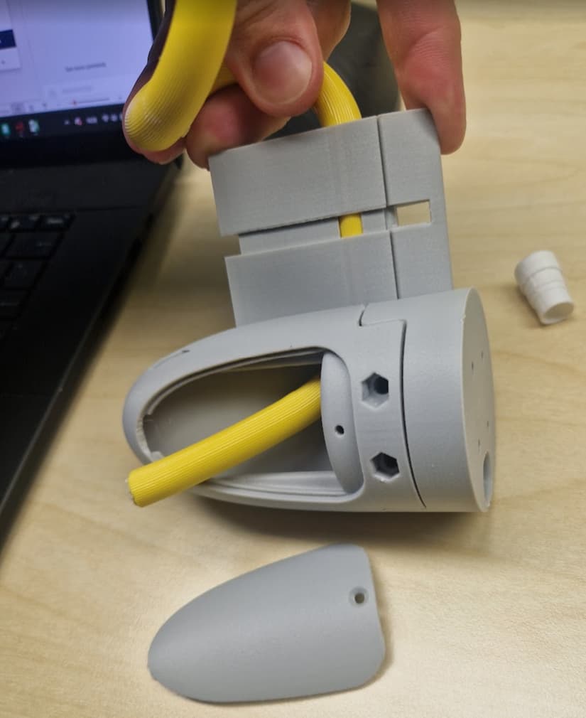

Junction box in mast mount, or in the board?
Printed a modified version of Andrew W’s zip-tie design found on Printables - great design! ( dont know if you are here on the forum)
I tweaked it a bit to have a junction box in the nose cone, but is this actually better? Currently planning on running a ø11 OD PUR jacket cable with 2.5mm² copper.
The thought was that having a single cable run up to the waist pack would be cleaner, but I kind of still need an anchor point in the board anyway for strain releve.
Having the 3-phase wires run directly allows for a sleeker profile, but those can be a bit annoying and more easily damaged than the tough PUR jacket.
Anyone gone down this road already?
also 3d printed tpu cable gland inserts?
i orderd a few but they came with the wrong compressino element so i wanted to try and 3d print a better one but is it actually better?

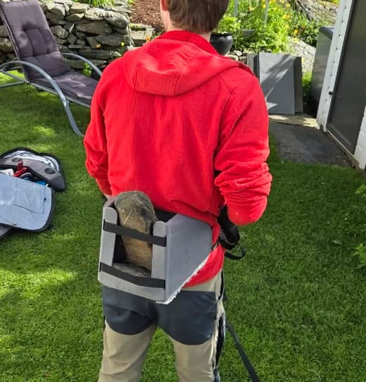

also here is some progress on the stainless steel back piece and TPU waist strap!
will try and bond the tpu fabric to it and insert the cable glands over the weekend.
tpu printed backpiece actually fits very comfortable. testing it here with a few rocks.
i also sunk it down to around 3m depth eventually most of the infill got satureated so i am considering making it so that it drains rather than having closed innfil.

Finally made a new battery design and battery. No fizzing batteries this time, and no acid on the table :upside_down_face: Went with 25J as sat_be used, that seemed to be good for us as well, did 3 welds on each cell.

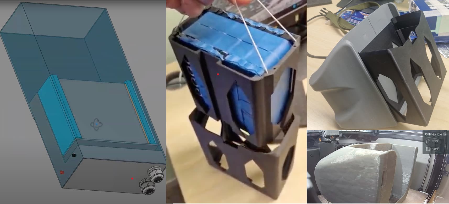

Ended up printing the trays in PET GF15% with a TPU soft edge protector on top, to protect the terminals and rear folded over busbar, the TPU edge also have a small lift handle, to get the battery out of its enclosure. The two battery trays are boltet together with Nylon screws and nuts. The assembly will be covered with a 1mm thick heavy duty Heat shrink. We made some small cable harness holders for the balancing wires to tidy them up. A high density D-sub 15 pin connector will be crimped onto the balancing wires for charge balancing. We ordered connector pins that should be good for 500 cycles - on paper way more than the battery. The BMS will be charge only, and will be in the charger instead of the battery (not sure if that is a good idea yet…). We will use M5 crimp connectors to attach the battery cables with amass 150 connectors.

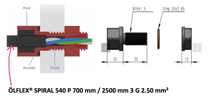

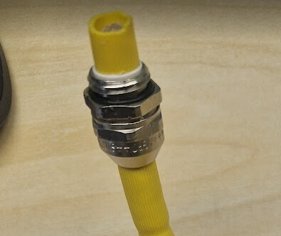

We also settled on cable penetrators as used for ROVs - at least temporarily. We found some in aluminium on aliexpress with a decent sized O-ring. We want to make the sealing surfaces (against the enclosure) to be mechanical not glue - particularly because the backup path case is Polyproplylene, so it will not stick work well with glue.

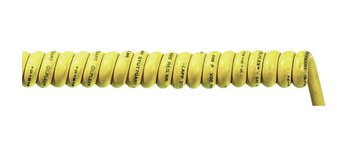

We also landed on a power cable - Ölflex spiral 540 p 700mm/2500mm 2.5mm2, Seems to be resonable length, robust and fairly easy avaliable. The current plan is to add a tubular webbing that is slightly shorter then the extended length over the coil. Although it it very tempting to just use the cable as the leash.

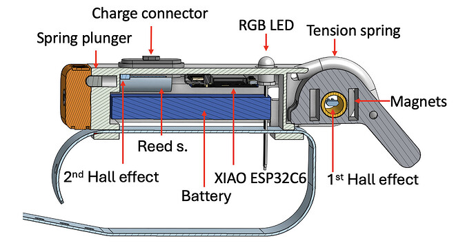

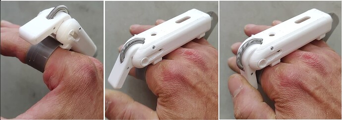

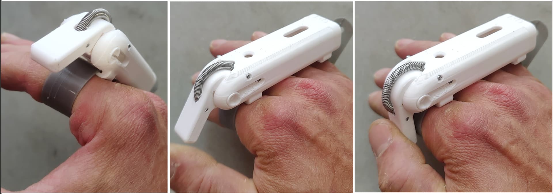

After getting the shielded cables and realizing how stiff they are, we ended up with going wireless! Ludwig_bre was so nice that he sent us a free nano Thanks, it looks great!
As we had already designed a wired remote, we wanted to see if it was possible to make the wired remote wireless. It seems feasible, the design intent is to get the remote out of the hand, so all fingers are free to do other things.

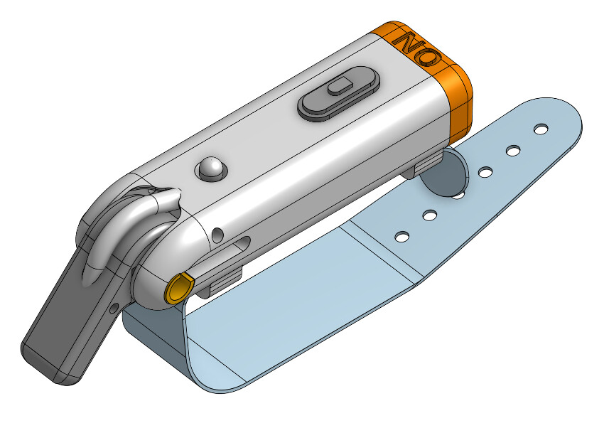

Here is Gemenis rendering (based on our 3D model).
3D model:

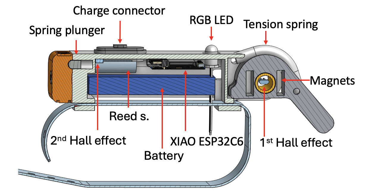

Internals:
First print test:
It actually feels quite nice. Its small and not too much in the way, you can grab the board rail, and do regular popup without the remote touching anything or being in the way.
It will only have one “smart” LED mainly to reduce power consumption, but quite frankly we think its enough. Logic → When remote is power cycled the LED will during intiallizing show how much power the remote has (green, yellow, red, red blink). Once connected It will show the battery pack status (green, yellow, red, red blink). Some blue blinks can be used to show different connection states.
The orange on/off button can be twisted to turn a reed switch on/off. The 1st hall effect gives throttle input (same geometry as hiorth v1 remote). The 2nd hall effect is inteded as a seperate kill switch - to kill of the throttle if the trigger jams or just during riding. We also plan to have a arming sequence - the throttle needs to be pushed fully, then released, then pushed again (within 0.5s or so) to actually spin the motor.
We plan on printing it in hard TPU, then pot it with tpu potting compound. The board can be programmed wirelessly.

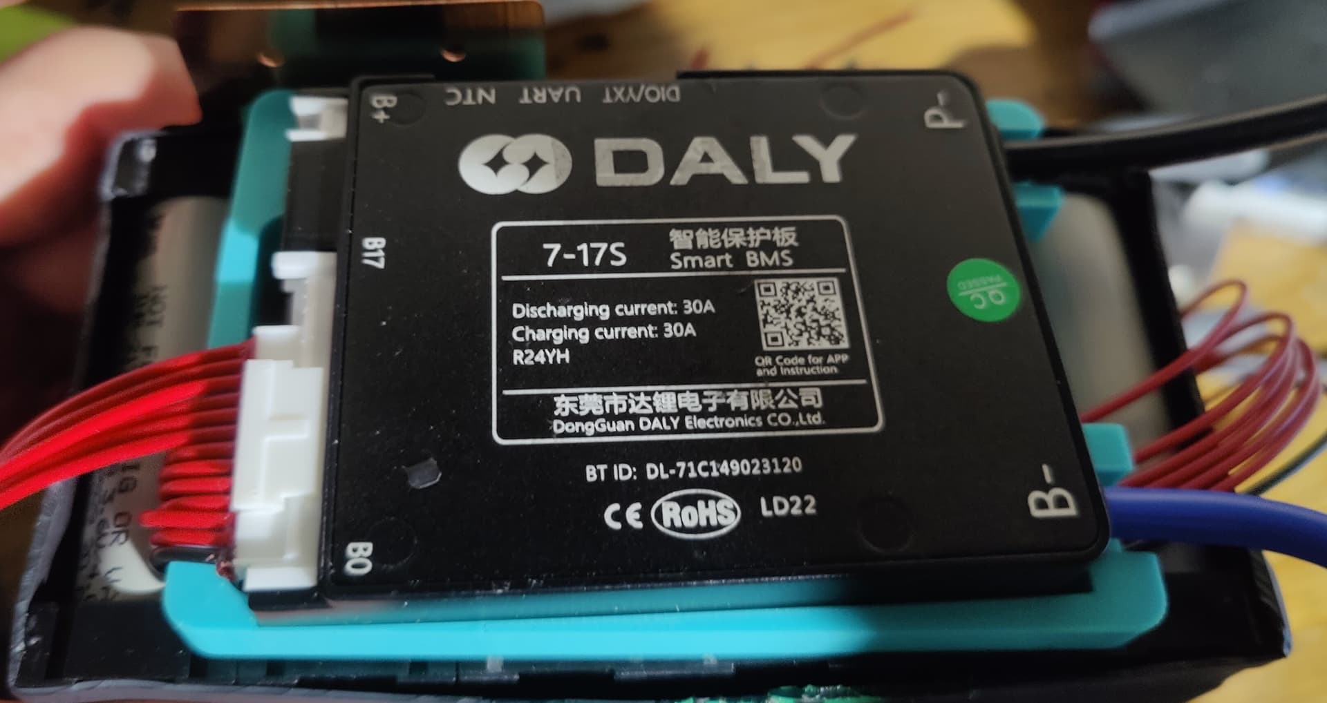

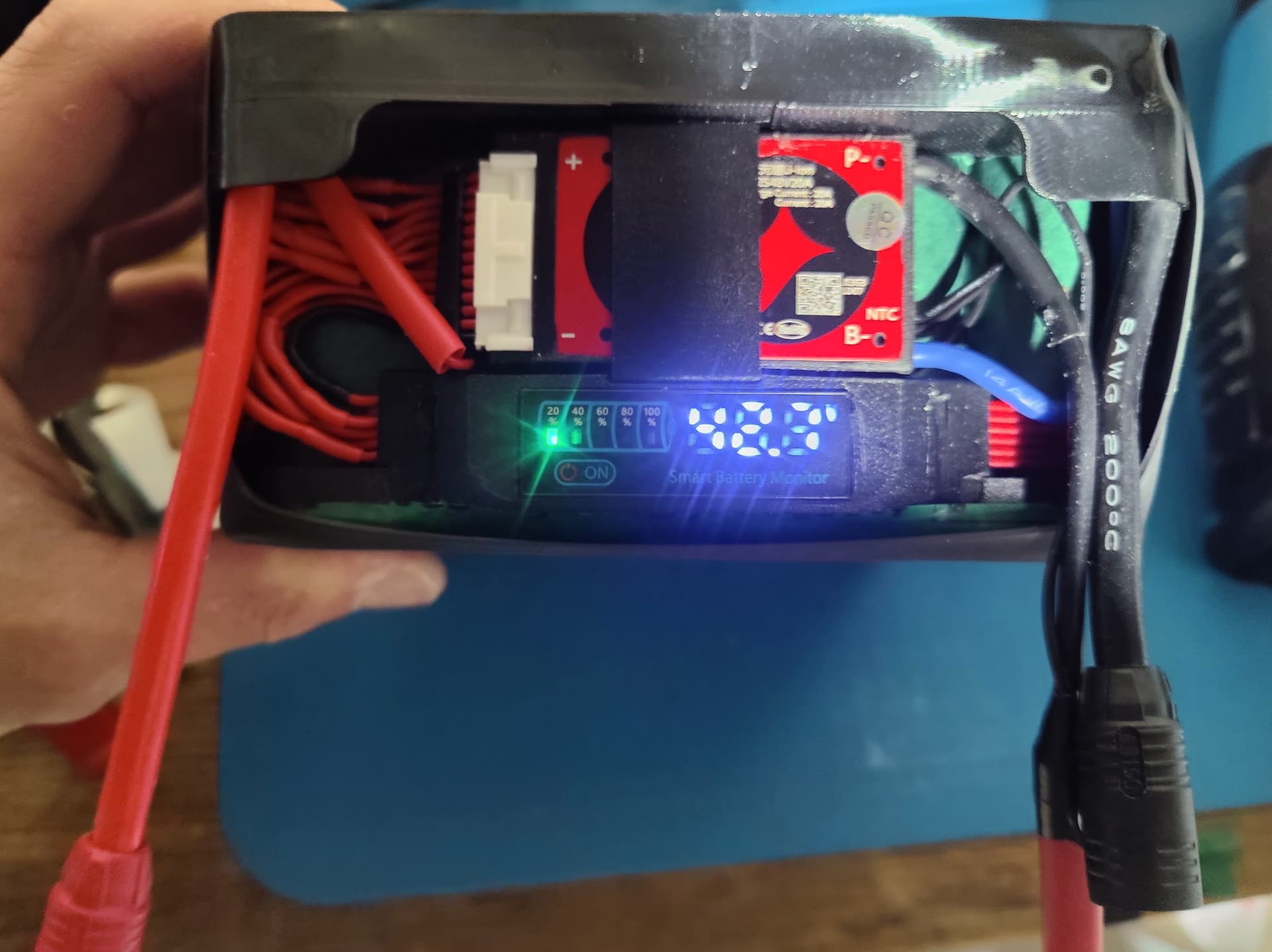

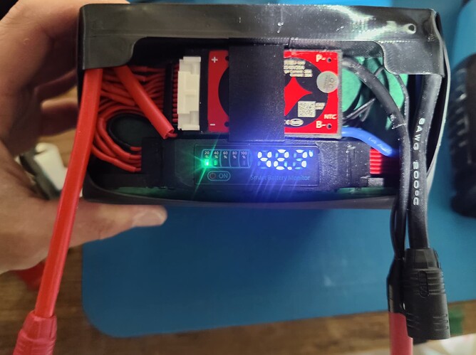

Battery is more or less ready, managed to find a tiny enough 20A BMS that will be charge only. added a smart battery meter from aliexpress, seems to work, but not sure how much current it pulls in sleep mode, connected it on the P-, so the bms will cut off before it drains the pack completely. It is tempting to just fill the battery with epoxy or some other potting compound. Anyone with good experience doing that?

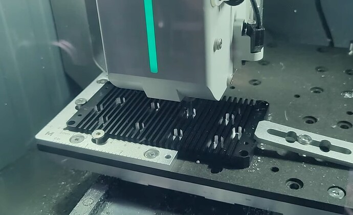

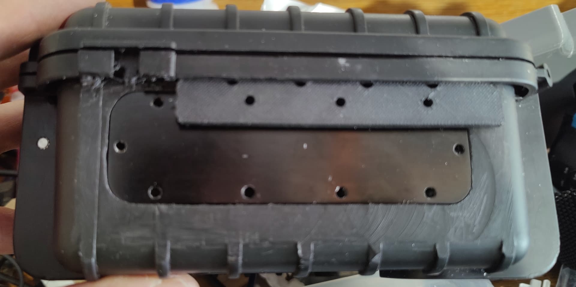

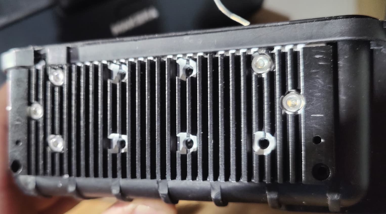

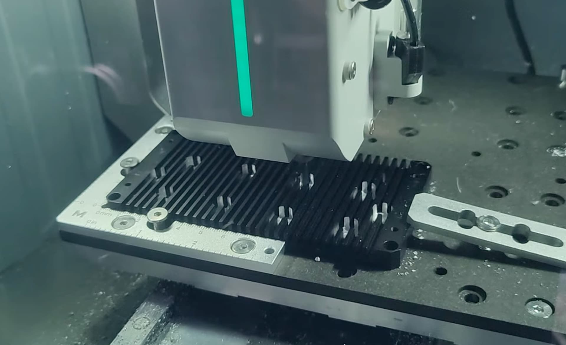

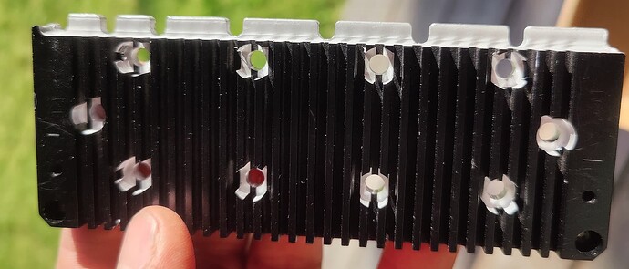

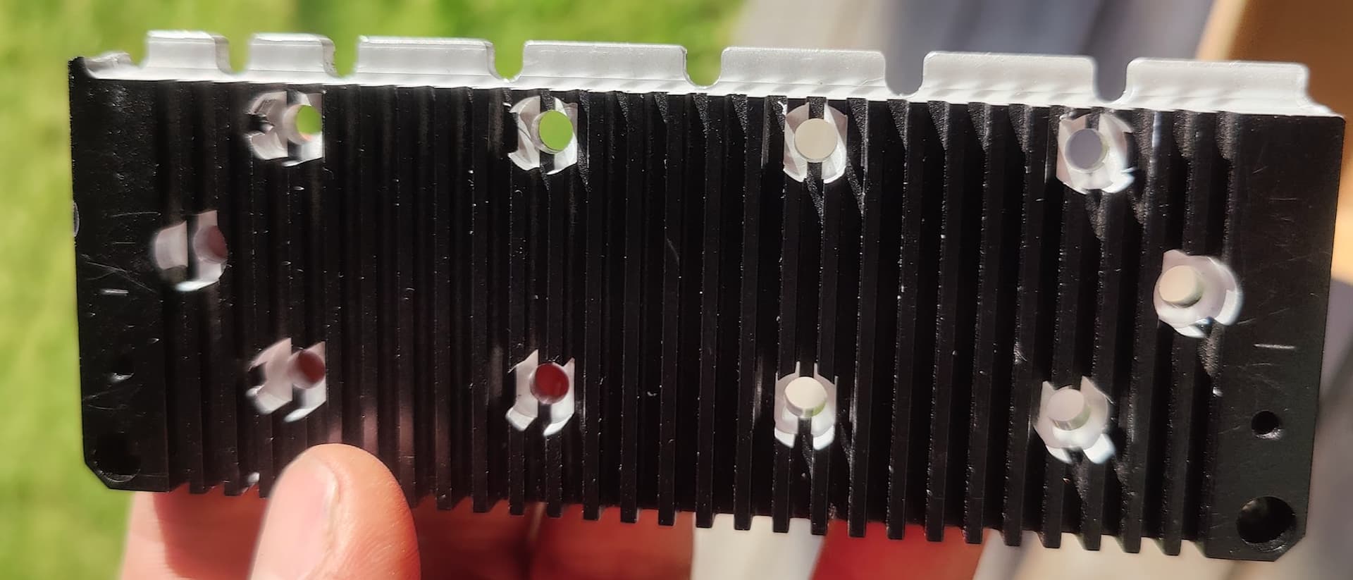

Got a Makera Z1 from kickstarter its pretty nice! Used it to modify the flipsky 75200 esc heatsink to fit on the outside of the box - it was quite straight forward, easier than expected. I did 2-3 3d prints to get the “toothing” to interface with the box correct.
The part only needed to be machined on the top with some holes to fit the box, the width was well suited.

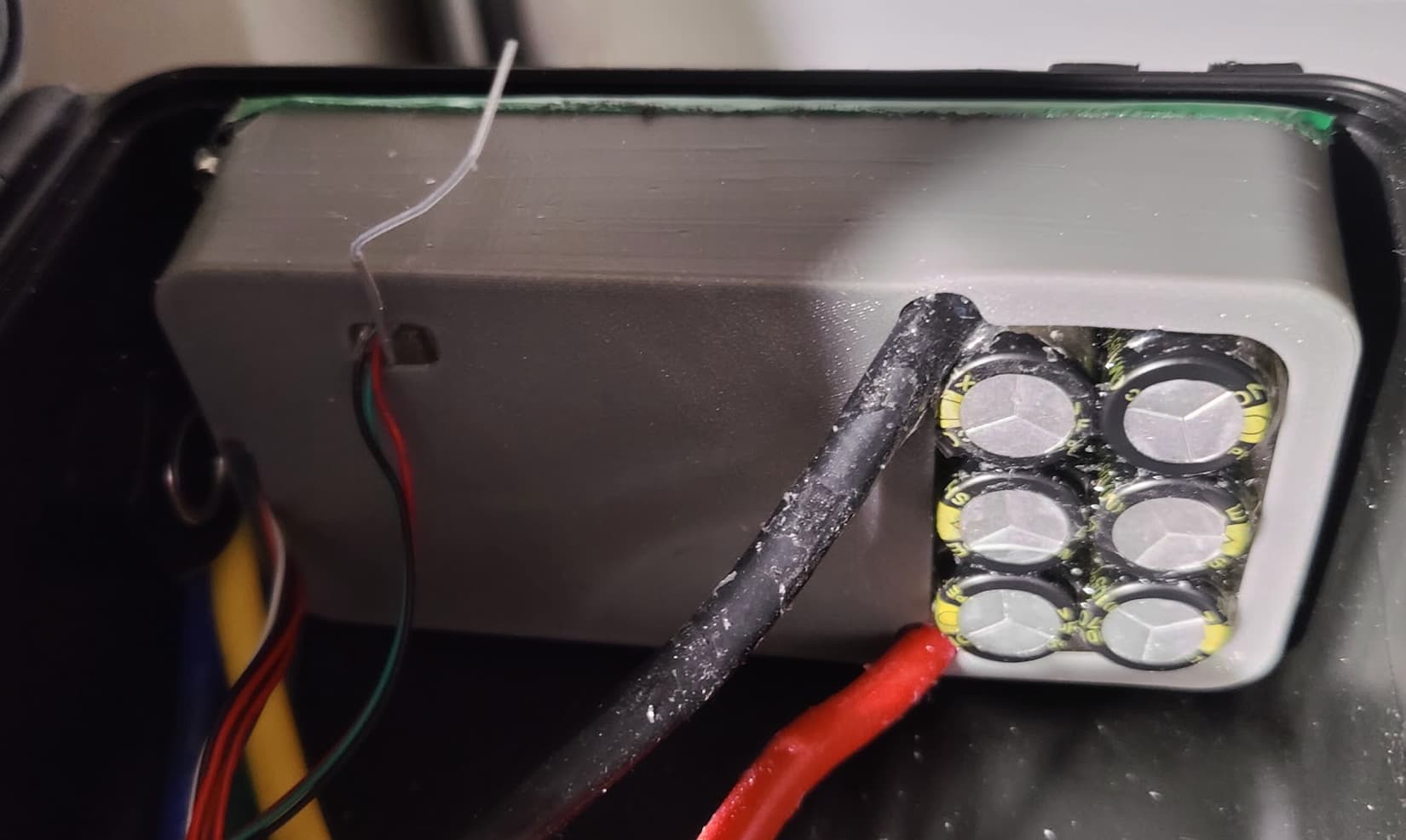

The Esc is potted with silicon, and a 3d printed TPU skirt installed around it.
