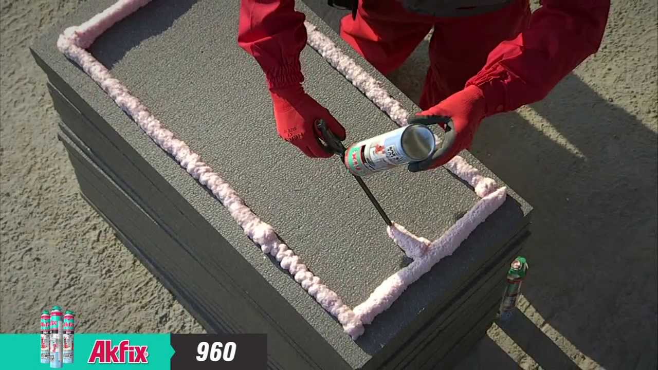

You could try spray foam in-between layers… This stuff is sticky and light… Plus if you choose the right type for your foam… You might not be able to tell where it was glued!
So. Pull the blocks apart, foam, and put them together again?
(pur: https://www.karwei.nl/assortiment/soudal-brandvertragende-pur-bouwschuim-500-ml/p/B521868 )
Hi Kian, I have some experience with Super 77 and it’s a great product for a lot of uses but just as you mentioned, it’s doesn’t work that well on joining EPS blanks, my advice to you is take it apart if possible and instead use expanding spray foam for insulation/construction.
Edit: Video
Prepare a lot of weights dumbbells/bricks etc.
You must work quickly!
Yeah assuming they will come apart easily! I used this technique before and it blended in very nicely! Look for spray foam with smaller voids/higher density, it should work!
