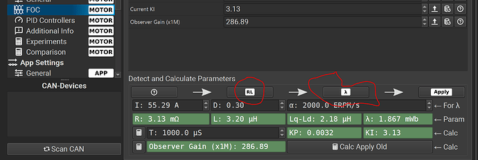

So, big revelation and move forward. The VESC motor wizard does not determine all parameters. You need to go into the FOC analysis and run two more tests.
Now, the motors are not stuttering and the VESCs are not freaking out!
If you write the parameters after using the motor setup wizzard, this should not be necessary, the motor tests are just an alternative method to determine the motor parameters. Arow down M in the bar to the right, saves the motor patameters. If you reconnect the vesc to vesc tool, use arrow up M to load the motor params from vesc into vesc tool.
Running the motor wizard did not set these parameters. It maybe a Maker X thing, but they highlight it on their website;
Ah, OK, I see, it is the sencond VESC connected over CAN that does not get those params.
No, I connect to each separately. For some reason, the G300s are not picking up all teh parameters
