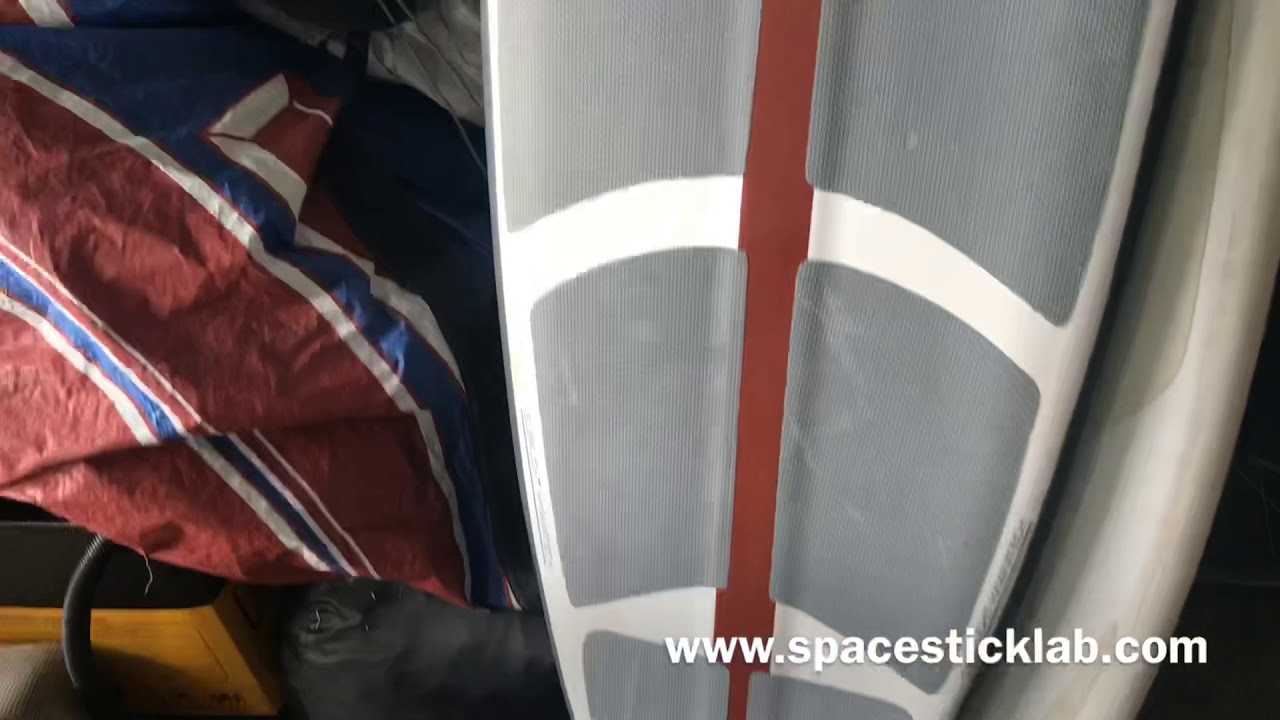

You can use a two part board grip lacquer like they do it on wind- and kitesurfboard and add a SUP traction-pad.
Thanks. I already got the anti-slip texture technique nailed though. I did a climbing volume 2 years ago with perfect texture. https://youtu.be/Lp2mkK2qPTc
Recently I found this “Van der Waal Surf Grip” on https://waal.co. There’s also a review on https://youtu.be/szUFy_GkxOA.
i just received mines… board’s not ready yet, i should install them in a week or 2… test in the water in around a month…
Another solution, the Wax Mat grip, available in rectangles (cut to size) or bands. Could be cut in hexagones like the Van der Waal grip or google wax mat.
