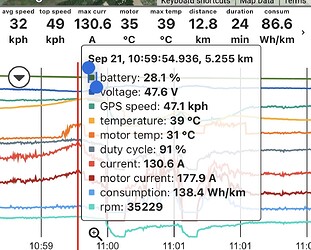

Well, it depends, if you go fast you actually do get to 6kw, this is with a Lift motor:
