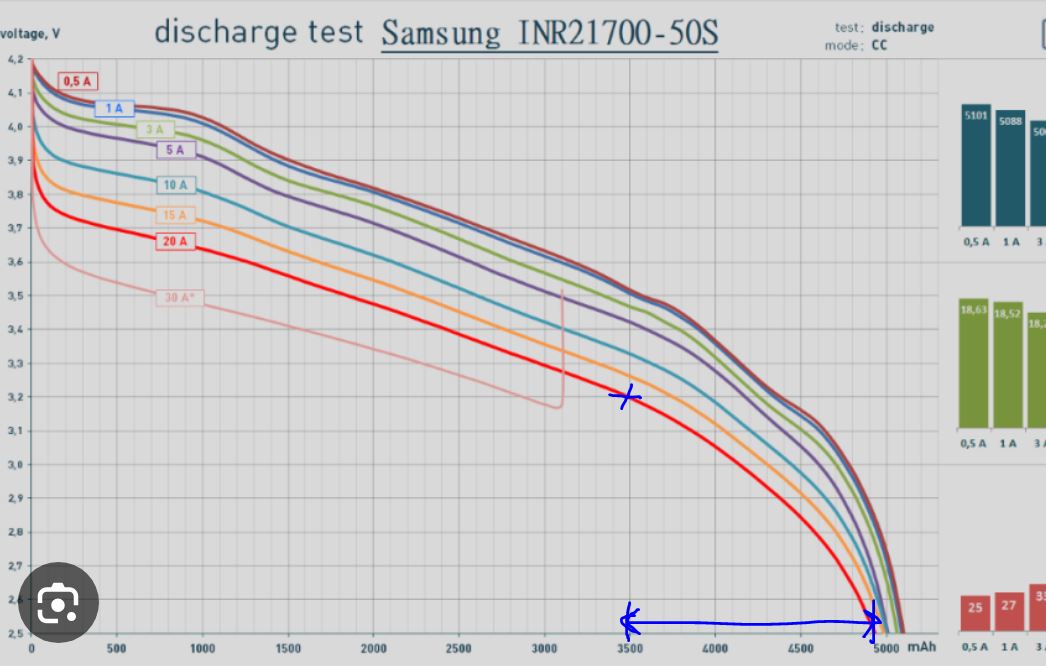

Maytech are conservative when they estimate Battery % on the controller. The remote shows 0% when the cell voltage hits 3.2V (I asked Maytech this directly).
This means when you see 0% on the remote the RX is reading 3.2V per cell. Which is conservative. Many cells are rated to 2.5V minimum (such as the Samsing 50S cell). Here is a random capacity curve for the 50S (unsure how accurate this is - but the best I could find). I’ve assumed 20A which is more than what I use (I’m more like 15A per cell), and the capacity left between 3.2V and 2.5V is significant.
