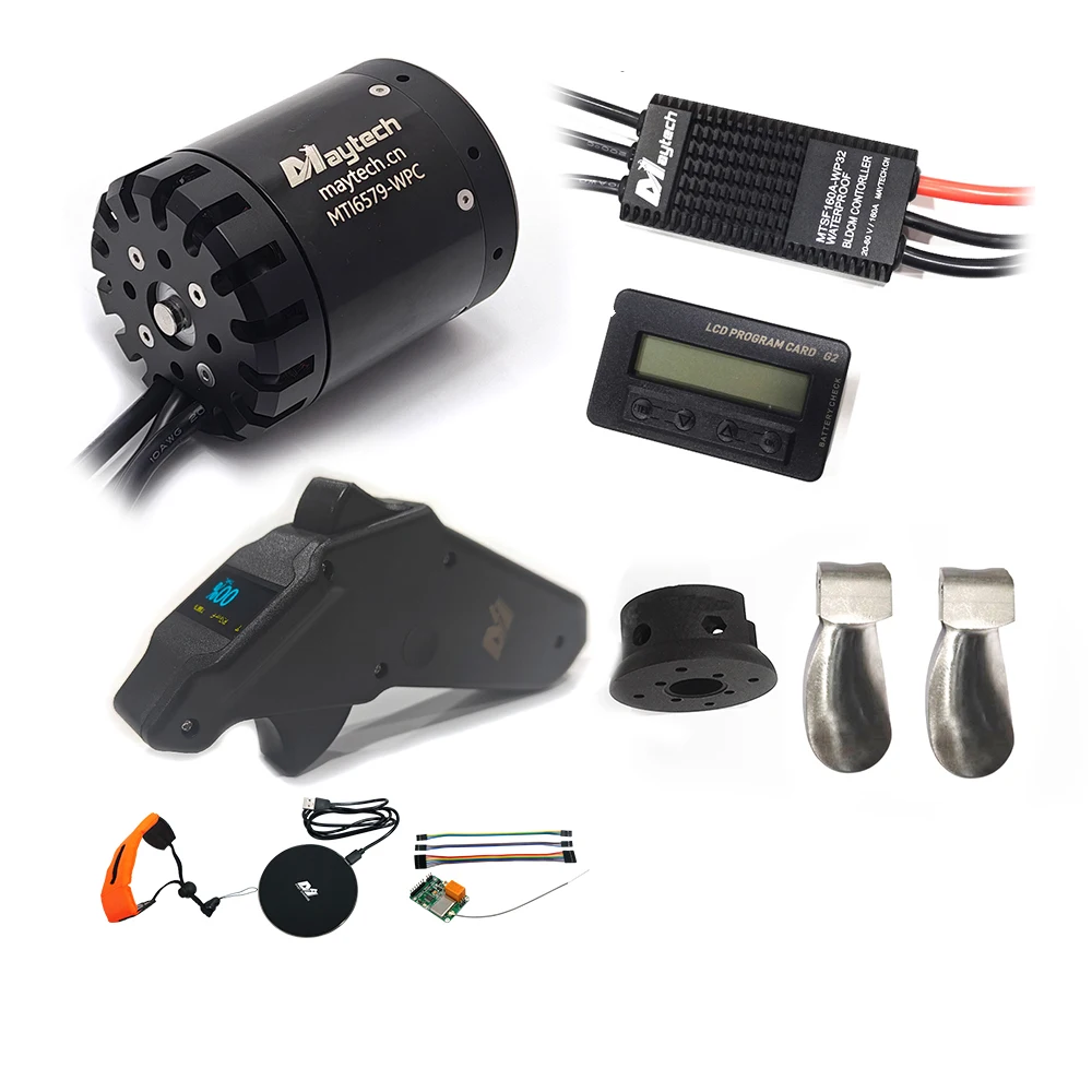

Get the same kit as Clinon Yap use:
On Maytech web:
On Alibaba:
