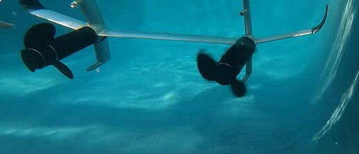

Early Pelagion prototype: two motors pushing a single UHAR foil
2024 setup: two independant small (400 to 500sqcm ?) front wings each topped by a pulling motor
