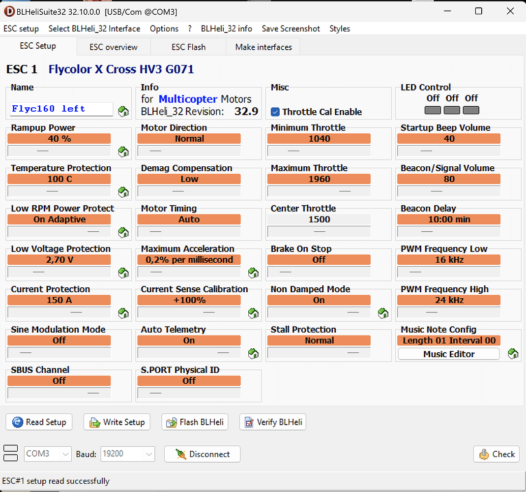

My current suspicion is “Low RPM Power Protect”. Since we demand very high torque at very low RPM, I’m wondering whether disabling this feature might solve the problem.
Has anyone tried running “Low RPM Power Protect = OFF”? Any ideas or experience would be greatly appreciated.

I would point the rampup power. Try to lower it maybe to 30%. It will probably give a softer throttle reactivity.
Maybe it’s too high and the Esc gives too much current at startup which reaches the 150amp current protection.
Did you you have any experience with Low RPM off?
What about the Sequre firmware? any difference?

From what I understand Low Rpm plays a role between 0 and 1% and the rampup power takes over for the rest.

Did a intens config session yesterday to find out what causes the cutoff at 50% throttle while stand up in demanding conditions (wind and waves) and small setup (Flycolor (old firmware), 6384, 12s3p, 85kg, 40L, 900m2 Foil) :
Low RPM Protect off: no effect
Lower Ramp Up: no effect
Timing to 12-18: very bad
Demag off: worse
Raise current protection to 200A: slightly better
Accelartion 0,2%: best feeling but still cutoffs
What´s frustating, that the Flycolor with the config above does an excellent job for years in the past. Don’t know why we have these cutoff problems now.

no everything was fresh soldered, new cables etc. Was hoping although. Anway last hope is PWM high and low. What are your experience with a 6384 120KV (small board, small foil, heavy rider!)
