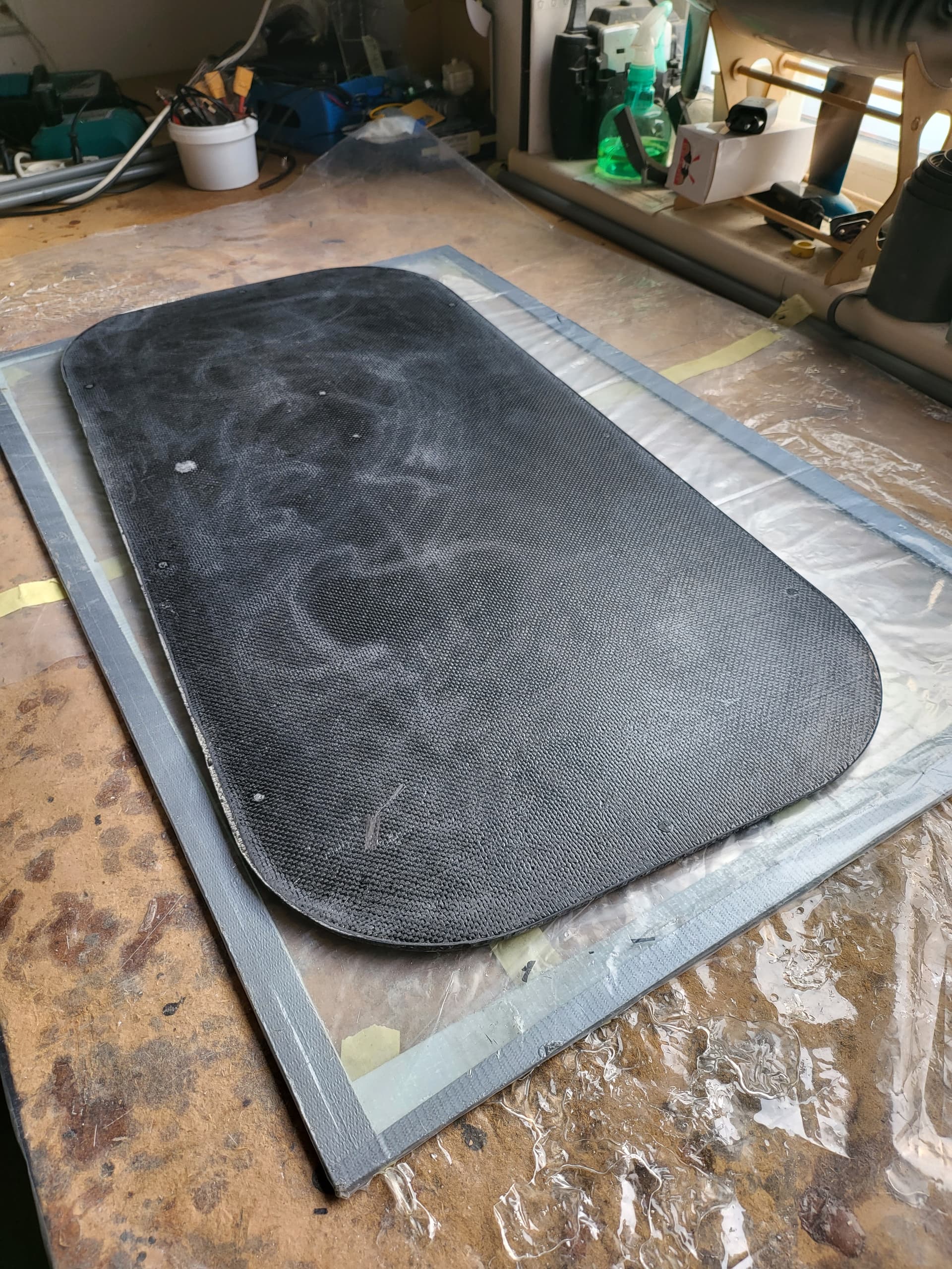

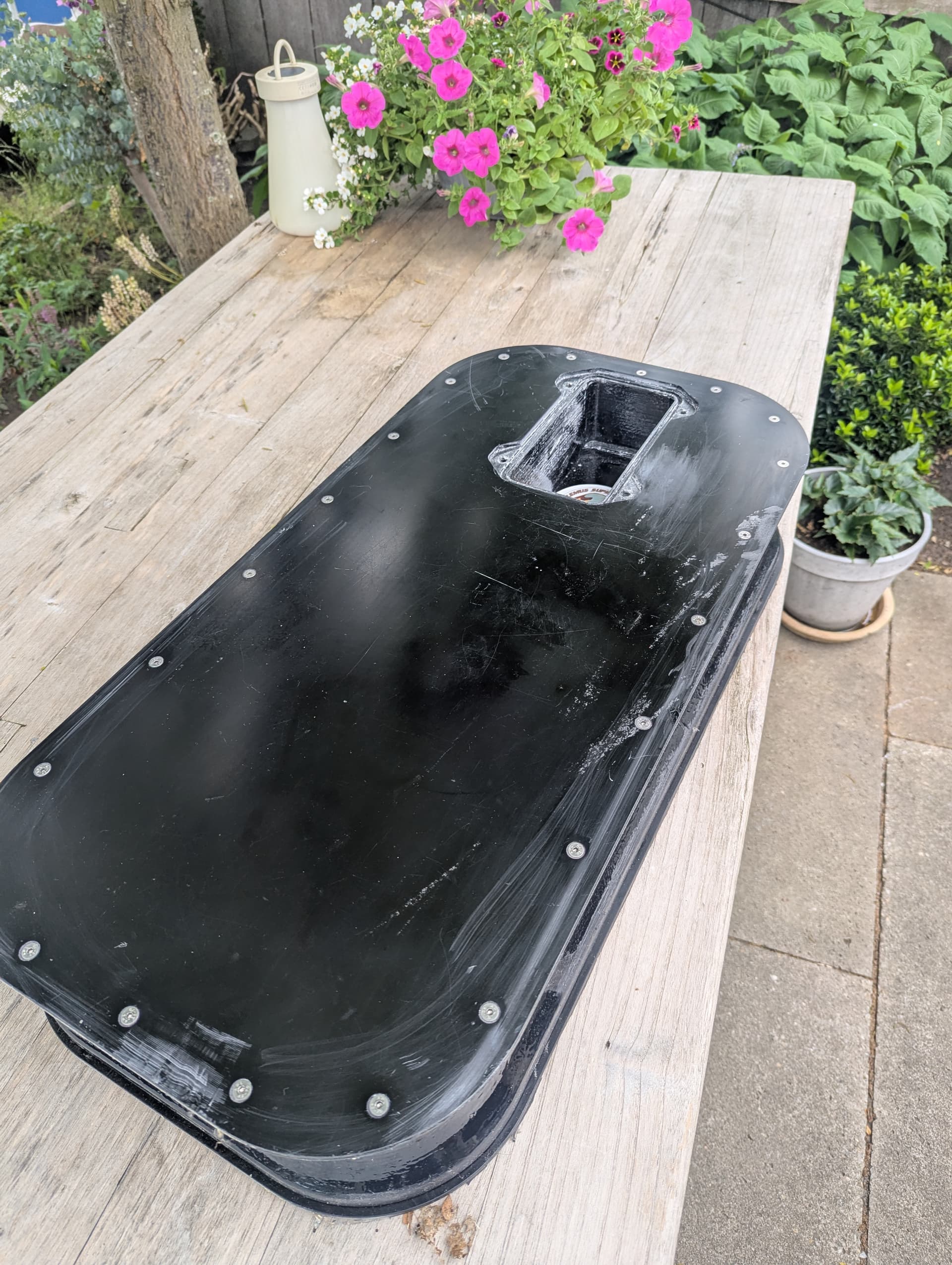

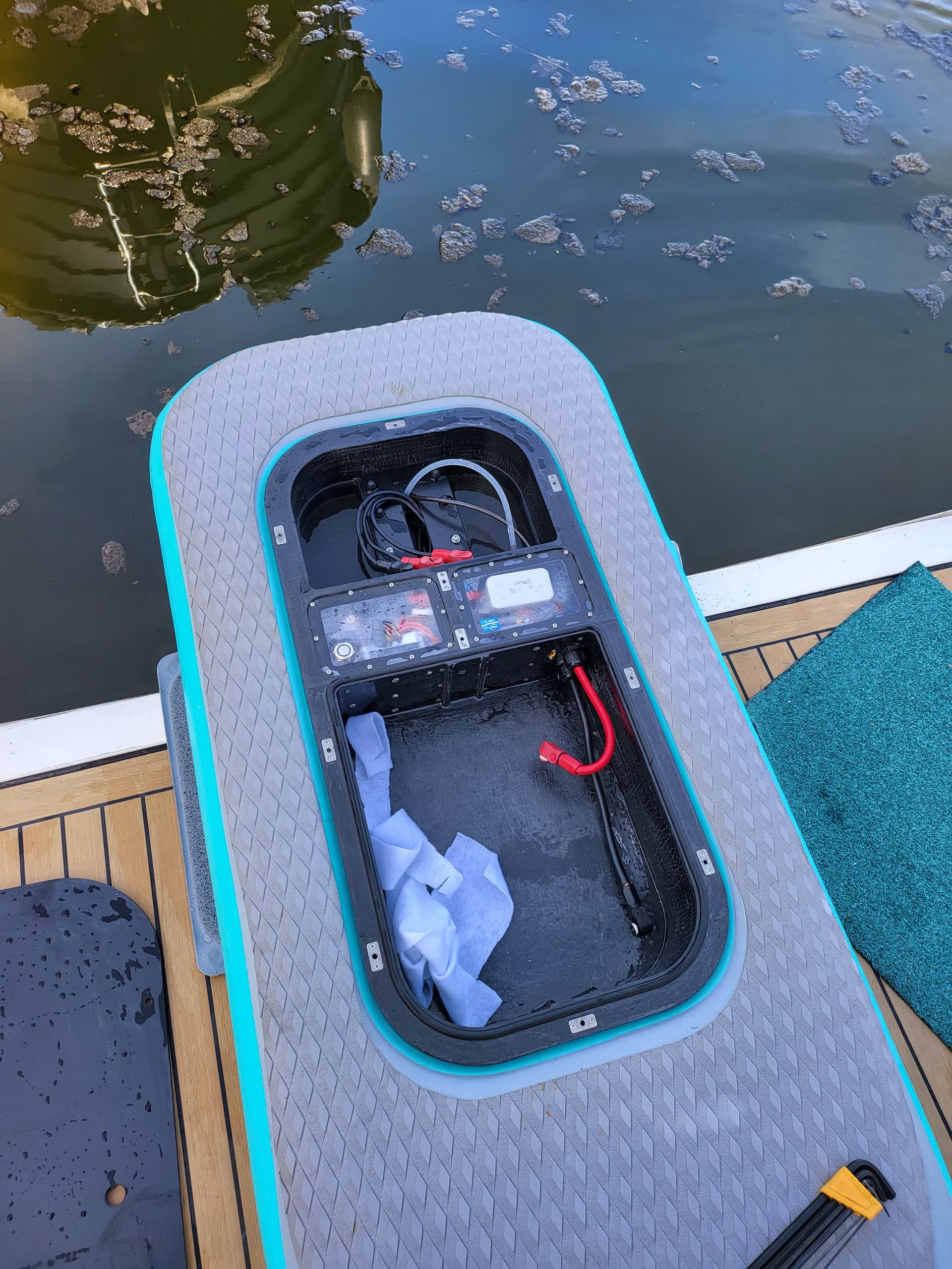

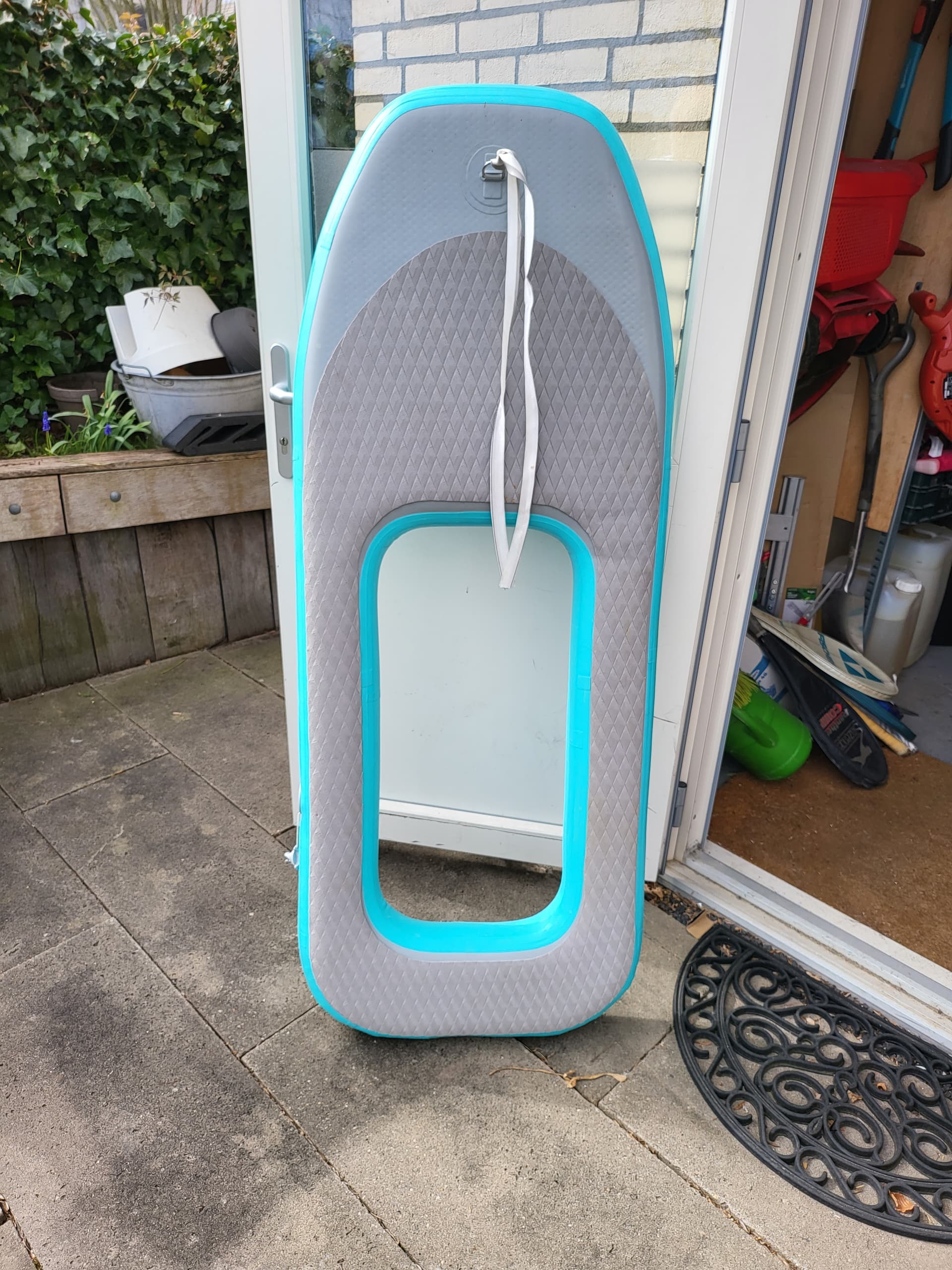

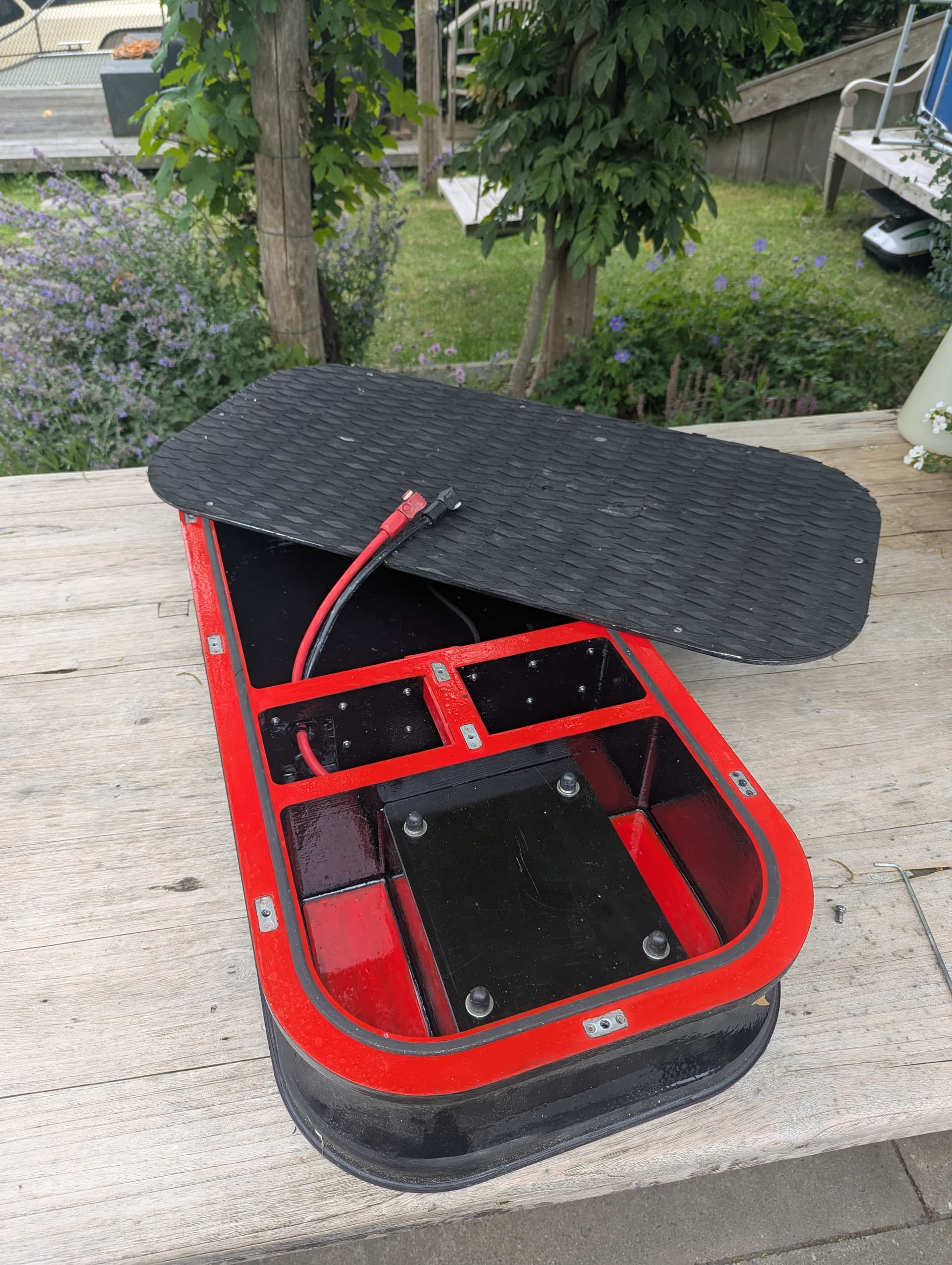

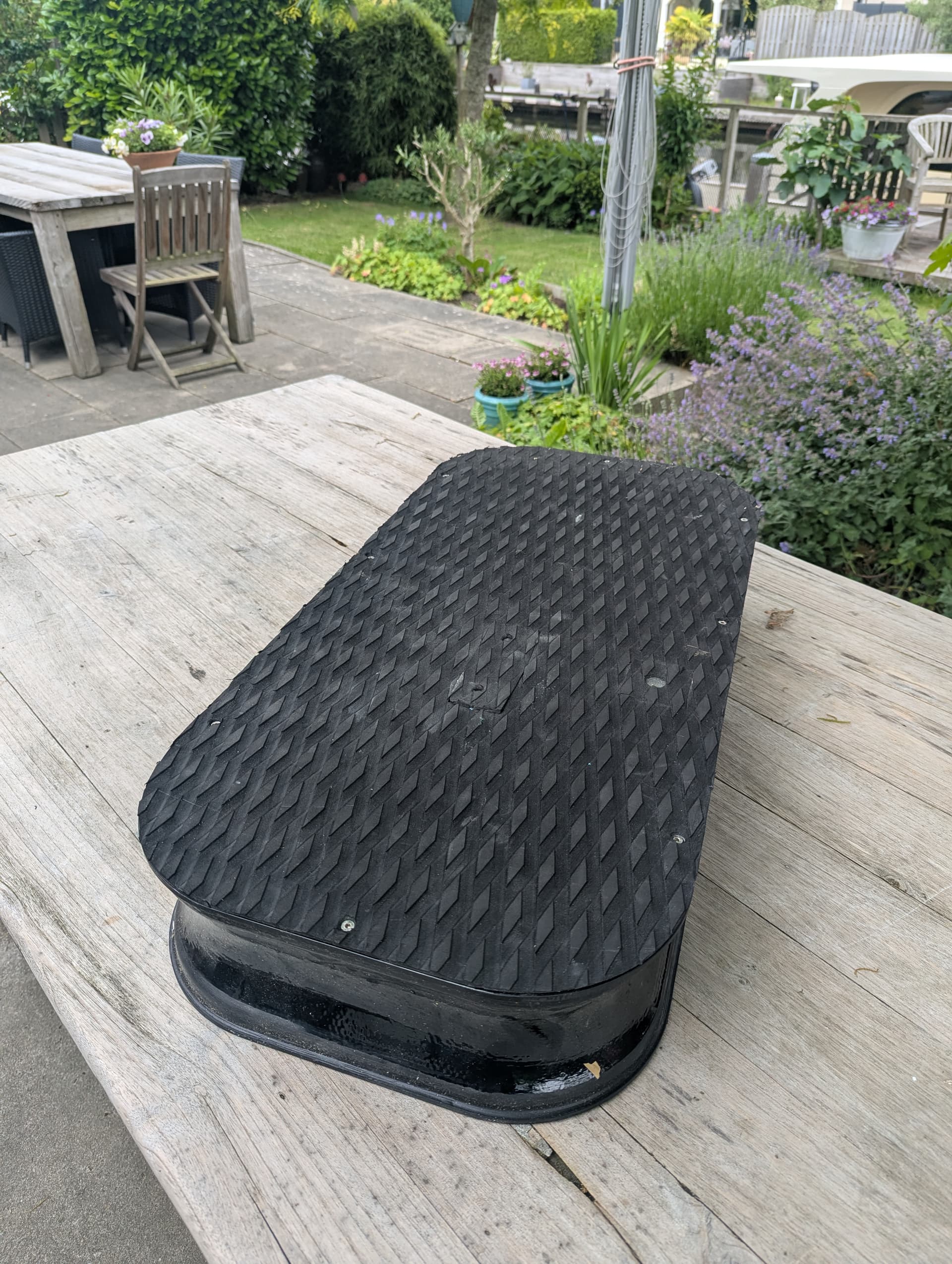

I also built my first board based on an Inflatable, my children still use it.I got it from Alibaba, I rhink it was an easyfoil prototypy, at least it looks like the awrly easyfoil boards, the opening for the boxnos just a bit durther to the front. If you build the top plate big enough that you can stand on it, it works quite well. Also depends on your foil shape/size and angle difference between front and back wing.
One thing that is harder with an inflatable is touch down at speed. They tend to stick to the water surface when you touch down too hard at speed.
