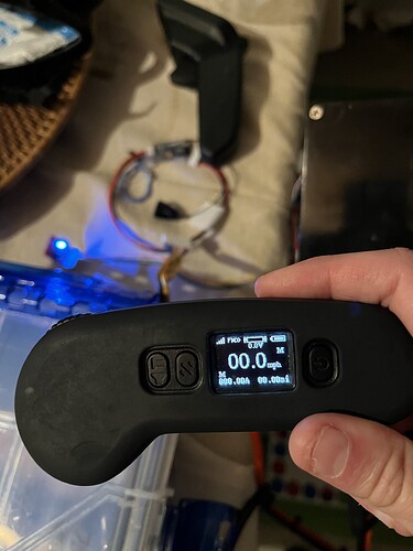

Here’s a photo of what I’m seeing from the remote. The vesc powers on, but battery voltage is zero, it throws a warning occasionally if I wait long enough. Uart connection seems to work. Bluetooth is working, but I cannot actually connect to it
Did the little receiver get wet? Did you figure out where the water got in? hatch or mastseal? If its hatch you can adjust the tightness of the latch a turn and test.
I think it came through the hatch, there was no water pooled inside around the mast connection. This really bugs me, I don’t know what went wrong. The latches seem to be grabbing and pulling tight, and when I pull it open I can feel the resistance of the whole seal gripping
I don’t think the receiver got wet, it’s attached inside the lid of the vesc box, which appeared totally dry. I will test it once I get a new VESC, or maybe open up my 2Swift board and try plugging into that vesc if it’s accessible enough.

Well I extracted the receiver from the efoil and opened up my scooter board. It’s running a spintend vesc, I think in UART mode. Pulled out its receiver and tried the flipsky receiver. Remote connects to it, but I’m seeing the same thing. It does see the board’s battery voltage and temperature but there’s no throttle response at all. A bit inconclusive.
I tried the scooter board’s receiver and remote on the eFoil. Powers on and connects, initially shows full voltage then quickly drops to zero. So right now I’m still thinking the vesc is the issue.
Ya that doesn’t sound like much and it didn’t hit the vesc or receiver. Weird problem.
