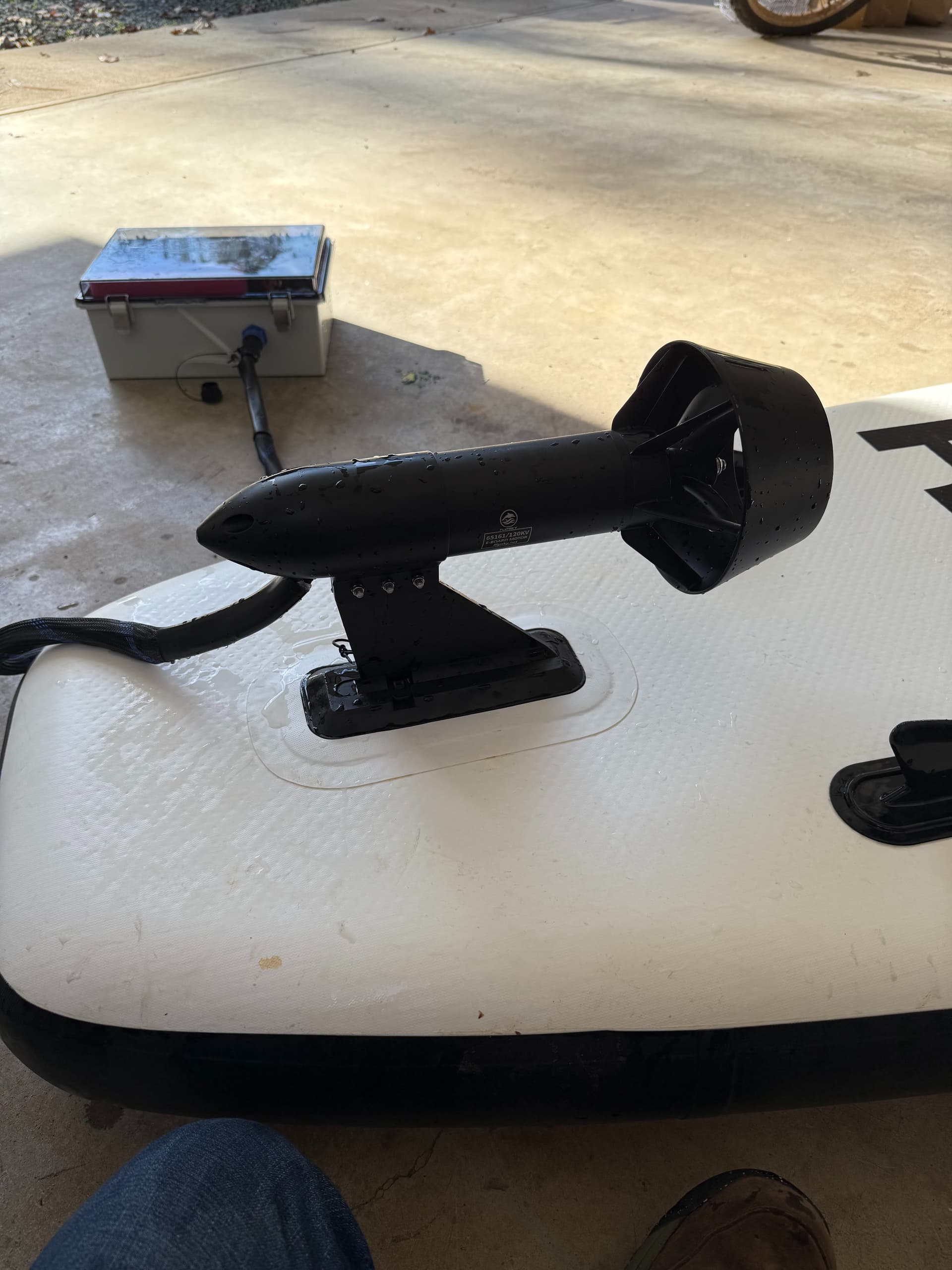

My problem is that when I attach the motor to my finbox, it’s backwards. Either that, or I’m confused. The prop goes in the back, right?
I attached it backwards for now. Pictured below.
If I put it on the other way, the pin doesn’t slot in.

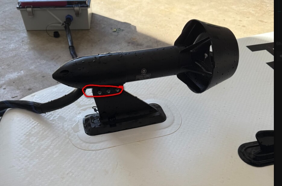

Should I unscrew those bolts, and flip it?
Definitely, also look at the shape, the 45 degrees angeles part should point to the front (as it is on the picture).

I just slid the flipsky motor into the existing finbox, backwards.
I’m going to assume that Flipsky incorrectly put the pin in the wrong location. So I’ll remove the bolts, and flip the motor around.
cant you just open these 3 screws and turn it 180 degrees?
Yes, I’ll do that. Those screws are what I meant when I said bolts.
