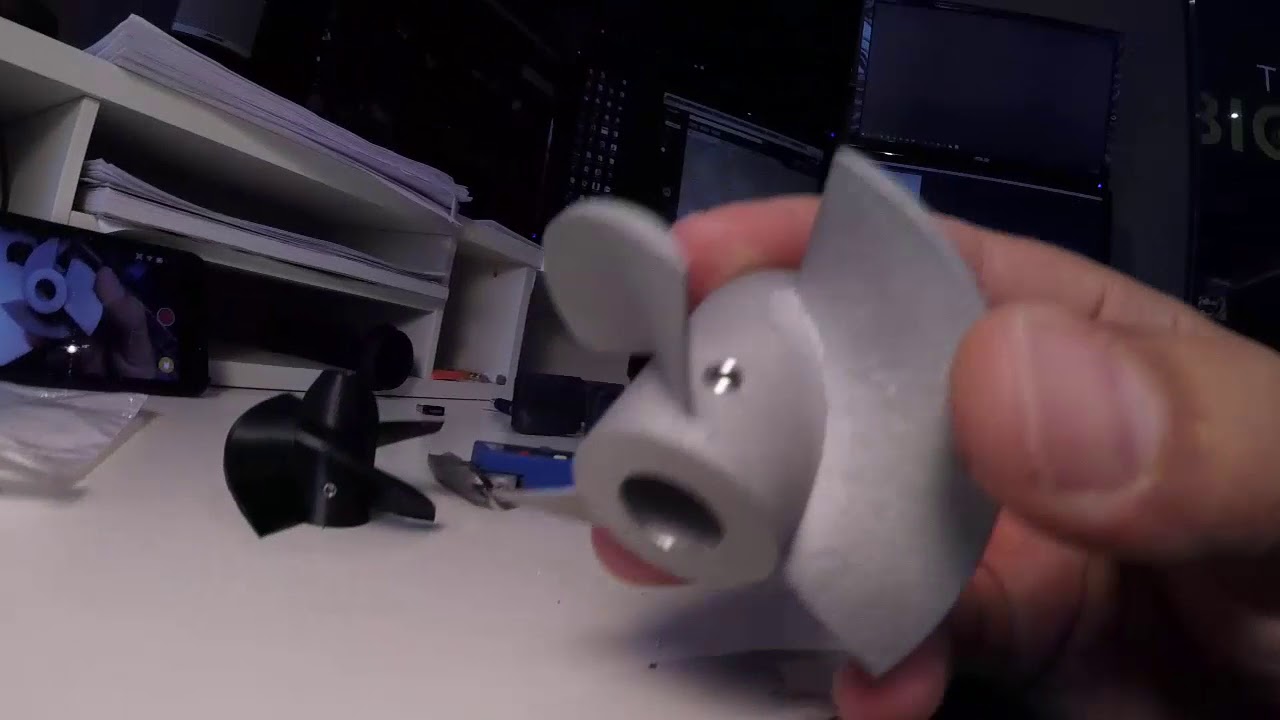

I just posted video on how to get a custom aluminum impeller etc… and water intake cone @DavidC
WATCH VIDEO BELOW
3D printing company for aluminum Props and Impellers: Online 3D Printing Service | i.materialise
