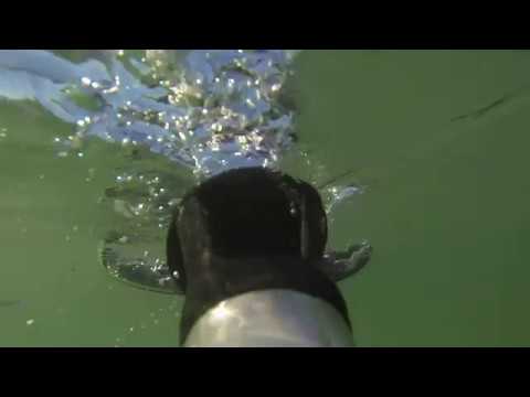

my last video Youtube, my position is better and I start to control the roll axis, very difficult to me that axis.
What motor and prop size are you running on this setup?
56mm prop, leopard, sss motor and tp power, runs well with all

Is this setup is the same prop, stator and nozzle as V1 ?
The flow looks amazing, can you share your CAD or some more information about this setup?

Yes, it’s the same prototype, prop, stator and nozzle v1, my first version, I was sure this part had to work. Sharing information about how its made is not a problem. If you follow me, you can see all the information on my Youtube channel. I do not like to give my designs, I like to see people can make their own designs but if you send a pm I can give you a little more details from my design. This propeller will only work in metal or carbon fiber, the blade is very thin. Thanks

So this is direct drive now, as in no gearbox?
yes direct drive, no gearbox, no problems!
