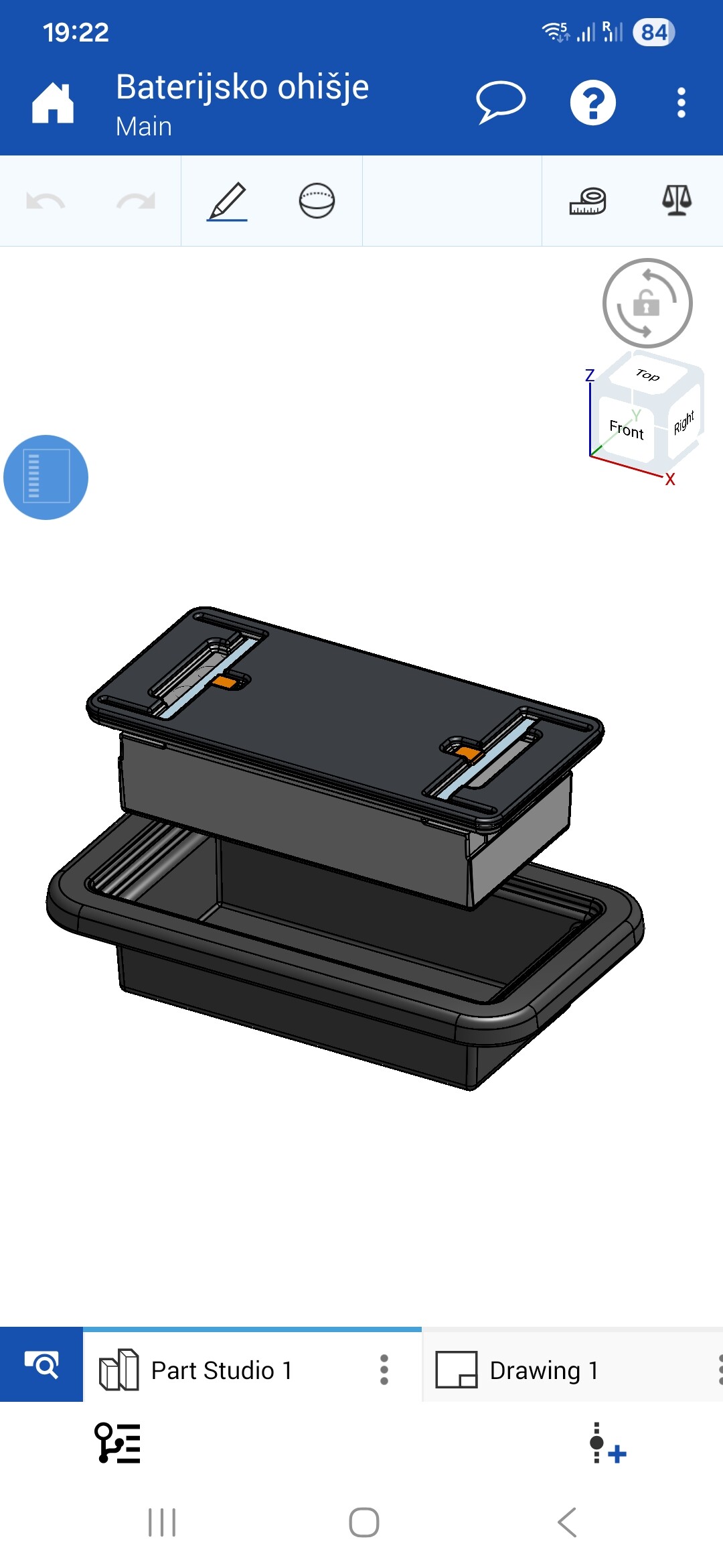

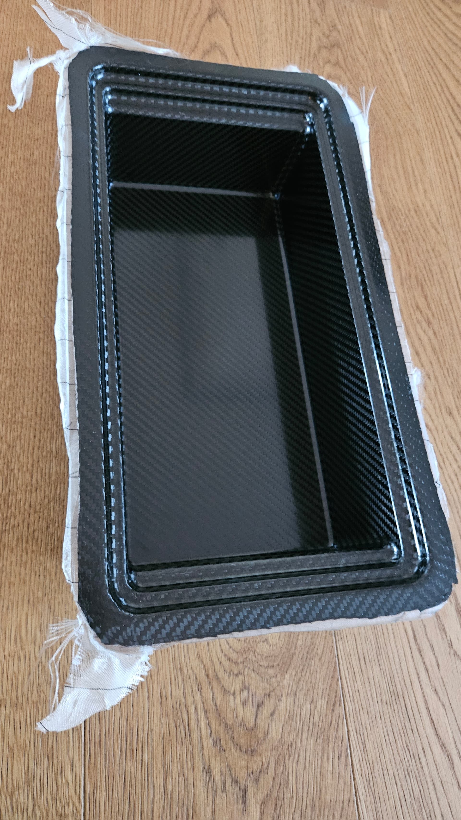

See if this concept works for you. A separate pod made of prepreg carbon to insert in the board, where the battery case is inserted.

Looks like a piece of art.
Wish I could justify doing it that way.
