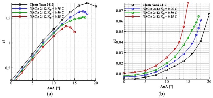

If you are a tinkerer, it should be possible to adapt a 3D printed TPU leading edge cover to a 1900cm thin front wing like a Gong Fluid or Curve and thicken the rest of the wing to be flush with the leading edge. Just an idea.
It has been studied/demonstrated that a step on a wing surface decreases lift and increases drag: Aerospace | Free Full-Text | Effect of the Backward-Facing Step Location on the Aerodynamics of a Morphing Wing
