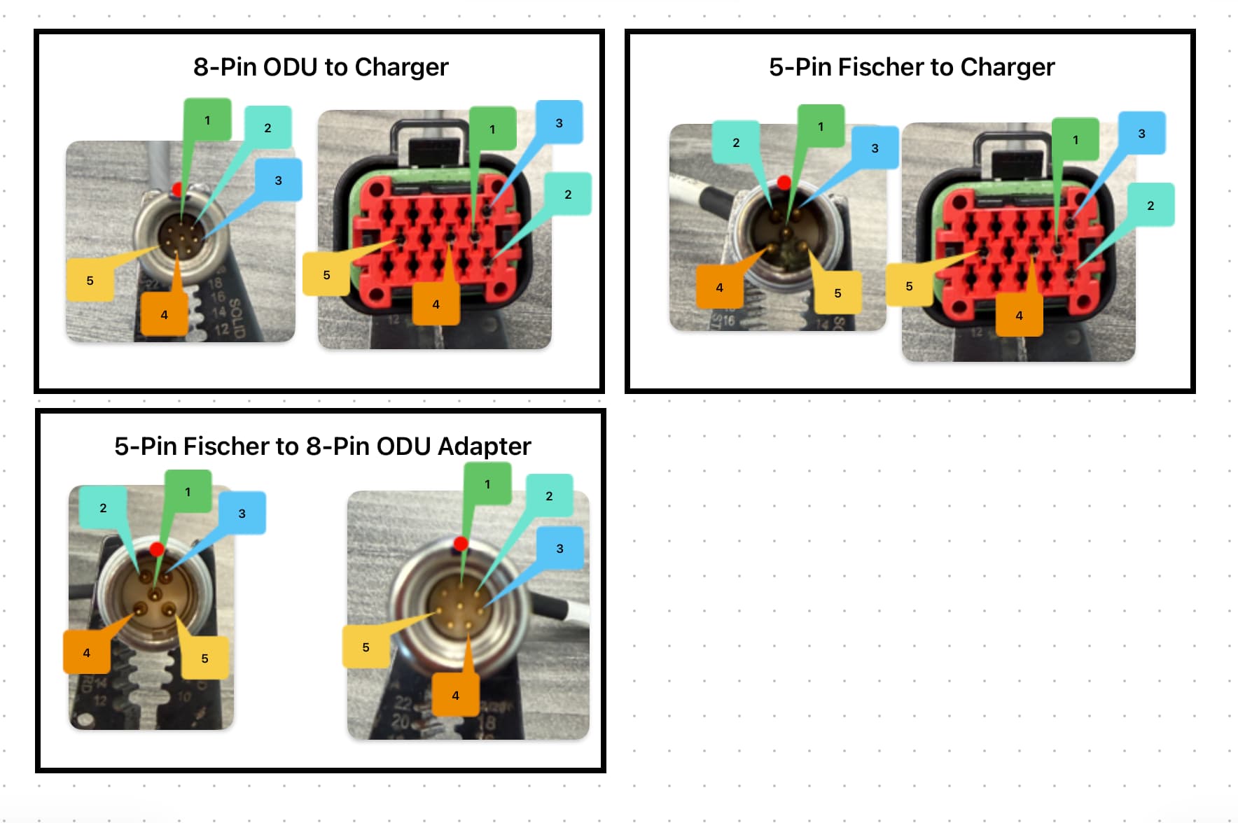

I would like to test some defective Lift Gen 4 batteries. Can anyone tell me the pin assignment for the Fischer charging cable (5-pin)?

Does anyone have the pin assignment for me?
Can you not find the charger pin assignment and then use a multimeter to do a continuity test which would allow you to map the pins.
Unfortunately not.
I only have charging cable ODU (8Pin)
Can you not find a conversion cable or borrow one?
It seems that you need the original Lift charger. because this 5 pin is only the communications port. Or you can change the bms inside.Second option would be to find this charger on ali Express. Which exact type of Fischer charger do you have?
Unfortunately not. I thought I would find someone here in the forum who could measure his cable. Which is pin 4 of the data port?

Here are the data cable pin correlations I was able to test… I know I’m a little late.
