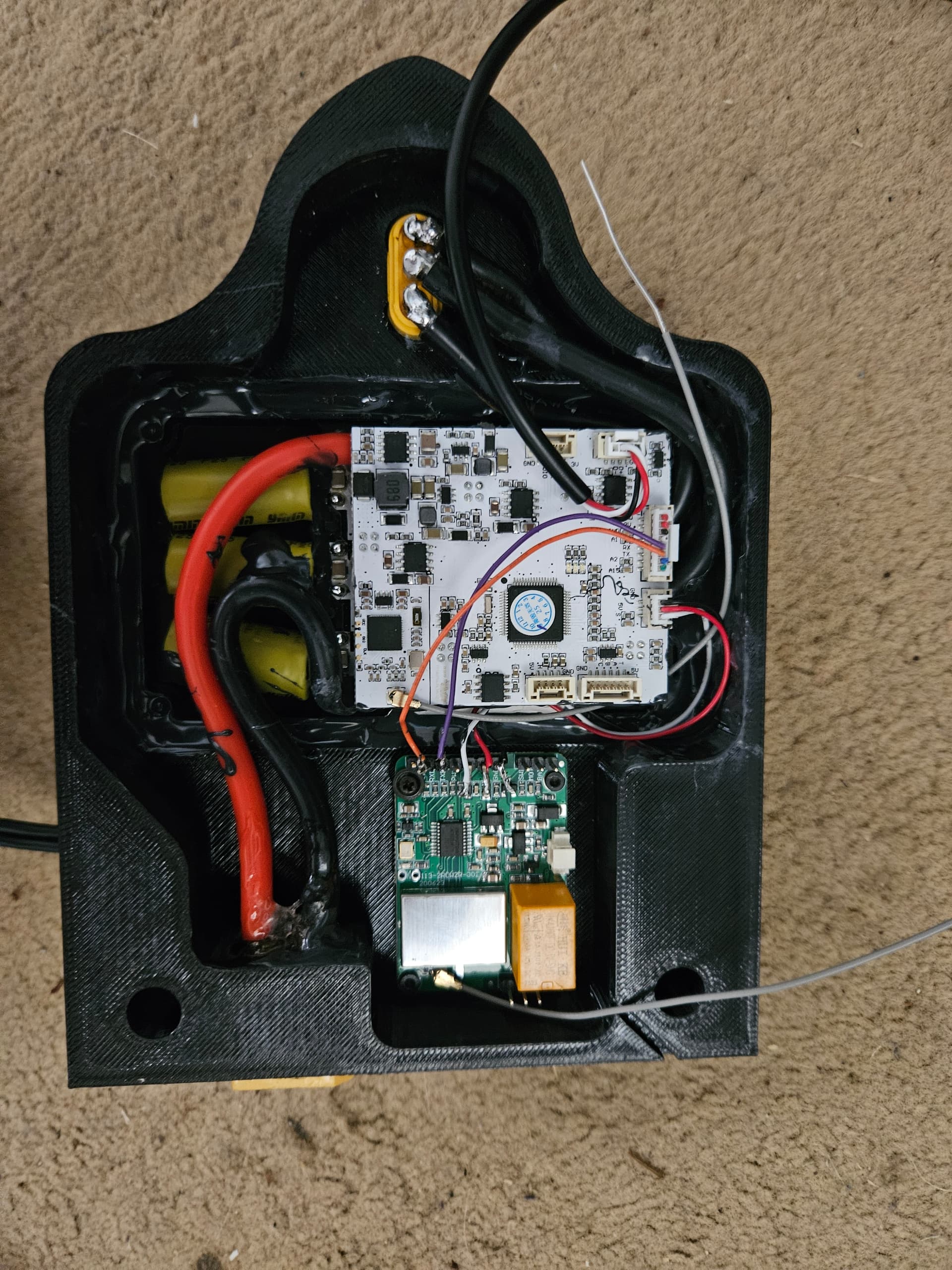

I have built the main unit using flysky 74100 vesc and maytech receiver, does anyone know if the standard maytech antenna which is about 200mm does the job ok or should I get an extended antenna? standard foildrive gen 2 works fine with the board I intend to use, thanks in advance
pic for reference
also does aliexpress have the latches that you use o hold the battery in place?
What unit is that? I dont recognize the design.
Latches I got of Amazon, but they do not last good in salt water
Designed mine around those Amazon latches too but unfortunately they don’t actually seem to be stainless steel :frowning: No turning back now.
