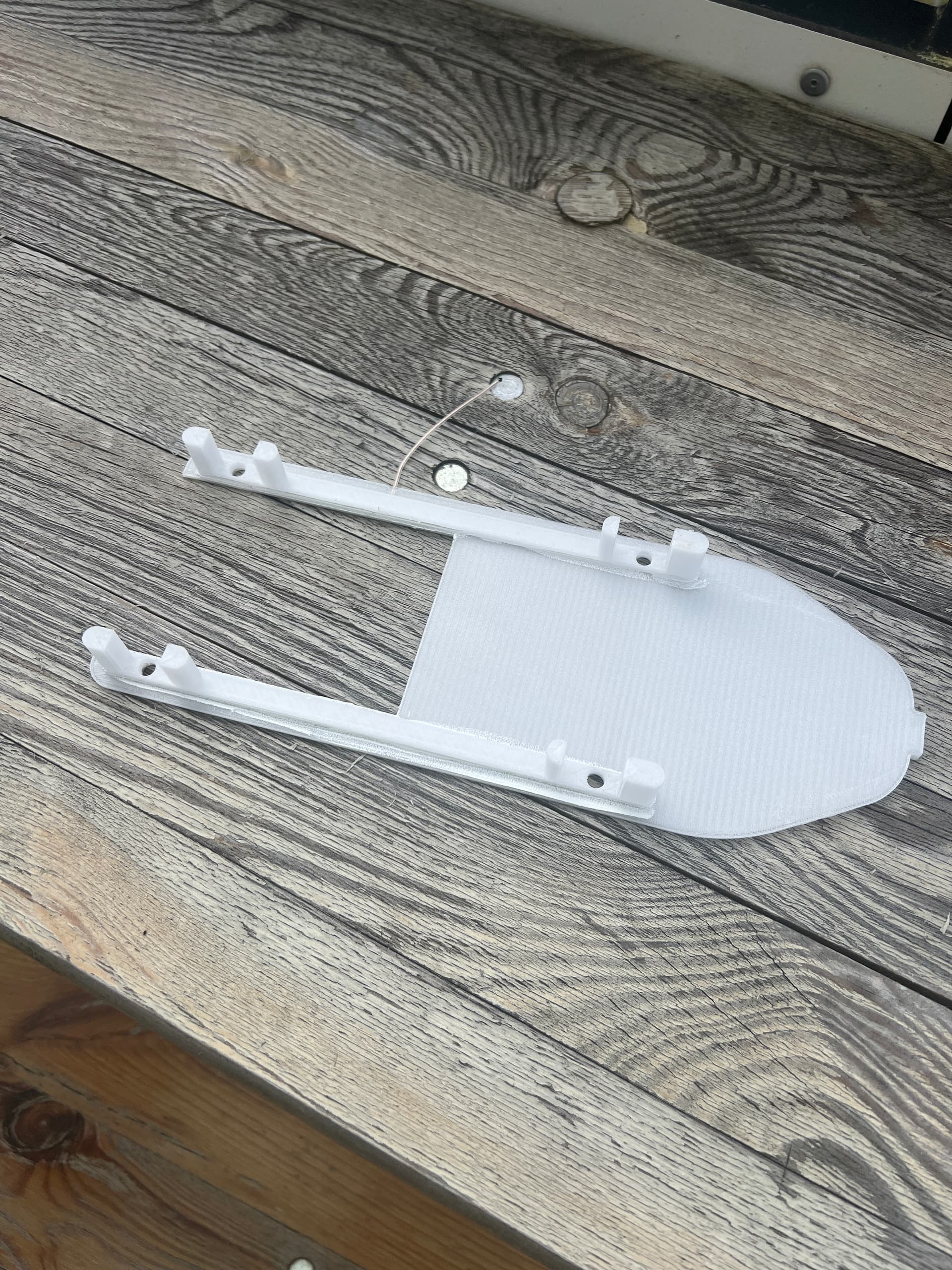

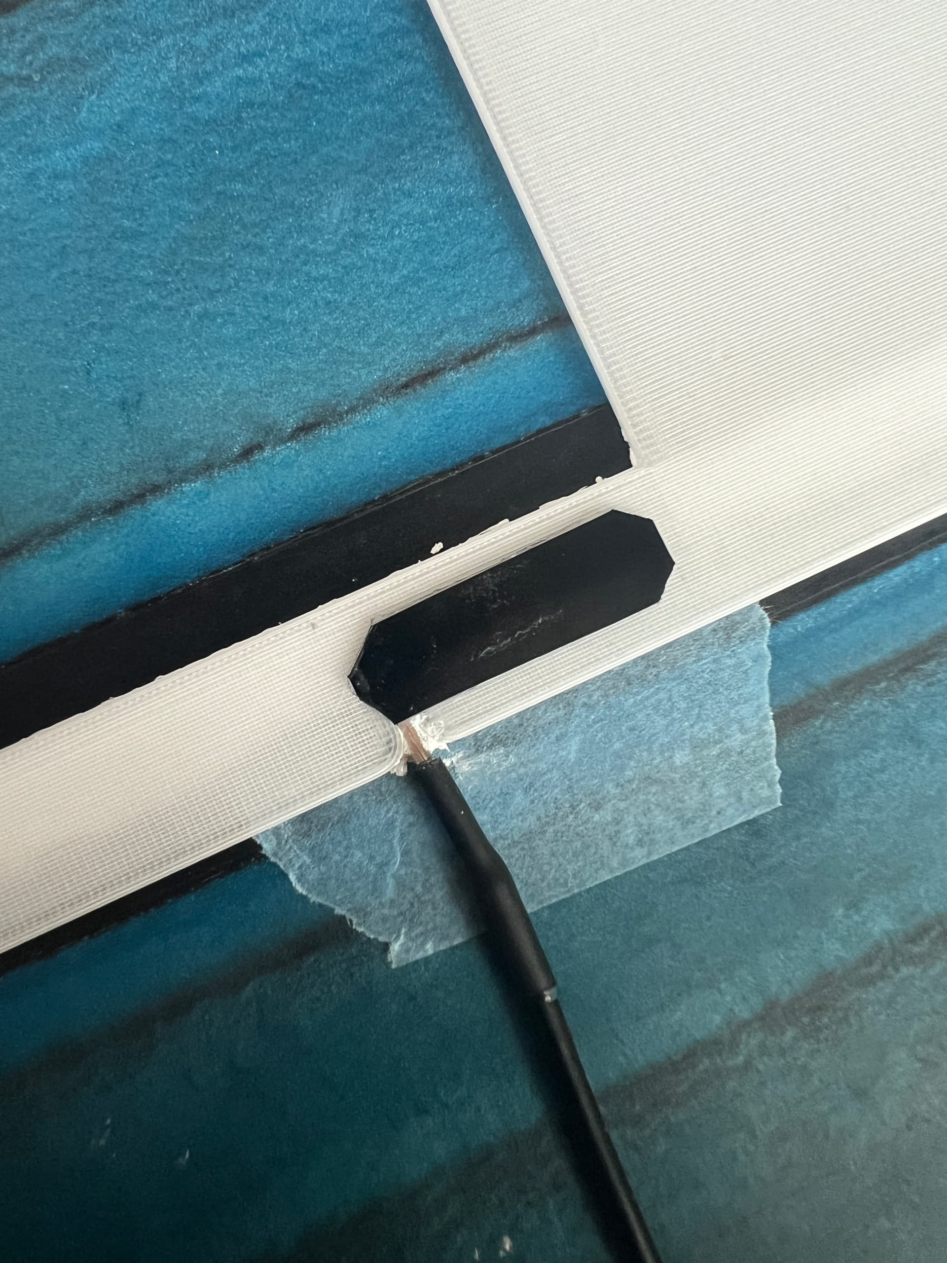

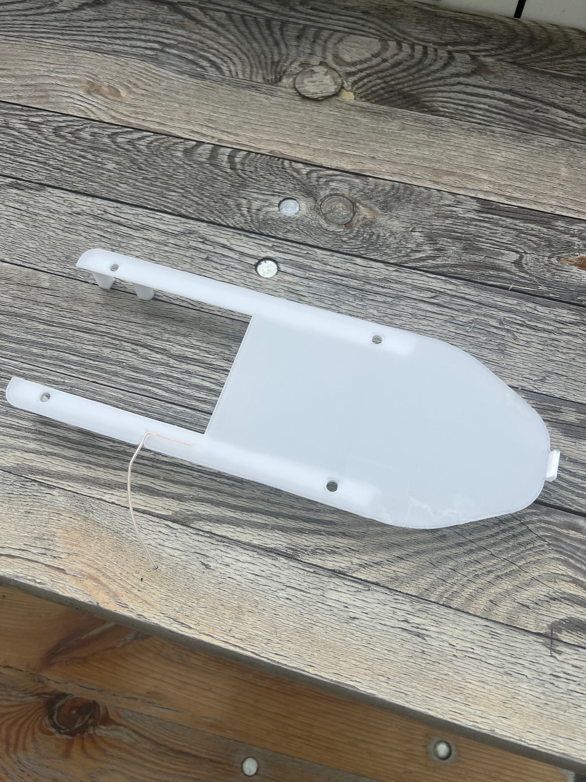

Got the reception fixed. External and internal antenna are about 2 - 3 mm apart. The controller keeps connection even under water and up to about 5 cm distance. Above the water surface the reception is perfect up to a few meters away while the foil assist is under water.
Here some images of the updated reception plate. It now also holds the nuts in place and stays on the board.

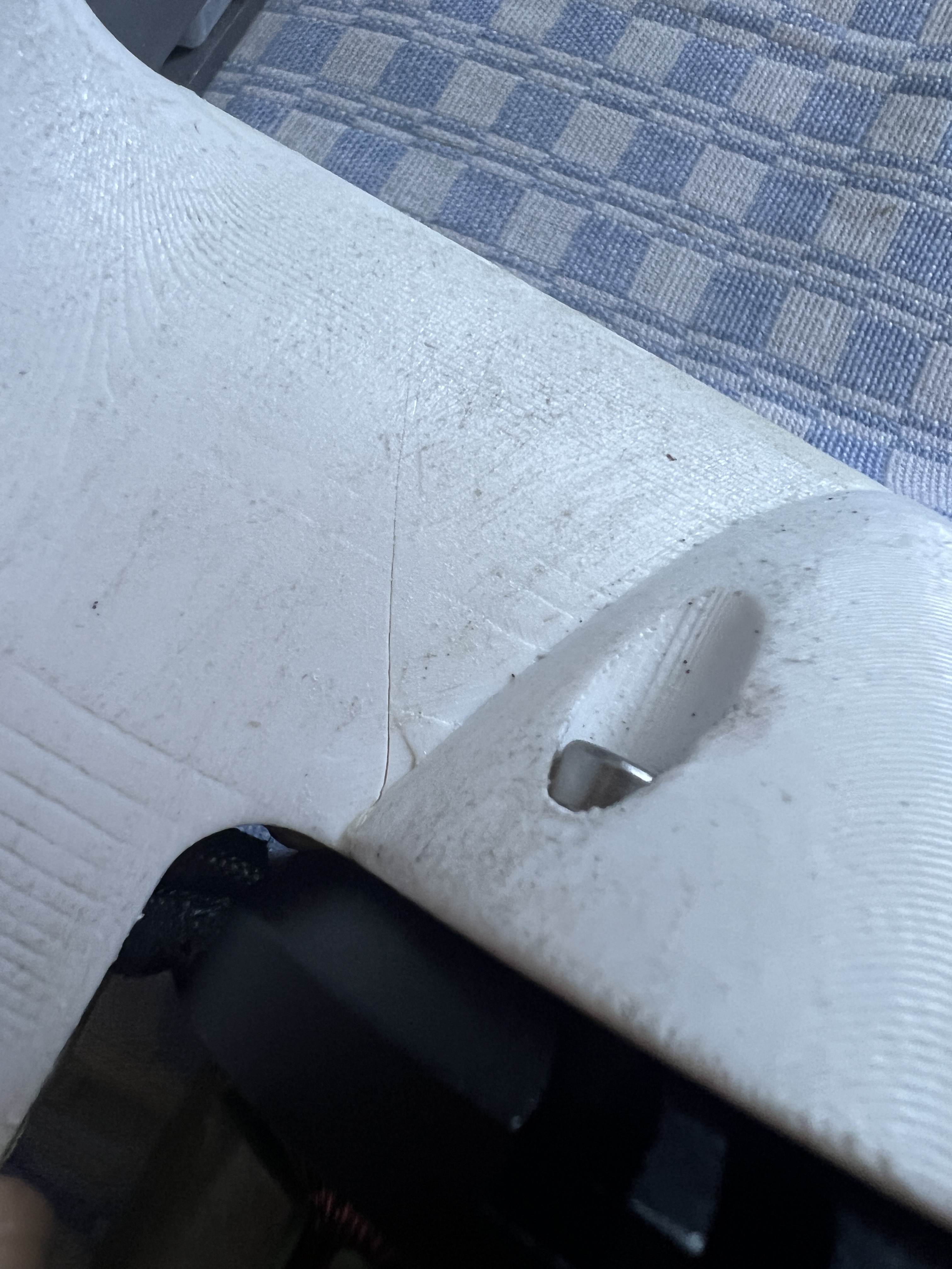

After this session I have noticed that the pod cracked, but only on one side/half (it is a two part design). I have already printed a new one with a radius along the edge where the crack started. Also it is printed with 100% infill this time. If it breaks again I will consider printing it in PA12.

My experience with petg in water is not great, a lot of cracking… Go Ppa-cf or sls pa12

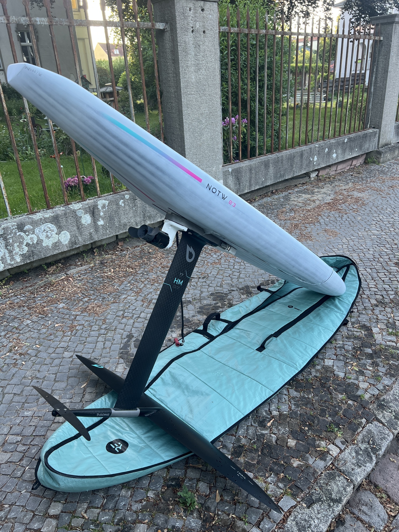

I have a setup quite close to yours, standard FD prop and gong Trail L (with 77 alu mast). My board is much smaller (38l, 124cm long), therefore I strugeled to get on the board in my first sessions. I need to put a grip pad on may board to get better grip as well. How ist the trail with your dw board? It feels quite slow compared to my eFoil. I guess I have to try a bigger board as well. Or keep practicing, I can ride
it on my knees and I was close to get on my feet.

Definitely try a much bigger board for the beginning. Something in the range board volume >= body weight. I am 75kg (without gear) and the downwind board has 120 L.

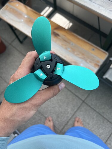

Yes, I will report about the prop. Unfortunately I can compare to that Propellerking 2 fold only.

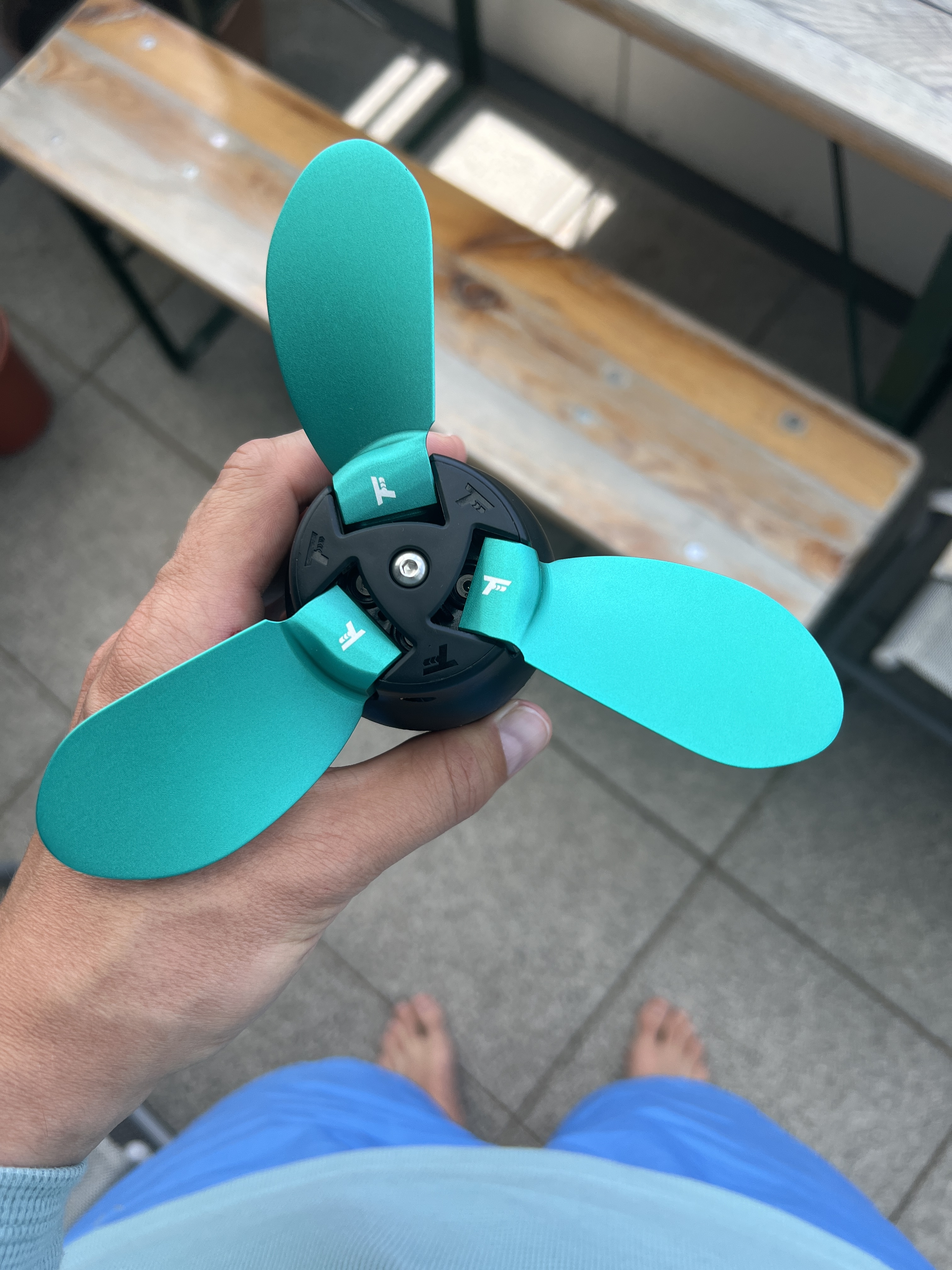

I had my first session with the FD LR6 Prop. I was on my dw board setup and just changed the prop, no other changes. Today I got 30+ starts out of this setup and I am not very efficient yet. I had about 3.55 V resting voltage on each cell at home (comparable to my previous session with the 2 Fold). Unfortunately I have no idea how many starts I got with the 2 Fold, but also many.
Compared to the Propellerking 2 Fold prop the FD 3 blade Prop has:
  • way less ventilation
  • more predictable thrust resulting in easier throttle control while surface piercing (probably due to less ventilation)
  • more thrust which becomes even more noticeable towards the end of the battery. It still lifted me easily onto foil with 50% to 75% throttle, while the 2 Fold lost a lot of thrust towards the end and I had to make little pumps to get planing even with 100% throttle.
  • longer battery life/usage because I can use less throttle and have more thrust towards the end
For clarification, I do not have experience with other 3 blade props yet. All in all I am very happy with my pick and I am curious how other 3 blade props would feel :smiley:

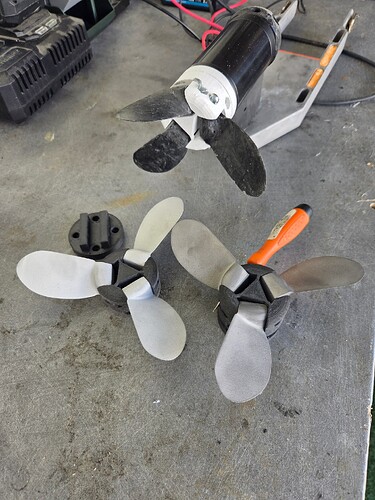

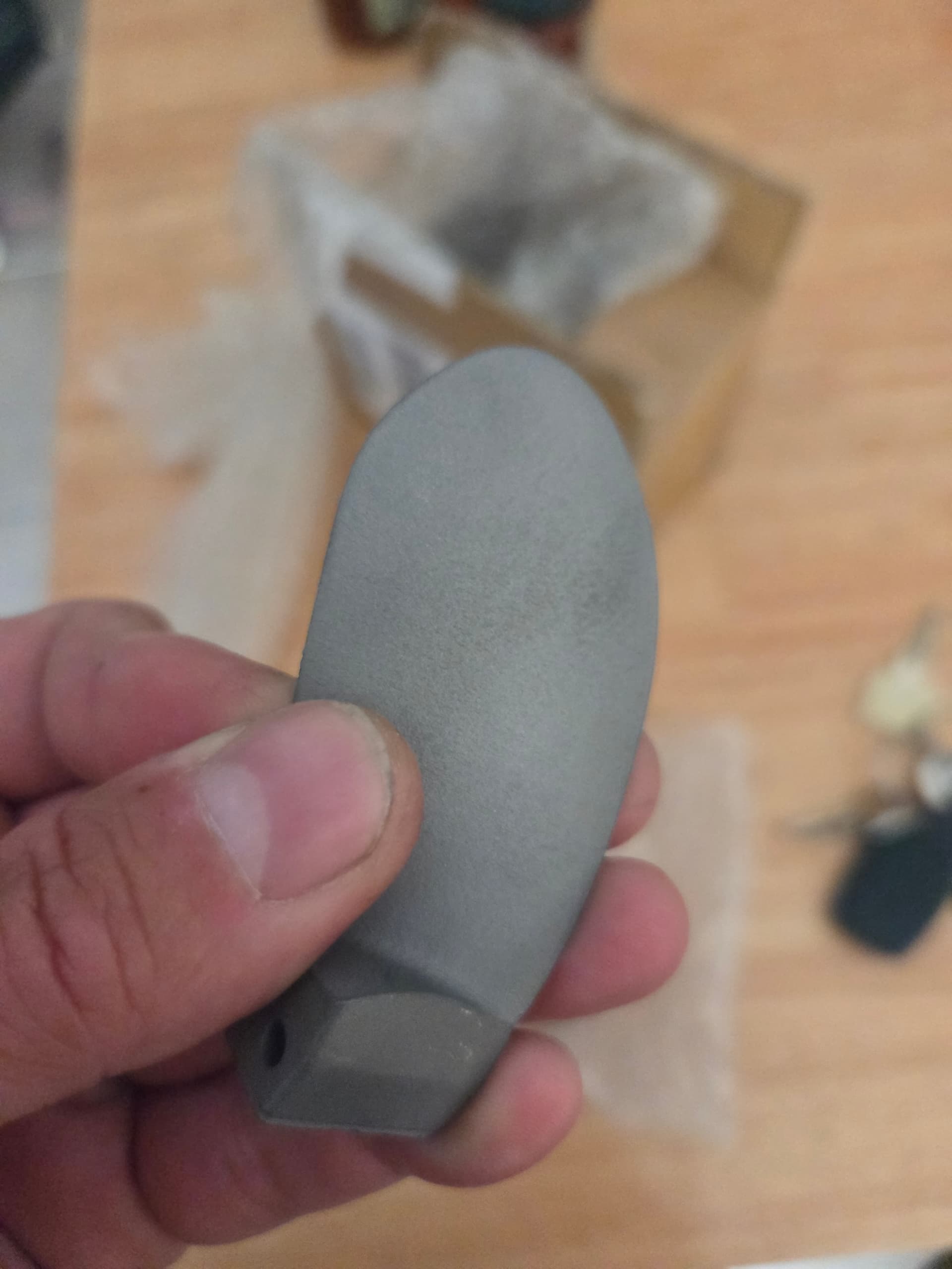

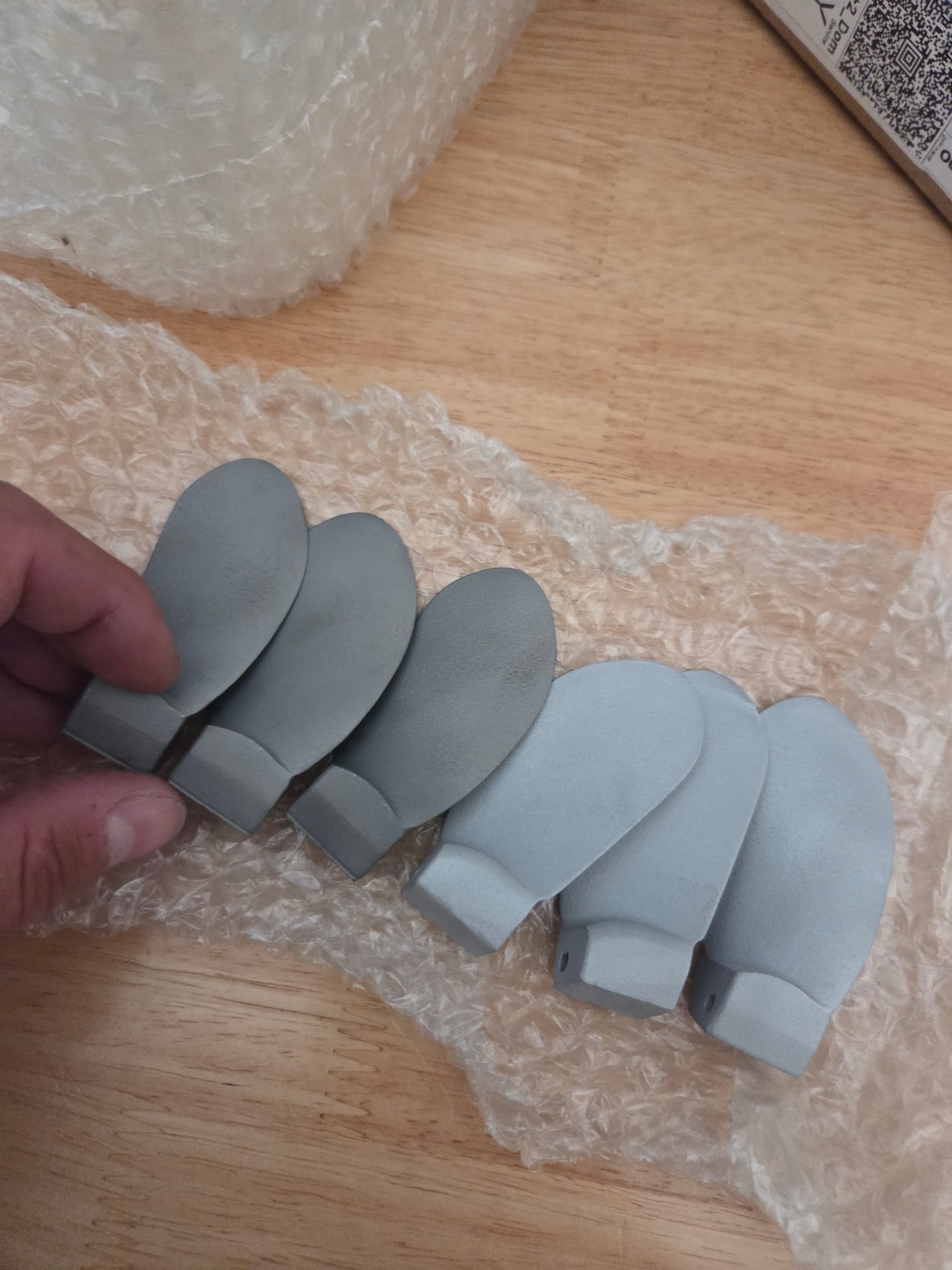

Received the ti blades, but won’t be able to test for a few days, missing the correct bolts and lent my maytech remote.
The ti blades looks like they will work without post processing, the edges are much sharper than the alu baldes.
Hubs in ppa-gf 100% infill, hope I dont loose blades!

Are these replicas of the foil drive props?
Yes, similar to FD props.

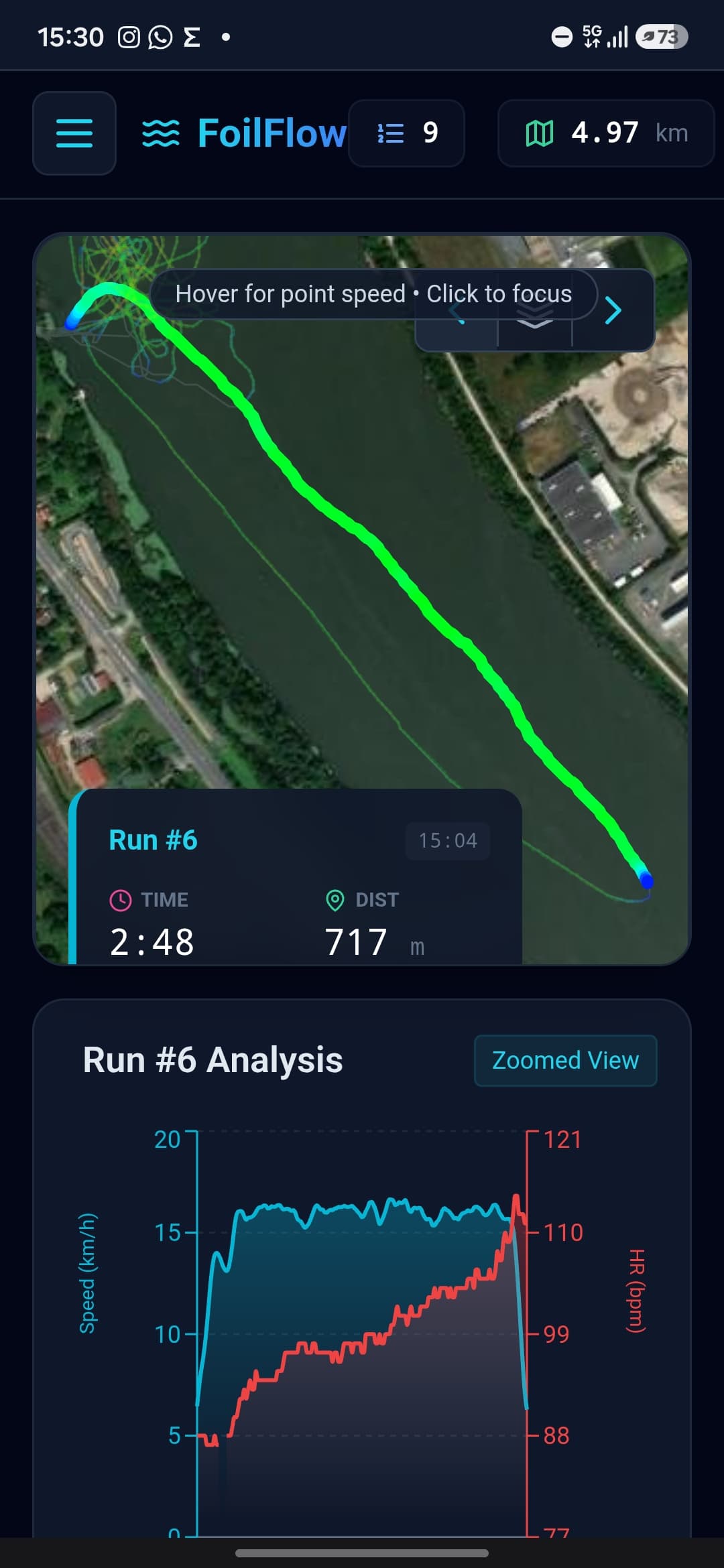

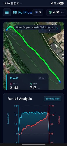

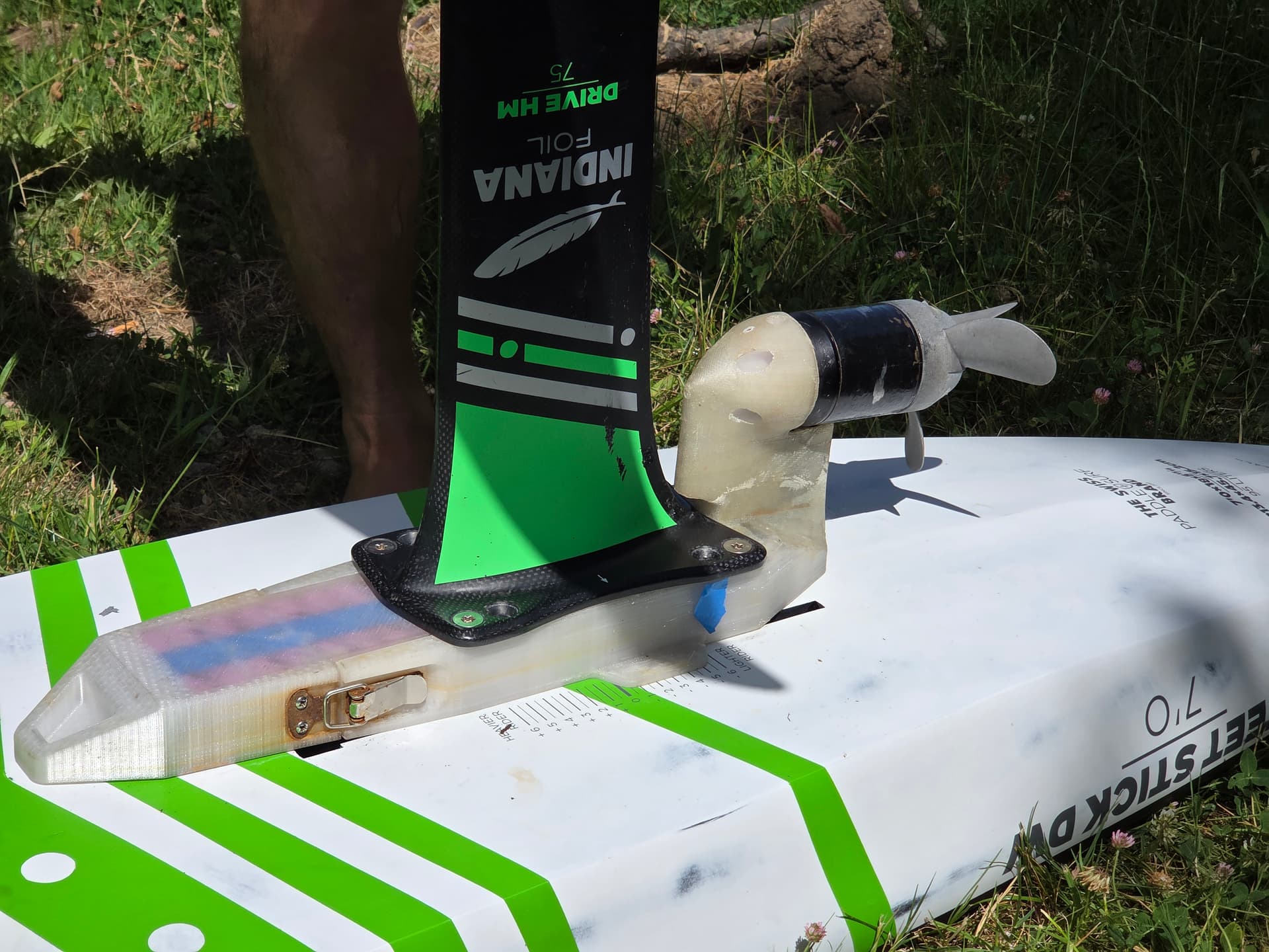

Today I could test the ti prop, and also compare the current V4 system to the v2/v3 system.
First the ti prop : works perfect out of the box with zero post processing of the blade, just sanded the sharp edges of the back of the blade root. With the 5085, the setup is very smooth and gets forgotten when you pump the board. I could pass my previous dw score despite zero bumps and just 15kt of tailwind + slow saone river current. Its probably all due to the ti bolts and ti blades :grimacing::tada:
Then because I still have only one pack for the v4 system, we switched to the v3 system with the 6385 and 12s2p packs. The v3 system has the higher pitch volker based prop, and I did not ride it in a while. Immediately, when pumping, I would feel the weight, and the heavier /thicker prop slapping around during pump.
Then after more riding the older system, I could feel two other things : rigidity seemed lower (maybe just bolts not tight enough) and during motoring, the prop has quite a lot of torque steer and drag during toutch down.
