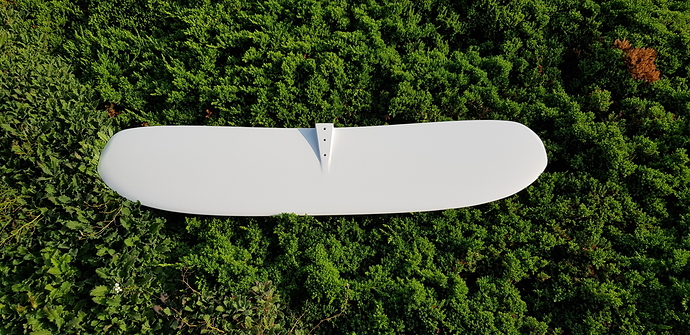

Since I was testing with my oun wigs:
I needed a lot of speed to lift the board:
Now planing to test with a Moses setup:

It’s also CNC milled?
Yes. Cnc out of plywood then fiberglass and paint.
