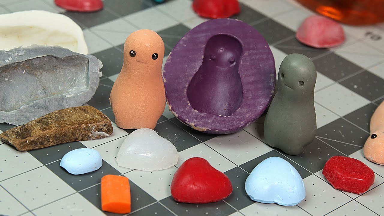

Food for thought:
Are there any Smooth-on Mold Star 30 alternatives ? Yes.
It should be possible to make this one piece seal plus an extruded one-piece electric hatch seal at 3:48 using the following method, a formula using silicone calking, corn starch and food colors: a treat for 8+yo children during this lock-down period…
