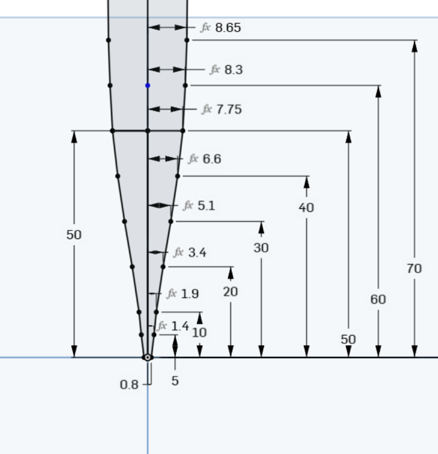

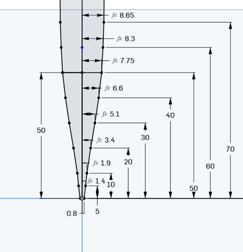

If you have a mast profile (doesnt have to be a spline, just thickness at 0mm 5mm 10mm and up to 70mm in 10mm increments) I can create you an STL. Also, there are different pod designs, single tpu strap, single zip, two zip ties, separate motor mount with dovetail into the cone, etc…
THX Volkv
its 11.60CM
on 1.4CM
2 or 3 zipties will be perfcet
Need something like this below:
