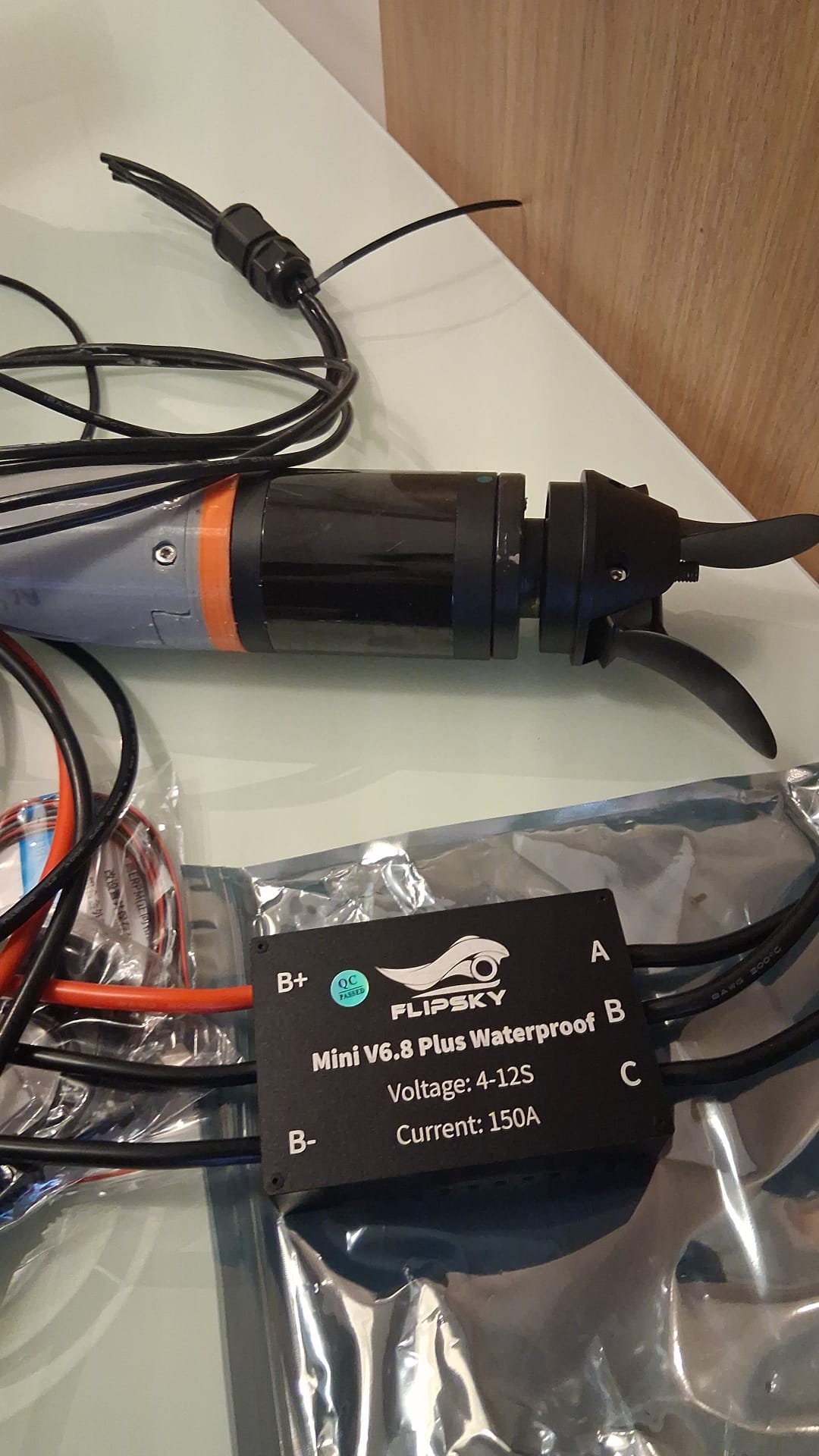

  • Mini FSESC6.8 Flipksy IP68 150A VESC;
  • 12S2P Salvaged 21700 from vapes or wathever, with a built in 12sDaly Active Balancer on the pack ;
  • Flipksy VX3 (with a female condom on it, as this remote’s waterproofness is just shite);
  • Flipksy Vesc Bluetooth module (useless, as this vesc was shipped with an old firmware, not compatible with it …and I’m just not keen to mess up with firmware updates and risk bricking the vesc);
  • Flipksy 65161 foldable propeler;
  • Flipsky 6384 waterproof motor;
  • Flipsky 60A anti spark switch*

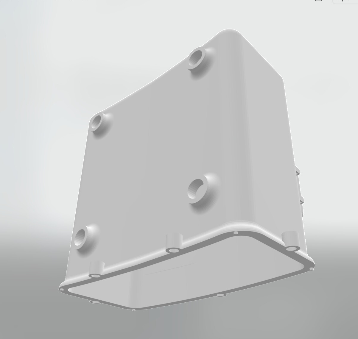

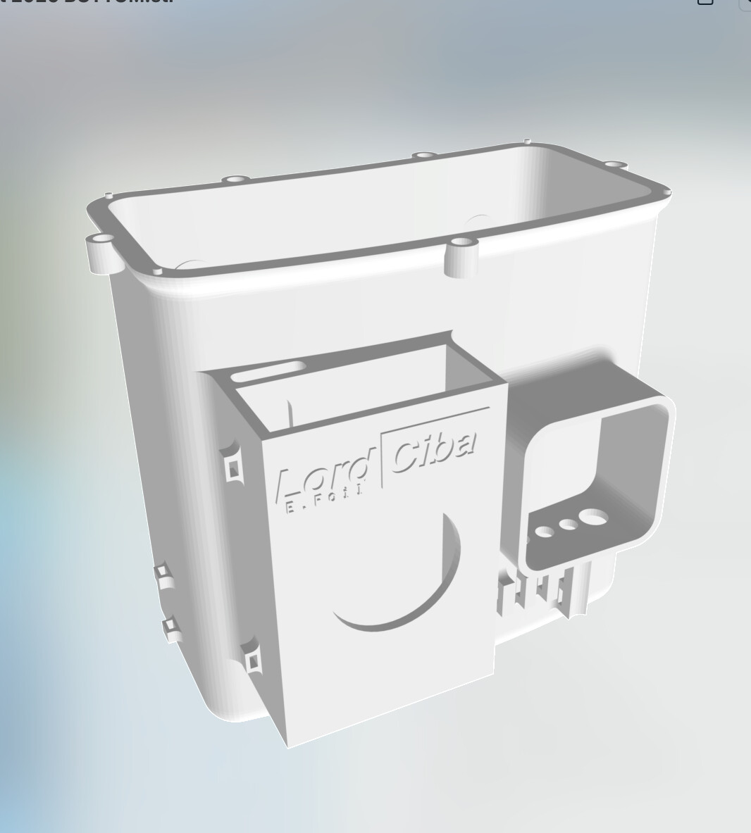

Case was designed by myself on Fusion360. I’ve included 4 inserts on the back to add the possibility to mount it on a harness. But for myself, i’ve tested it on a backpack :

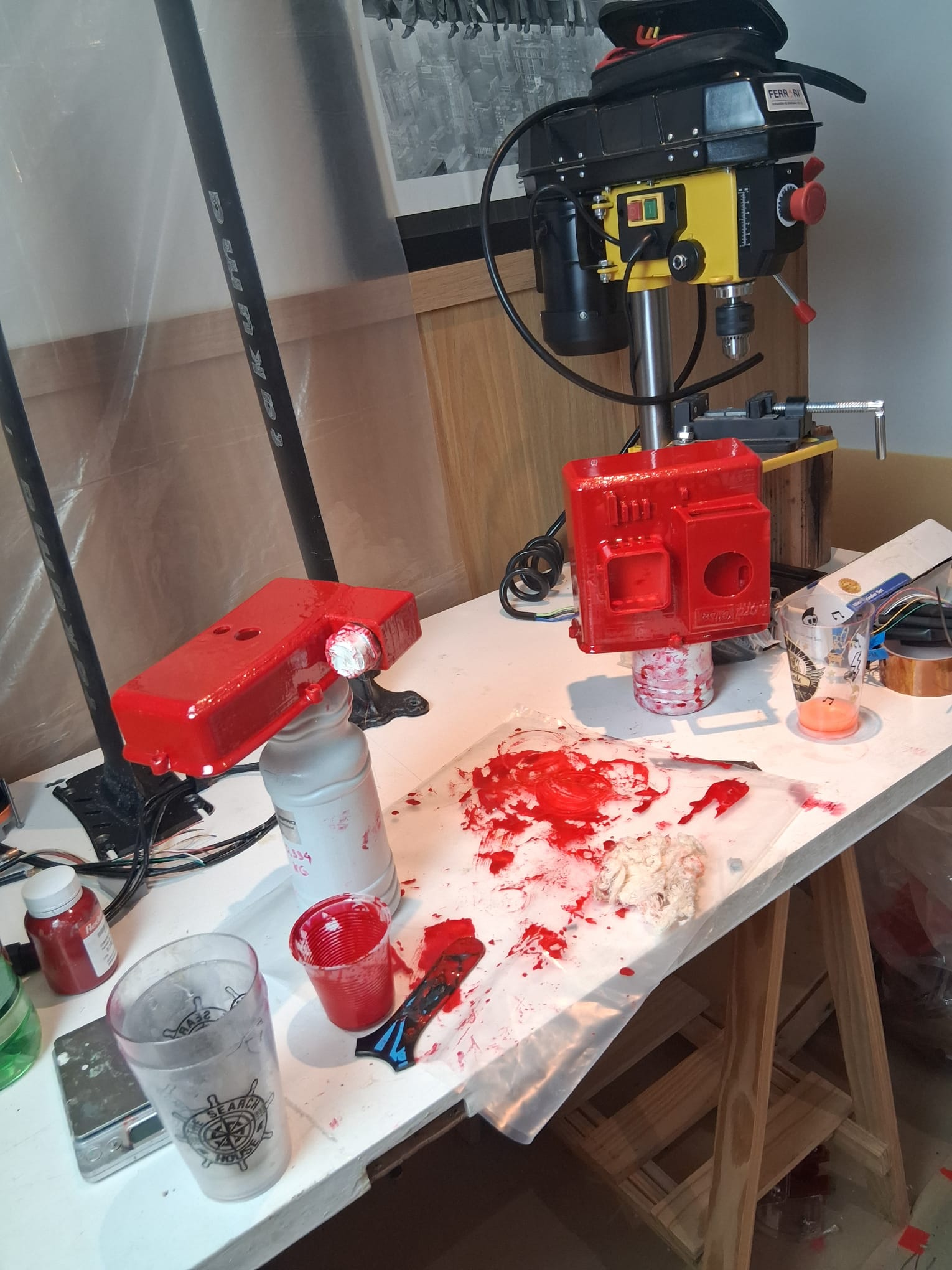

Here’s an overview of the most messy resin and paintjob I’ve ever done:

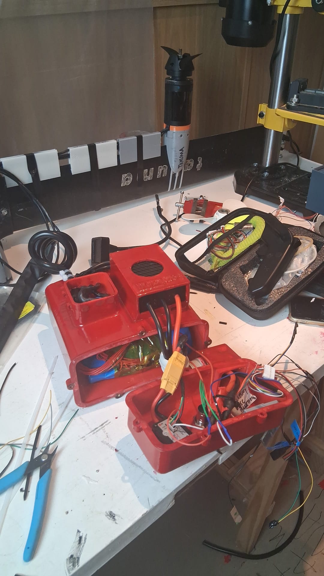

Then, putting all components togheter:

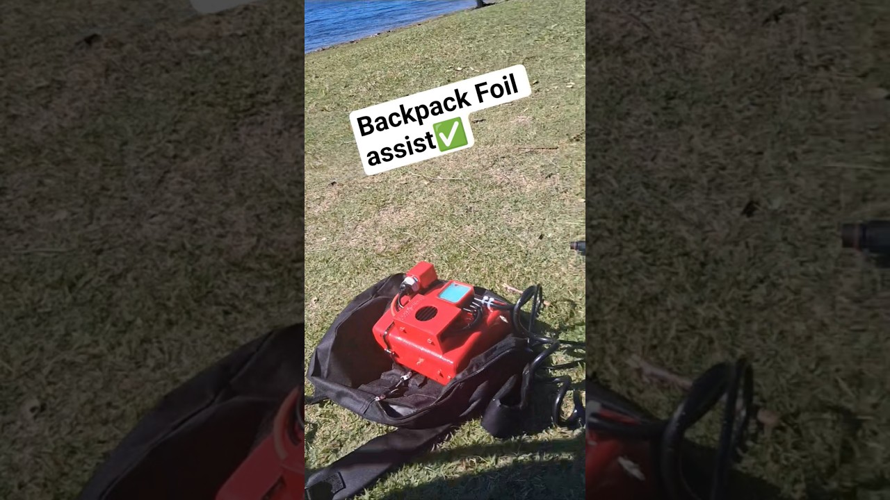

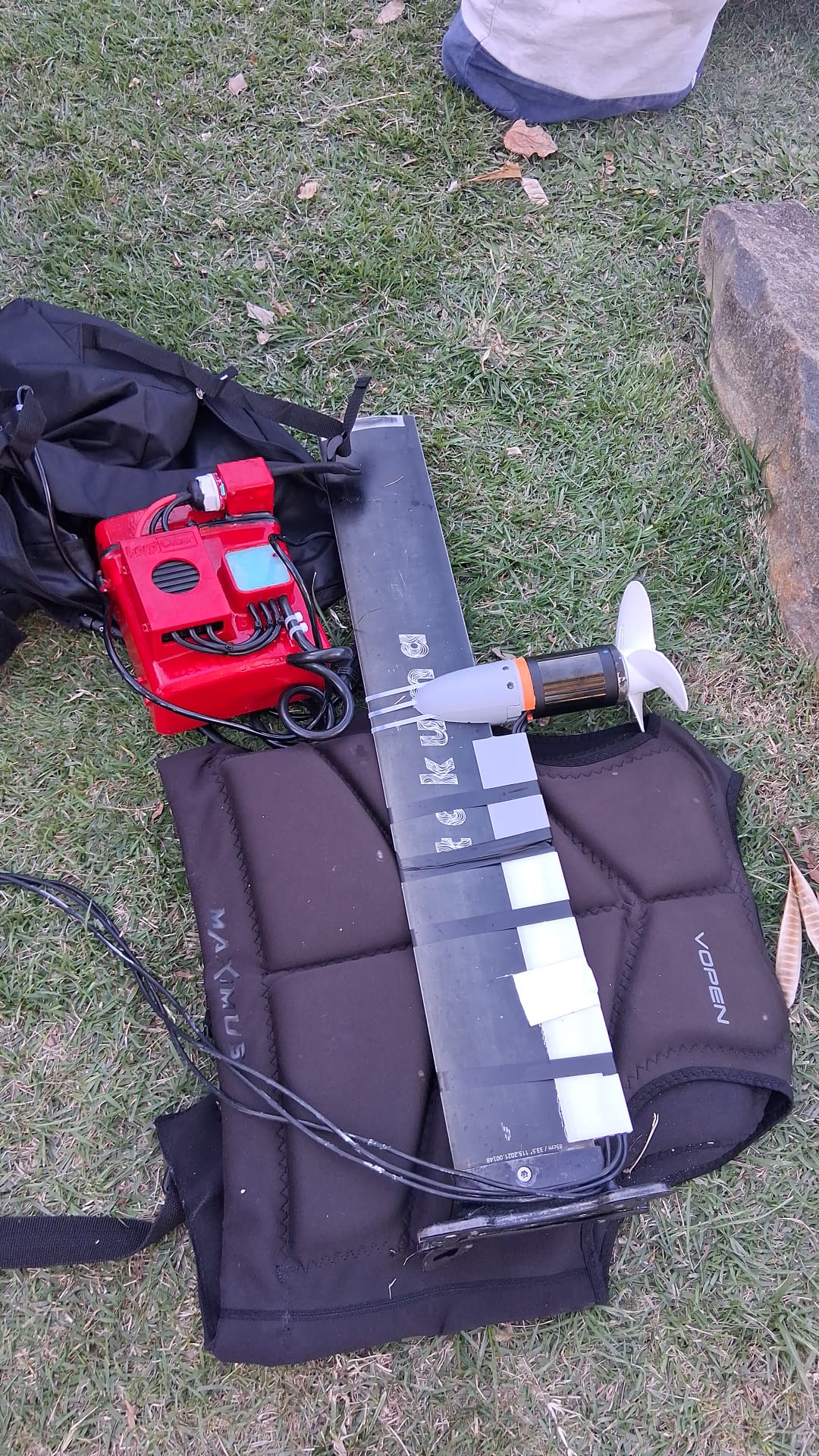

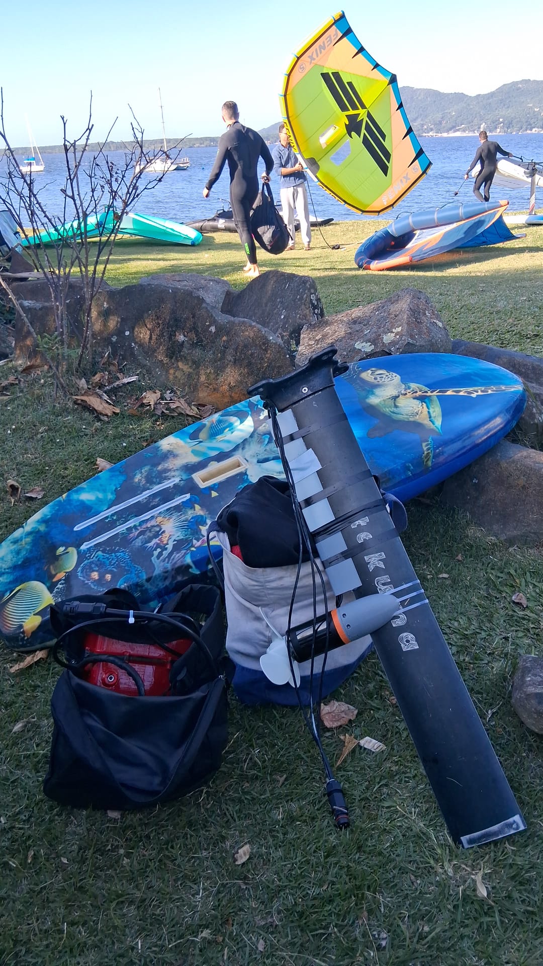

All set !!! First run on a flipksy fixed aluminum propeller.

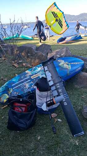

All in the backpack and off we go:
Aaaaaaaand… IT WORKS! :fire:WITNESS ME!
