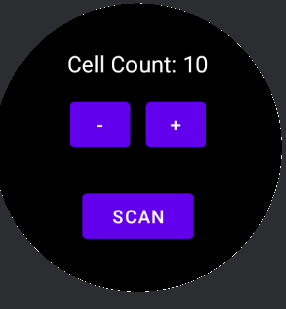

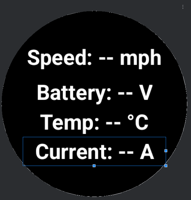

I made a simple Samsung galaxy watch app so that I can monitor some data live while I foil around the lake. I was previously using Alcor Telemetry from the app store, but it stopped working. It was also removed from the app store as far as I can tell. Right now, my app is only monitoring speed, Voltage, current in, and mosfet temperature. I determine speed using location data in mph. The app allows you to adjust the cell count, and it uses this to show average per cell voltage.

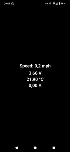

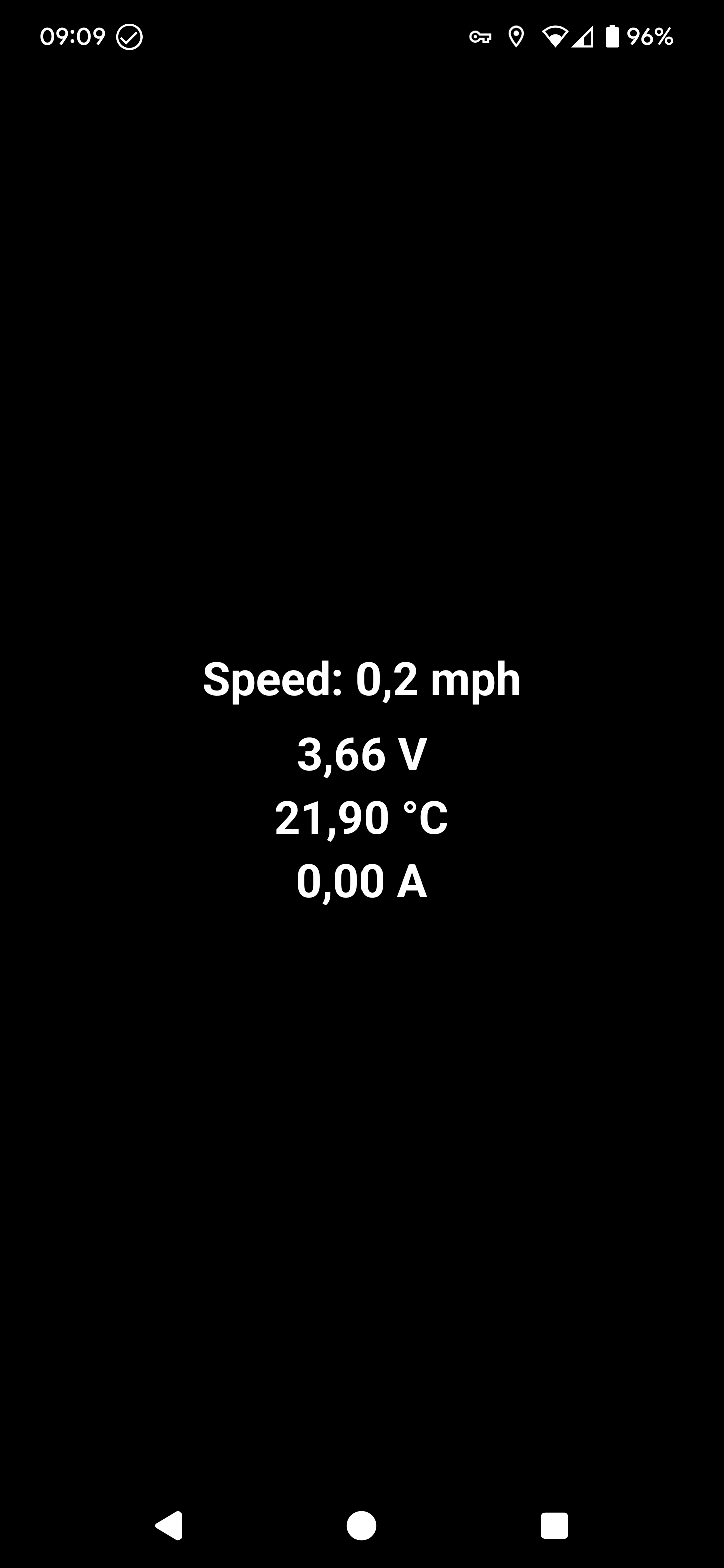

It works on an Android Pixel7 phone too.

That is pretty cool. I really didn’t even think about trying it on a phone.
I can look into it. Maybe I can add a settings screen swiping right to left, or just put another button to switch from the imperial system to metric below the cell count adjustment.

It is a bit small (I am old :rofl:), maybe you can increase the size of the fonts and removing the labels (speed, battery, temp and Current) but keep the units ? Or using the 4 quarter of the watch…

I am not sure why your watch isn’t connecting to the VESC. I know that my VESC will not send out a discovery signal if it is already connected to another device, i.e. my phone. If you haven’t connected to the VESC before using Bluetooth down load the VESC app on the phone and double check that the device is visible there.
The “speed”, “battery”, “temp”, and “current” text actually go away after it connects to the VESC. The font text size remains the same though because of the limitations of the watch face size.
So I tried several things, I even reset my watch, but nothing worked… until I swiped right.
It works! I feel a little silly for not swiping hard enough to the right…(my watch is lagging since last update)
