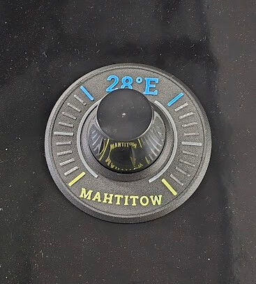

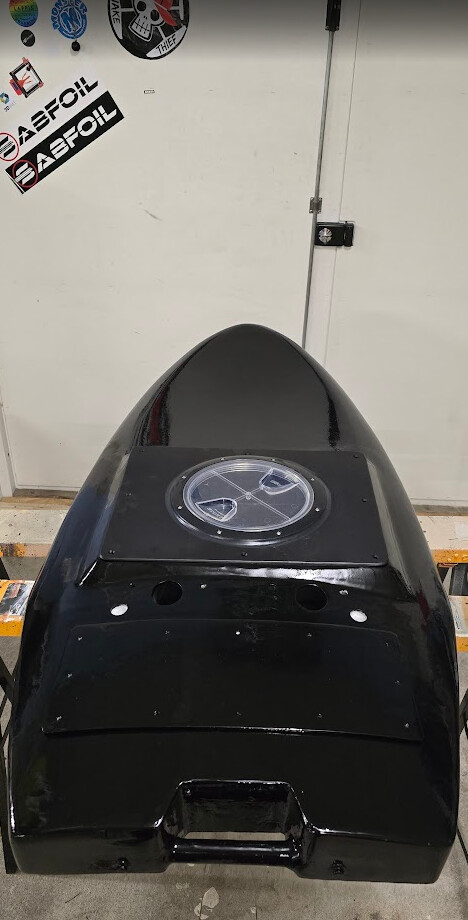

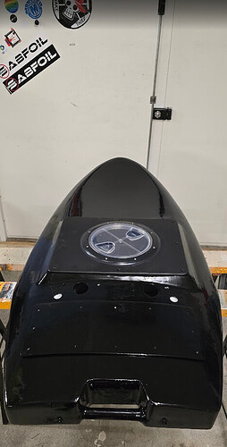

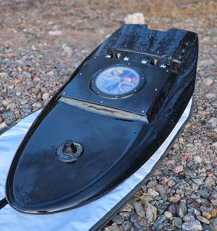

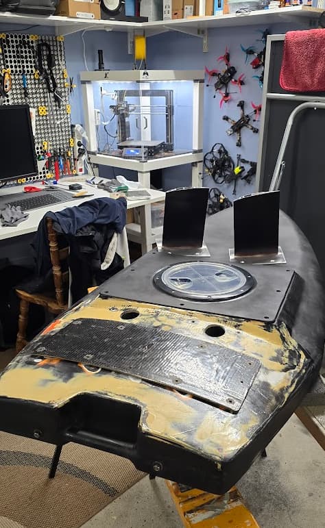

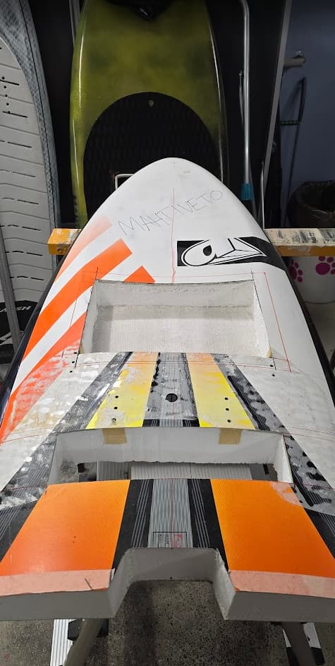

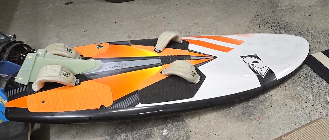

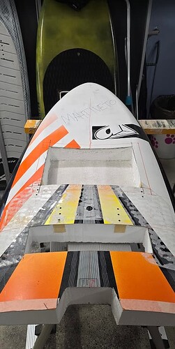

The base is a heavily modified old kite formula board. The hull has been rebuilt to include separate sealed compartments for electronics and batteries.
:gear: Setup
2x Flipsky 75100 Pro V2 (VESC)
2x Flipsky 6384 motors

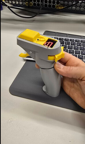

BREMOTE controller

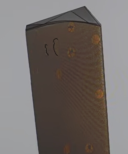

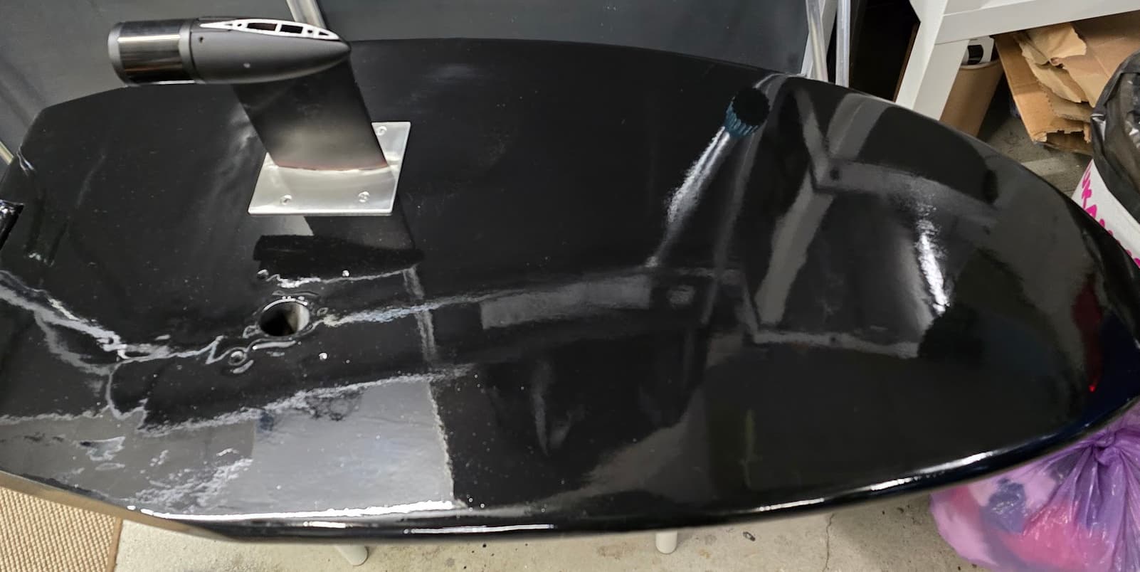

Motor mounts / masts:
The motor masts are made from Fanatic aluminum foil mast, cut to length and modified with TIG-welded plates at the base to mount them to the board.

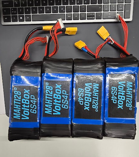

Battery setup:
4x 6S4P packs
Wired as 12S per motor (2 packs per motor)

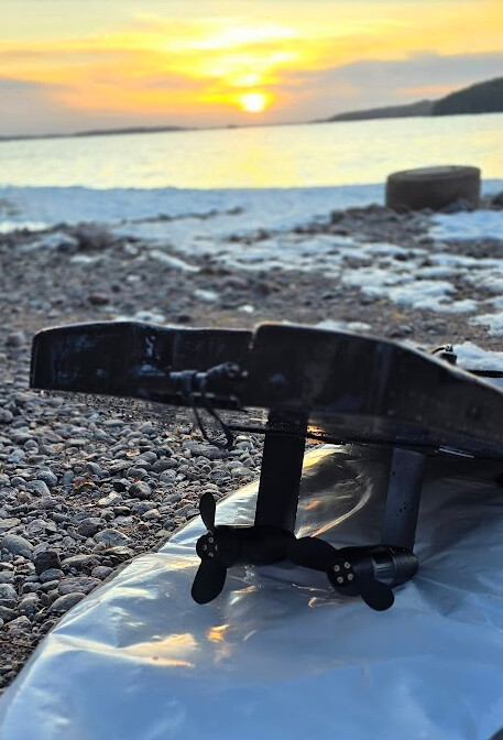

:ocean: Testing & Performance
Since the ice has only recently melted here in Finland and the water is still near freezing, the first ~5 test sessions have been done using a larger board and foil.
With a Sabfoil 1360 Leviathan, the range is around 20 km, which is more than enough for my use.
I know many people here have had issues with Flipsky products, but my experience has actually been quite positive.
The 75100 VESCs performed reliably last summer (~200 km without issues).
I did have problems with the VX3 remote, but it was replaced under warranty with a VX5, which has worked great since.
For cooling, I’m running passive aluminum heatplate on the VESCs, which I expect will improve long-term reliability of the electronics.
This project took way more time than I expected. Roughly 4 months of evenings and weekends.
In many ways, it has actually been more challenging than building an e-foil, but also a lot more interesting.
The system is not quite finished yet — next step is dialing in the motor trim, as they currently hit the surface a bit and cause some slapping in the water.
So far, though, the result feels very promising.
The boogie also works surprisingly well as a remote-controlled water drone :smile:
Next step is adding GPS follow me mode, but that’s currently in the hands of the BREMOTE development team — waiting for a future firmware release!

A few clips from testing:
Some build photos from different stages:
