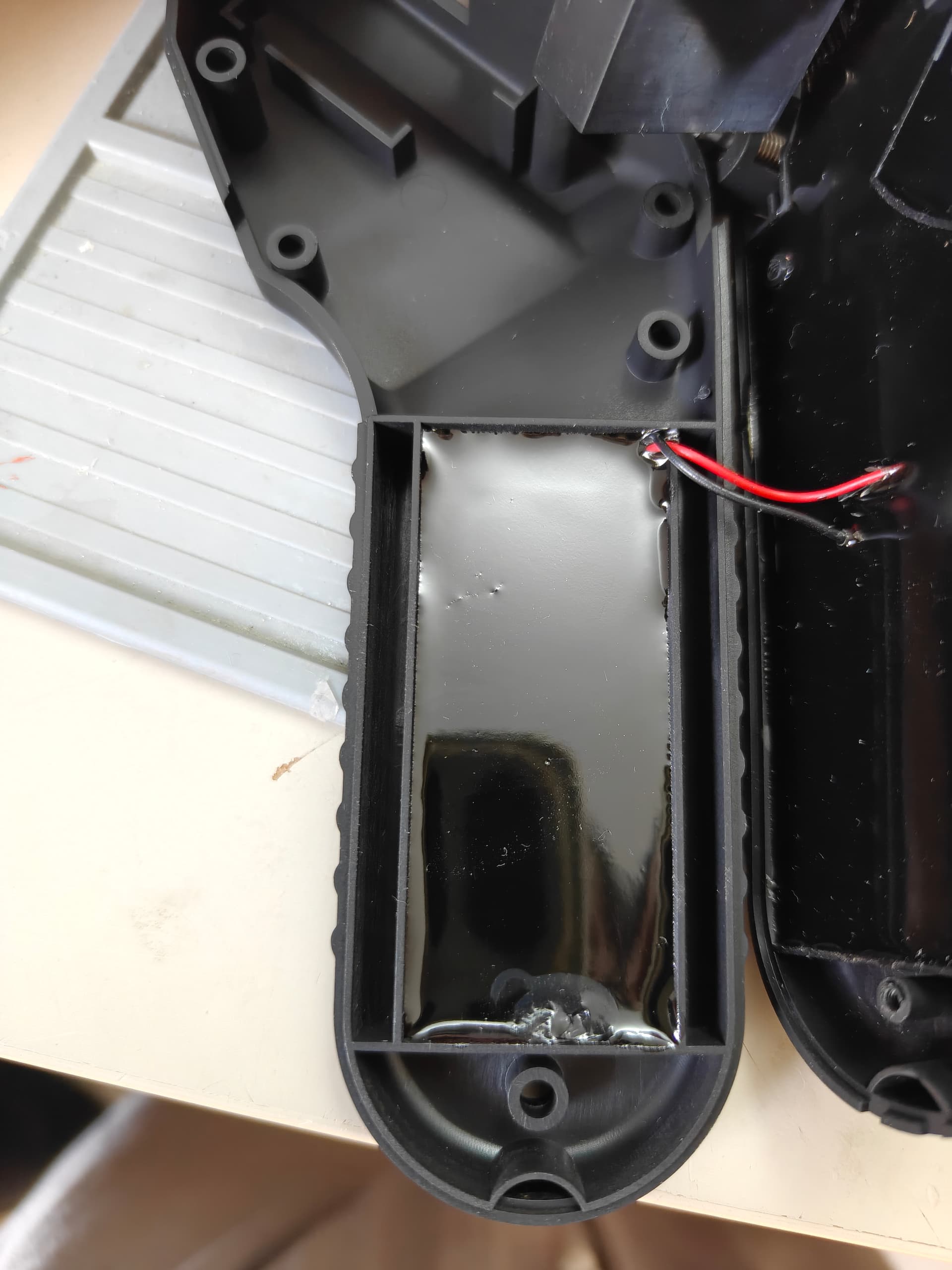

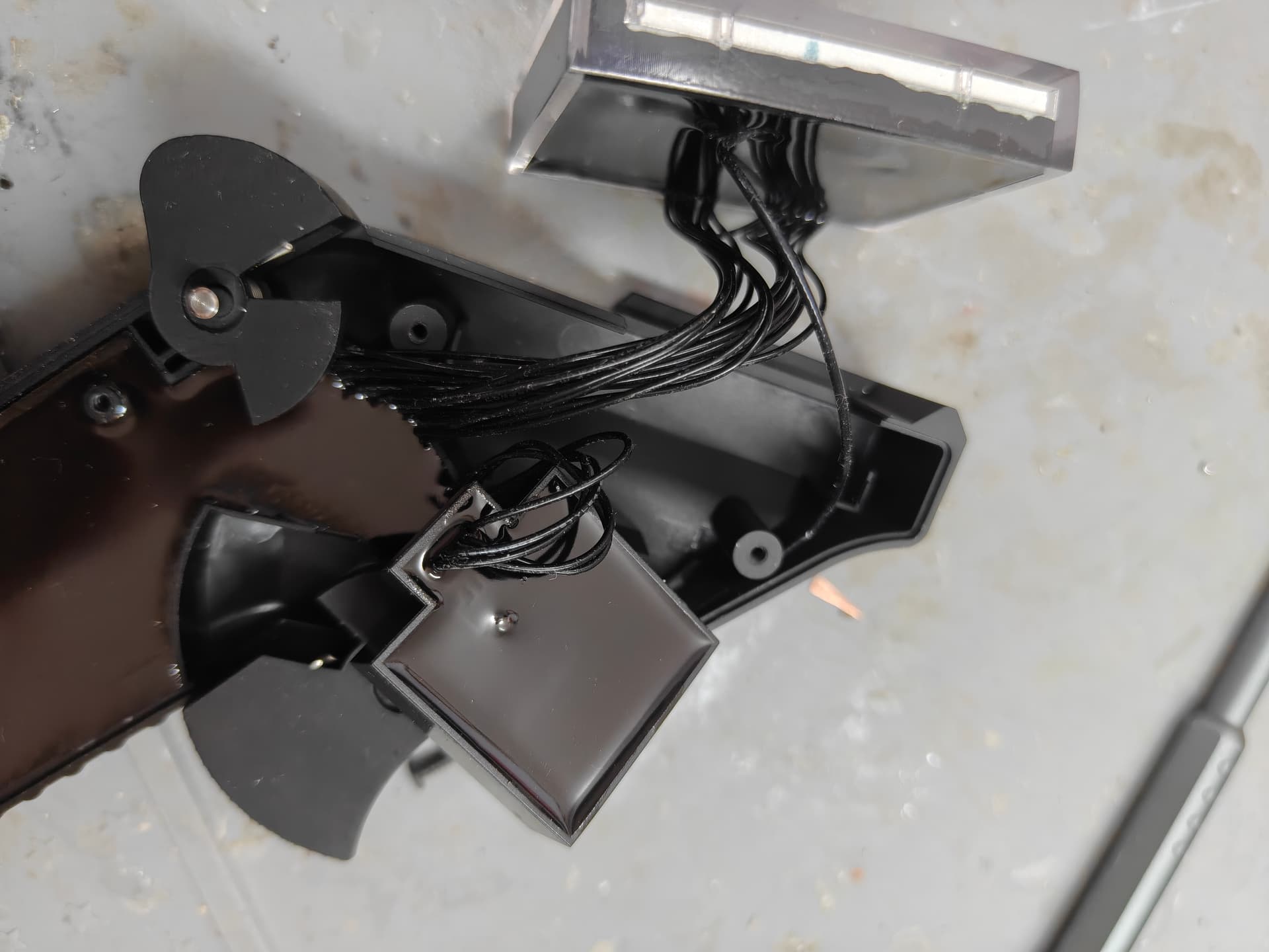

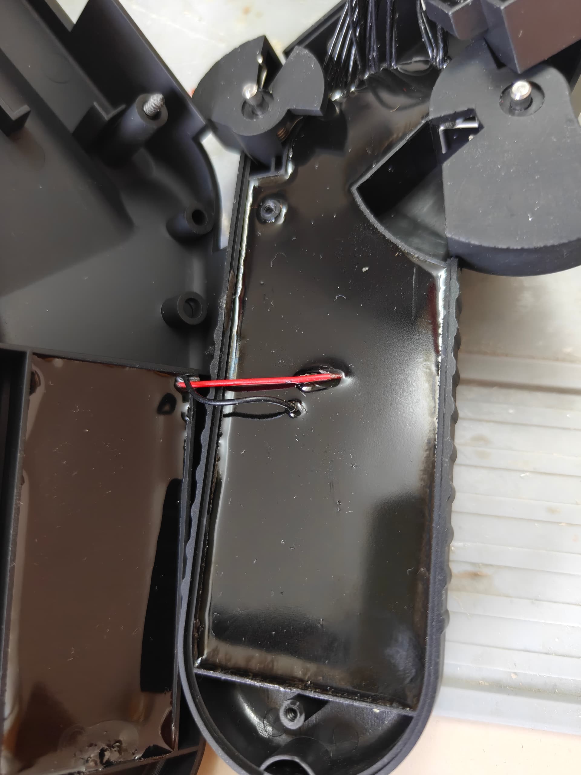

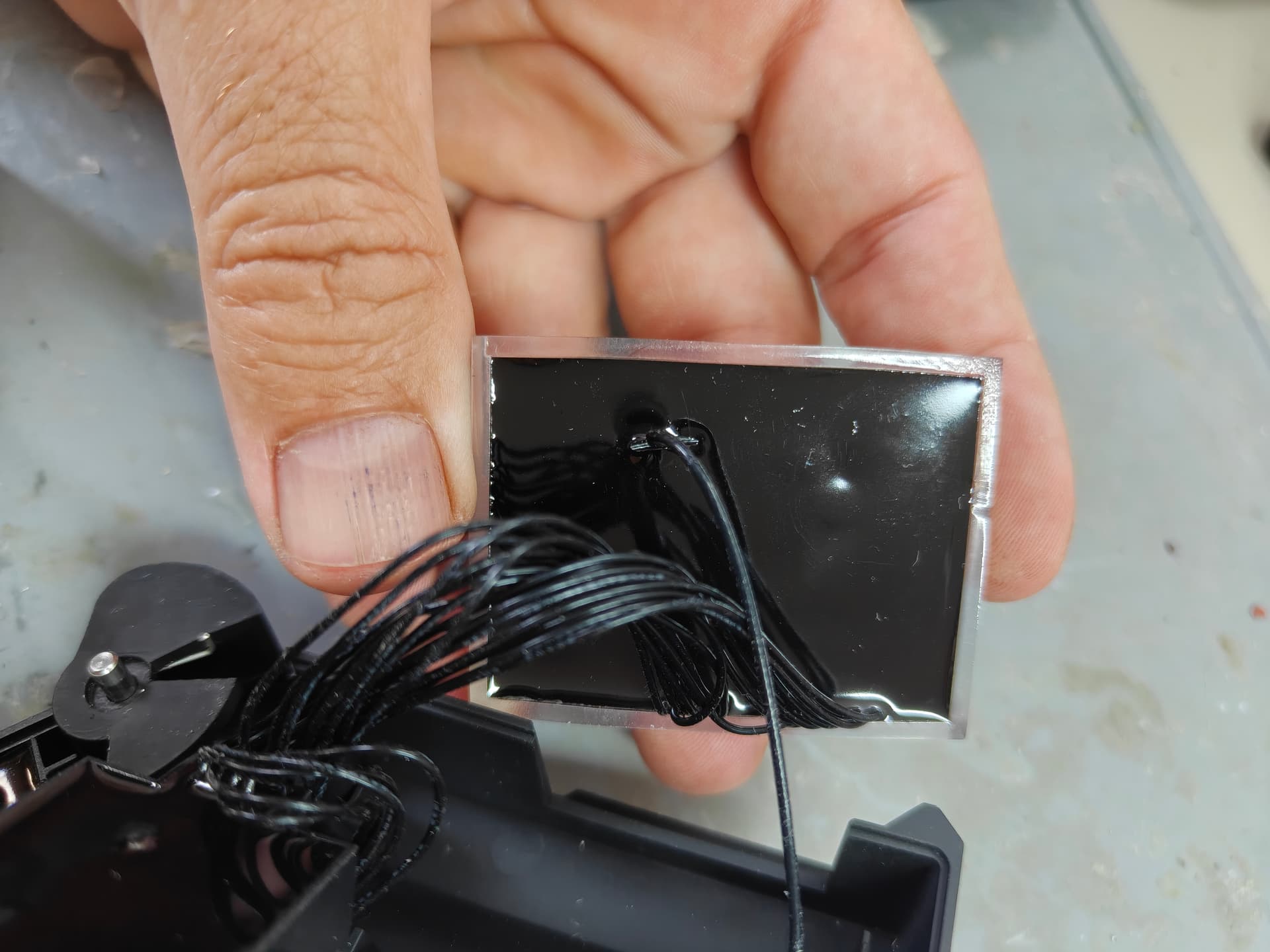

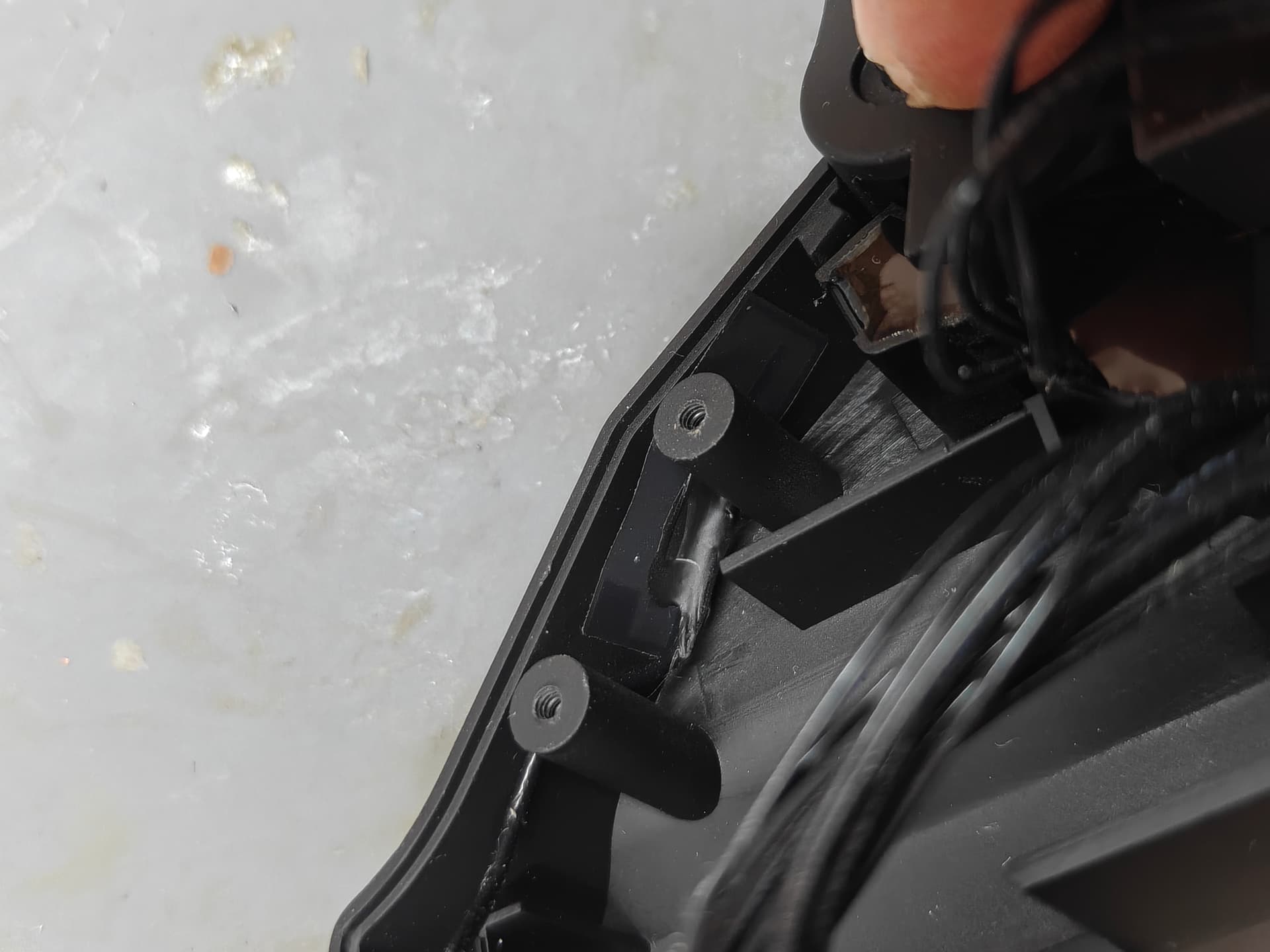

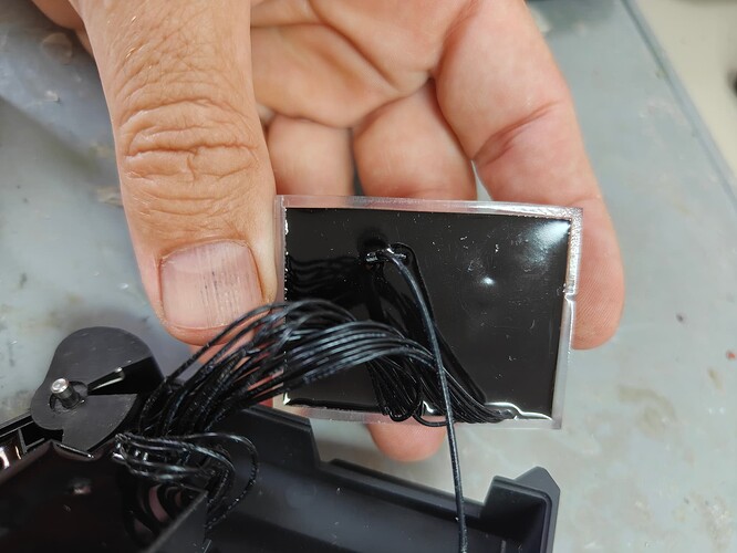

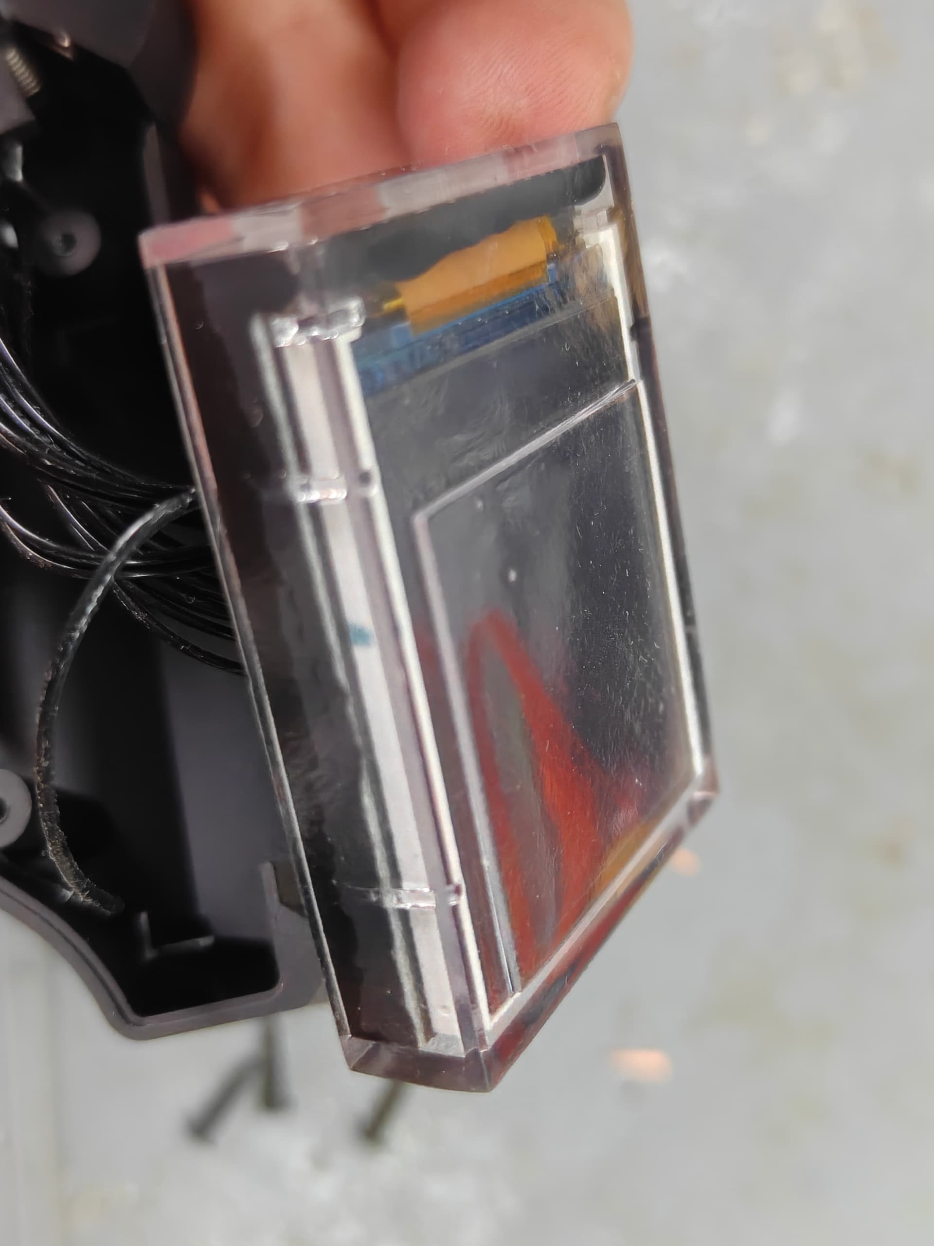

I managed to save my VX3 after some water ingress by injecting some Araldite in a small hole I made next to the ribbon at the bottom of the front of the screen. I also covered all the edges at the rear between their potting and the case. it seems to hold fine now.
It is a transparent epoxy? Otherwise it can block the view…
