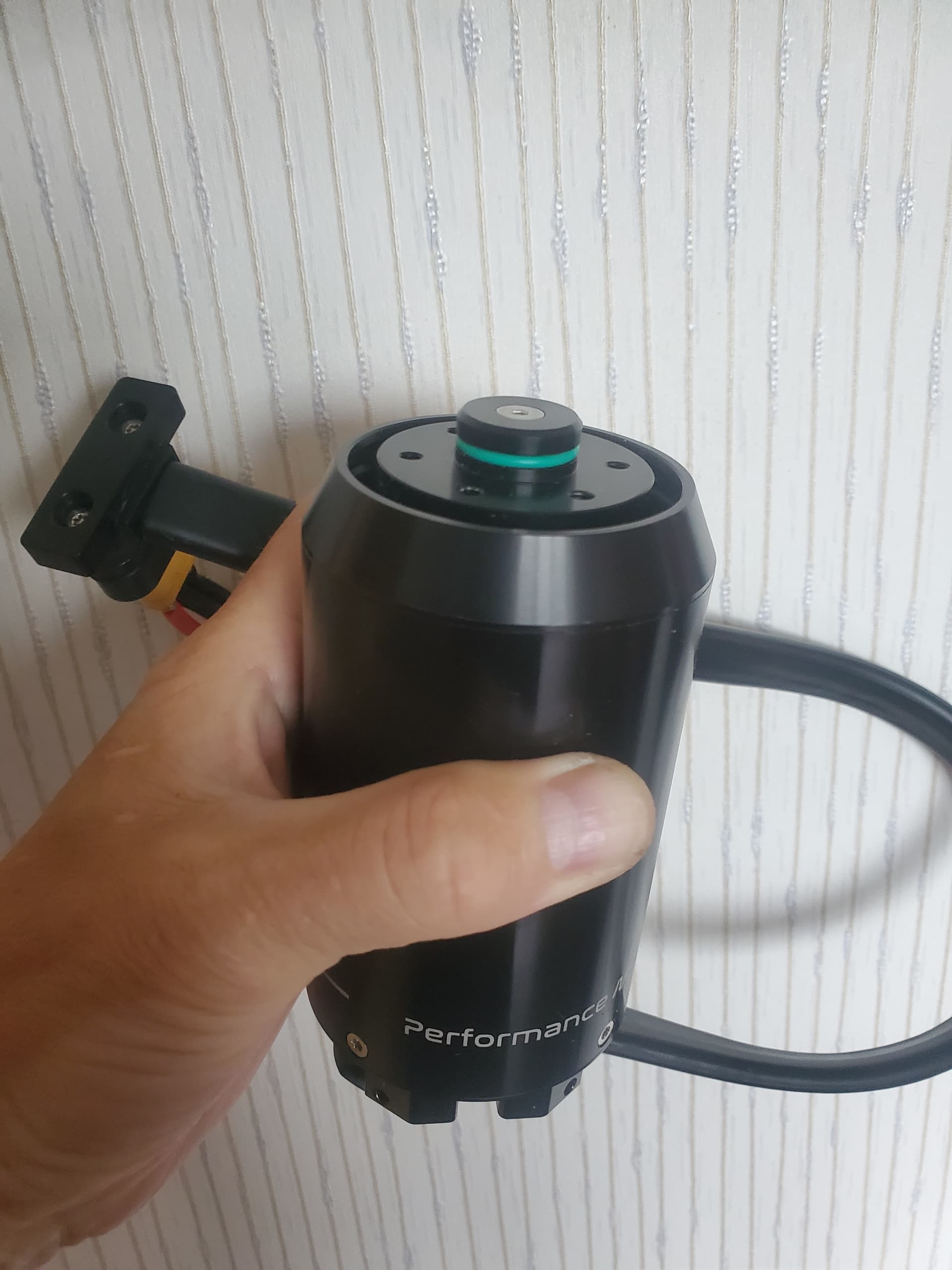

I happened to come across a new Manta motor. Judging by the high shaft discreteness, I thought it used a gearbox. Does anyone have any reliable information on this?
I don’t think it uses a gearbox. You’d hear it immediately when you rotate it if it does though.

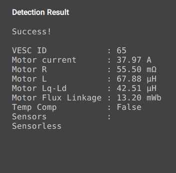

Indeed, there is no gearbox. VESC Tool correctly detected the motor with the following parameters:
manta perf
Question: Is the Manta Performance motor an inrunner or an outrunner? Thanks.
I think it s an inrunner, and the closest motor I think is this one :
Yes, it is a inrunner

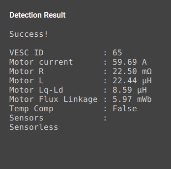

For comparison: Flipsky 65121
65121
Looks like a good quality motor with those valueswhats the diameter of the motor? Almost looks like 65x100

It’s not an inrunner. It actually a 6385 outrunner with a Faraday Cage built around it to seal out the water.
An innie-outtie runner. I think stoke foil boost use a similar concept.
I tested something like this ages back and it burnt out so fast.
Have you seen it torn apart?
Then it is more likely that it is 63100, since the detection parameters are identical.
