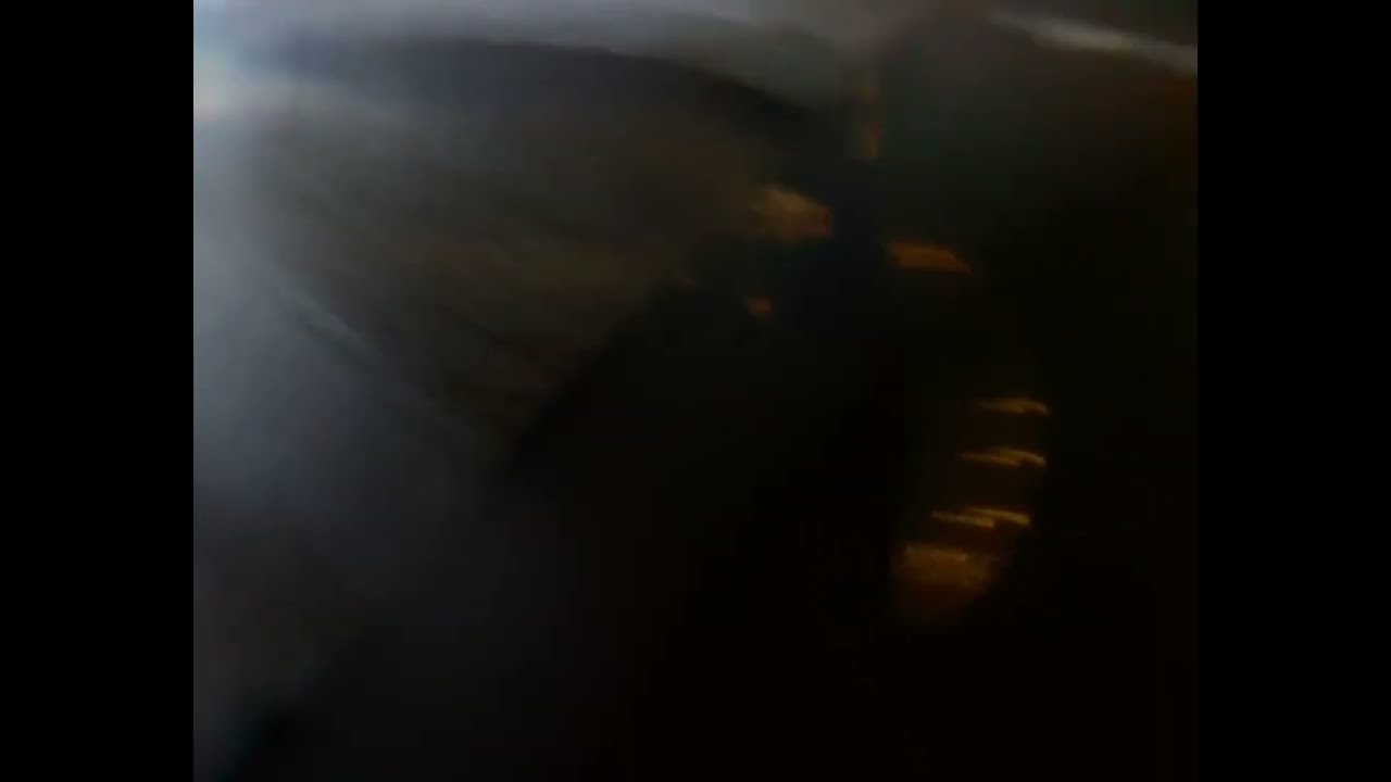

I could see i had a huge cavitation going on while foiling, especially at higher speed so i tried filming it with my 360 cam. Interestingly enough it comes from the old cable inlet which i’ve just taped over to cover it (a few layers though).
Clearly there’s a low pressure area created on this small irregularity - i never thought it could give this large effect!
Time to fix properly :grinning_face_with_smiling_eyes:
Interesting video, must have been challenging to foil and shoot at same time. I’d have face planted for sure :grinning:
All of that from a small hole that’s sealed! Do you think the tape bulges out or sucks in to create the irregularity? Perhaps doesn’t make any difference which.
Makes me wonder what a duct, nosecone etc if it wasn’t perfect would create.
How fast were you going when you did video?
I don’t know but not super fast, 25-30kph is what i’d assume.
How large is the inlet? I assume the tape is getting pressed in under pressure and then creates the cavitation.
