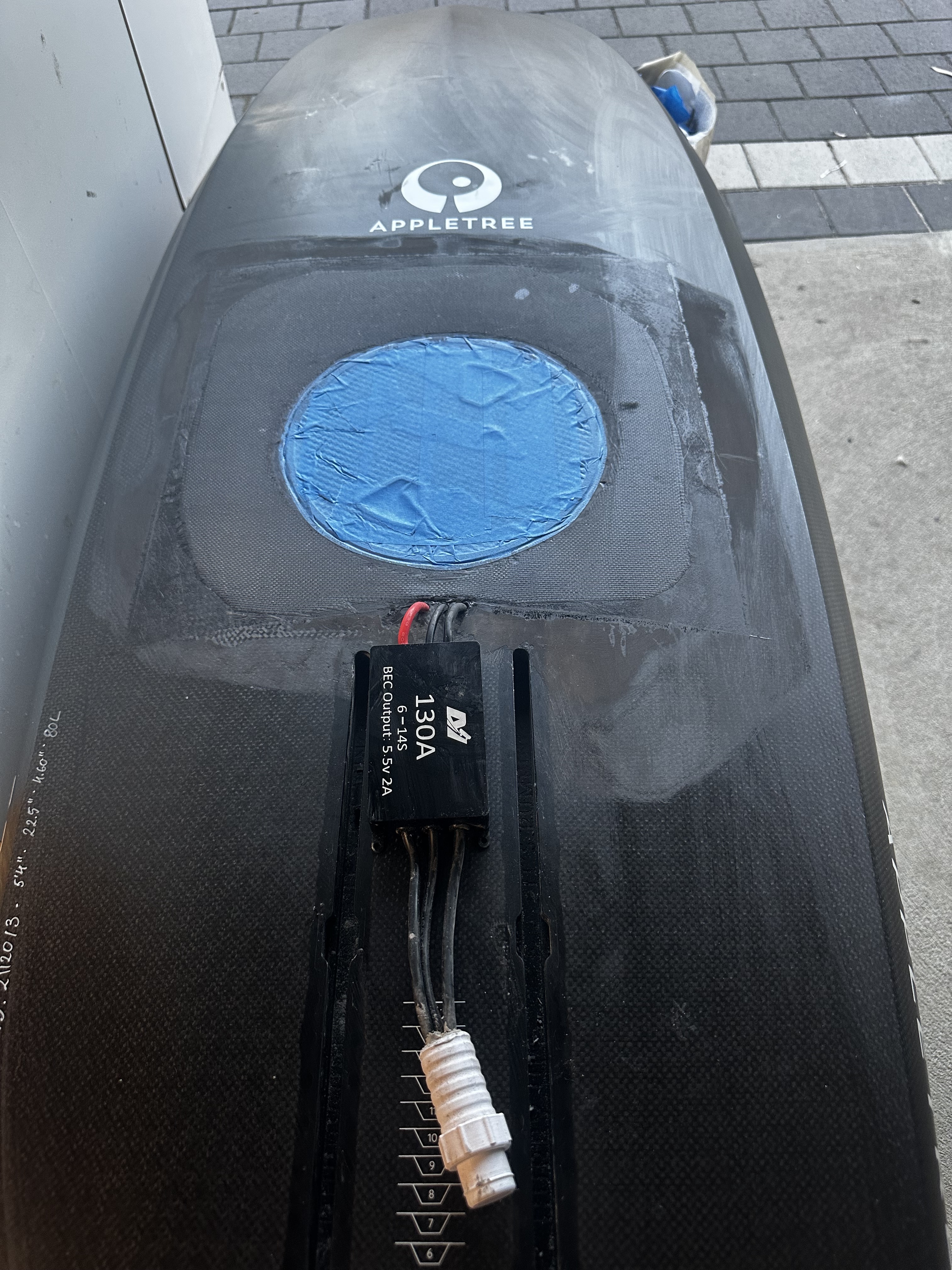

Have had back pack setup for a bit but didn’t like the cable hanging off and getting in the way a lot. So since have built system back into my 80l apple tree board. Had my first wave session out on it on small waves and had a blast .
My usual setup is great molicel 50p 12s3p, flipsky 6384 motor with maytech 160amp which has more than enough thrust on any foil but I know it’s a lot to do with skill but always get about 10mins less than foil drive setup.
I bought one of these 130amp waterproof esc from maytech to try and chase more run time but it doesn’t seem to have enough thrust or speed to get onto foil. I’ve had flipsky 2blade folding prop. I’ve read somewhere some guys are using foildrive props will that make a difference or have I wasted my money on this ESC I also got there 6374 motor to try but since read that they don’t have enough power either. Has anyone tried this setup and had any success or do I need to go back to 6384 and have a try with vesc again or just normal ESC?

I did have the 130amp esc working with a 3bladed prop on a larger 1250 wing and got exact same run time as my friend on foil drive. This last time I used 130amp speedy with flipsky 2 bladed prop it didn’t have much thrust at all so I assume it must be prop?
