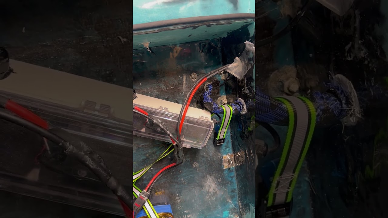

I just got my boogie in the water today after months of work and after 1hr of use the right motor started skipping almost like it wants to go into reverse I had similar issue with my assist with 6384 motor which turned out to be bearings. I will swap out ceramic bearings for stainless but this does not seem to have slop or play in outer housing. Any ideas of what it might be all my wiring seem solid and it sealed in shrink tube
