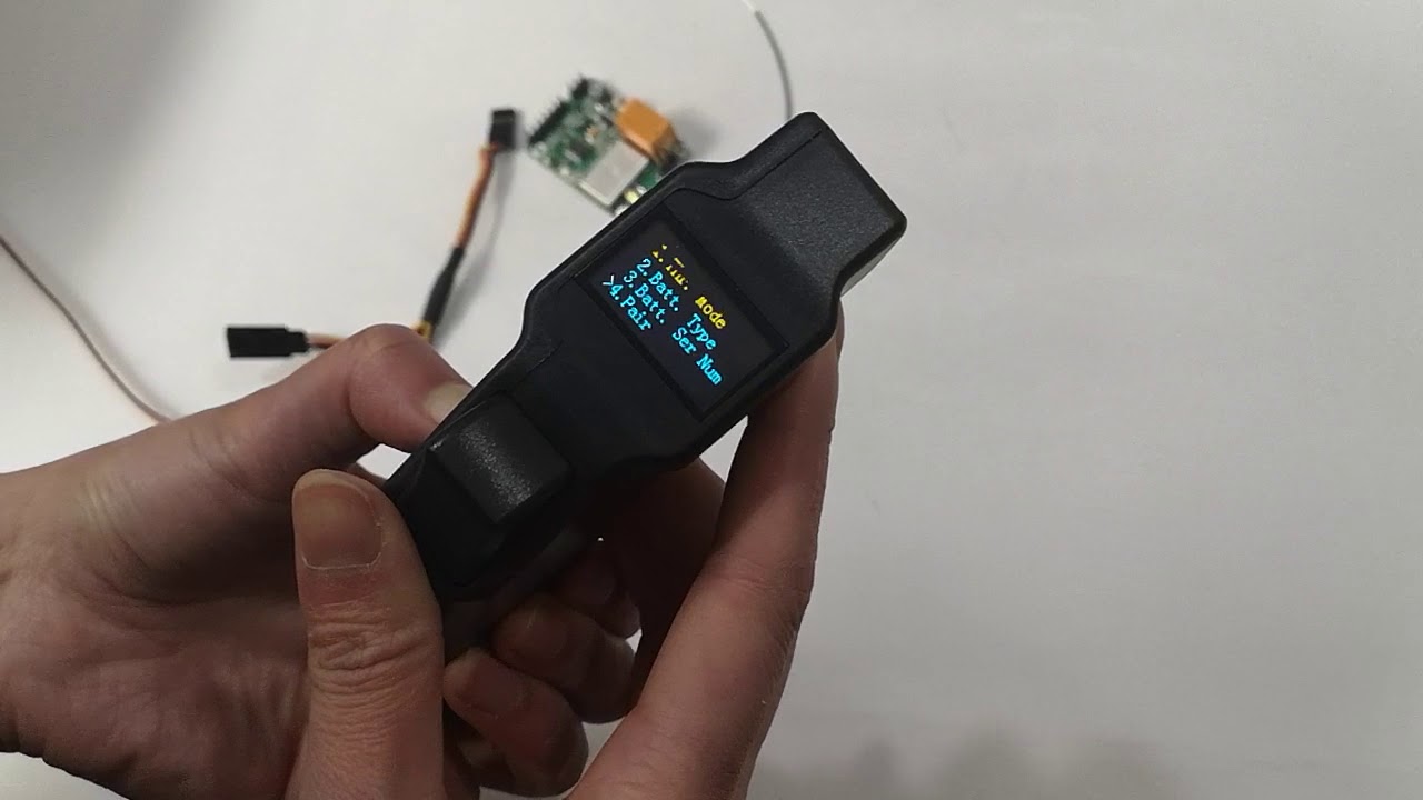

Anyone had similar issues, I am following the pairing instructions
Fixed it, see this video
Turns out you need to press the brake button to finish the process and this isn’t stated in the instructions.
That then takes you back to the main screen and the light goes solid red
Nice that you got it paired… But according to Maytech’s howto it does say press brake button
  1. Long press function button for 1 second to enter pairing status, when screen shows 【..】, turn on the receiver, it will auto-pair with the remote in almost 0.5 second, short press brake button and return back to main interface, receiver red light lights steady, and signal show in the left corner of the screen, receiver pairing successful.

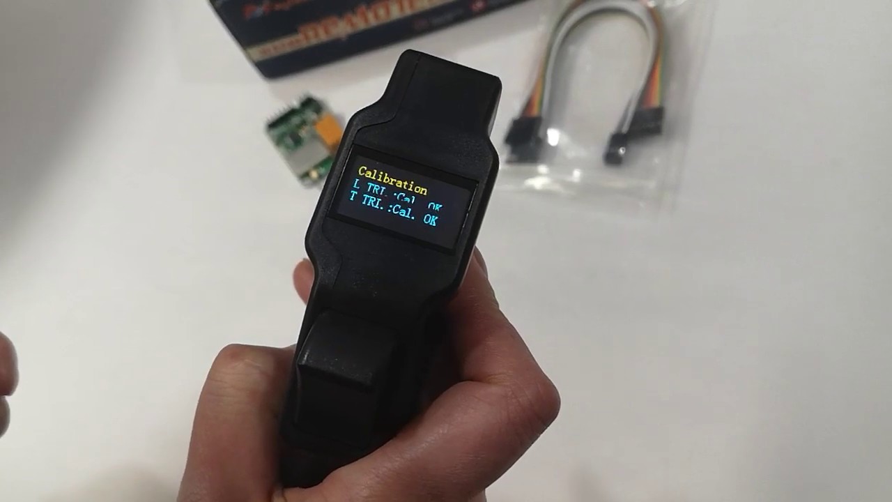

Did you calibrate (menu 5) to make sure 100% throttle on the remote side corresponds to 100% PWM on the ESC side:

so if the light is solid red, its paired?
Yes, also you can see signal strength on the screen left corner
