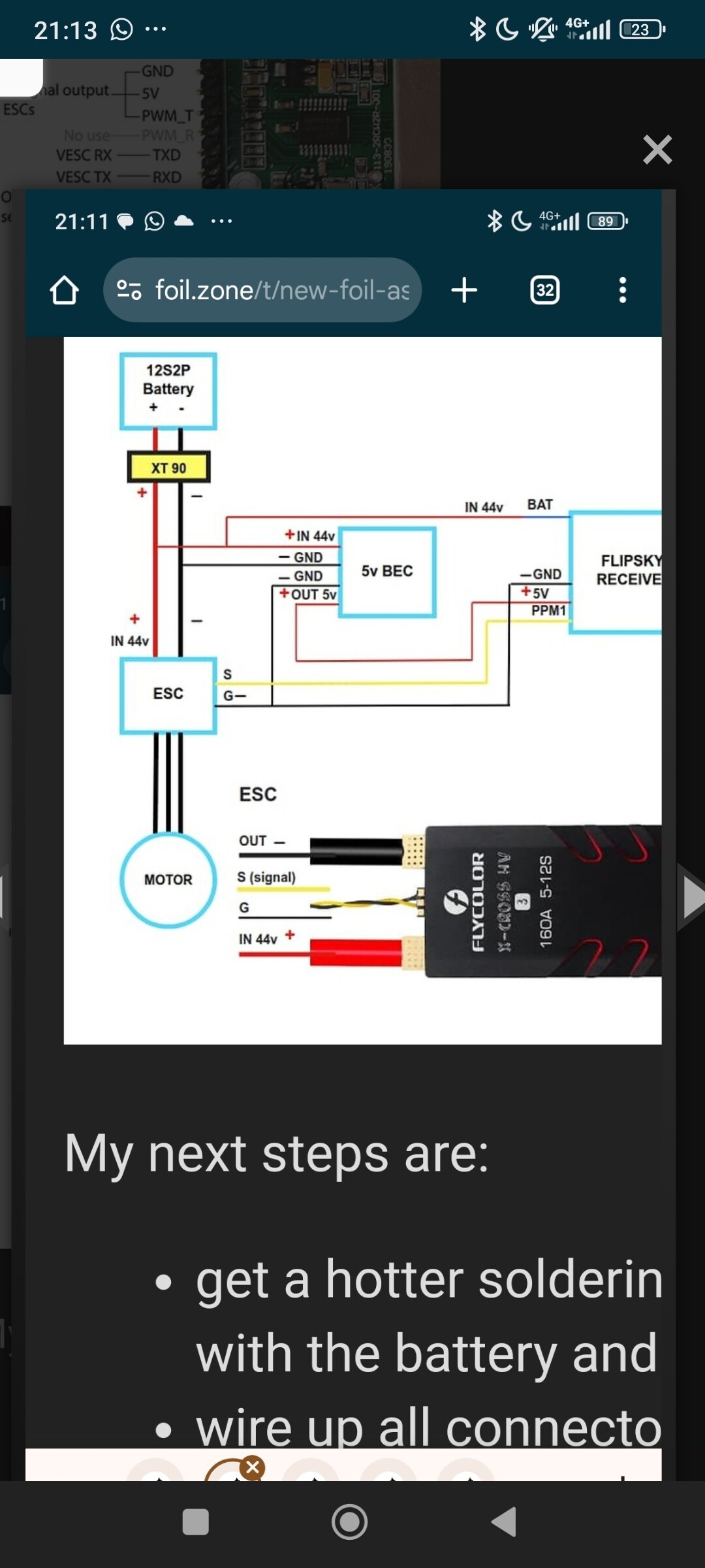

I made a foil assist : Flycolor 160A, 2 6s2p in series
Maytech V3 remote, Flipsky 6384 motor.
My wires are connected exactly like this with Maytech receiver.
My parameters in the remote are : esurf mode, battery type 3.7V , battery number : 12 , data source : MTESC but I tried everything vesc no source motor wire, and I dont have the battery level or percentage…
Does it happens to someone ? Do you have any ideas how to fix that ?
Have a good day !
That is happening on every single one of my builds and each time it was a break or bad connection in the wires …check the connection of the battery wire from the positive terminal to the receiver with a continuity check tester and a voltmeter…hope it works
Thank you for your answer, finally I decided to just change the wire that comes to BAT from receiver and it works :pray: it was my first cable that didn’t work I dont know why but problem solved now !
