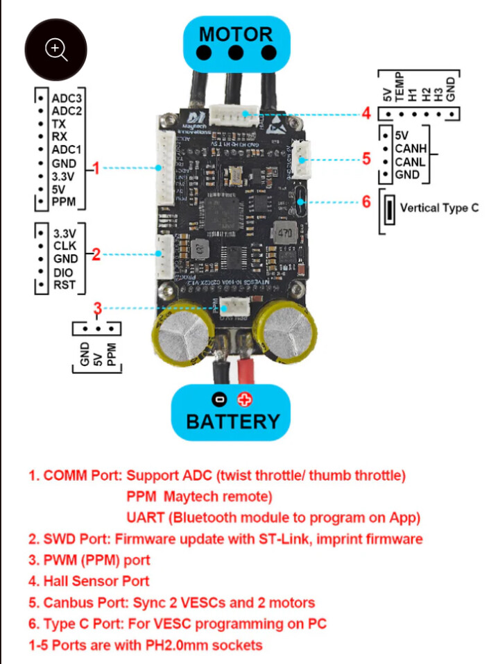

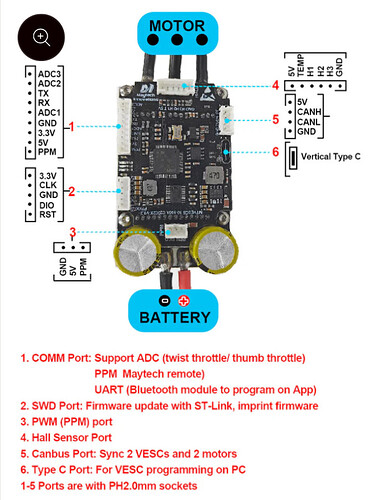

Just connecting up my Maytech V6 10A Vesc for the first time and notice on the wiring diagram that there are two place to get the 5 volt and ground and also two places to get the PPM signal. As I will be running UART and PPM to my Maytech controller is there are difference or advantages to picking up the PPM and 5 volt from either one of these places or is there no difference?
ie should I pick up the 5 volt in the same place I’m picking up the UART
or
should I be picking up the 5 volt where I’m picking up the PPM
or
should I pick up all 3 from the same connector.
Or doesn’t any of that make any difference at all?
Thanks in advance.
There shouldn’t be any difference. If in doubt, use a multimeter to check continuity between the pins.
Both of them works, you can use any of them.
