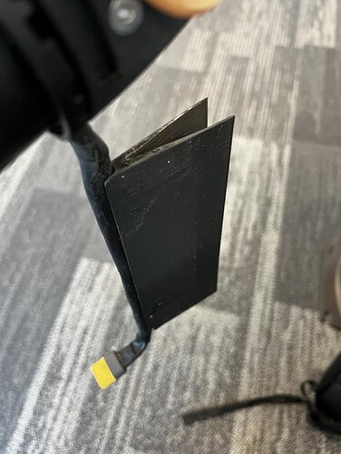

What are peoples thoughts about trying to improve the efficiency of the mast through the water by introducing a pointed cable guide/cover trailing edge. This would only be above the motor for e-foiling back out to catch the next wave?
Motor cable is quite large and disruptive of water detaching smoothly at the back of the mast?
Any clever ideas out there of how to do this in an easily attachable and removeable way? I use the same mast for motor-less foiling as well.
Worth the effort? Photo with Axis alloy mast was my first setup. Never tried without a trailing edge tidy of the cable so not sure how much of a difference it makes.

I’ve always just tried to blend the cable guide into the mast as per below but still requires holding in place somehow on the mast in an easily removeable way.
Did you try to print the cable holder with the motor mount?
Yes I have tried that. My different masts have slightly different offset distance from trailing edge so when I swap between masts I don’t want to have to change cable guides as well. Cheers
