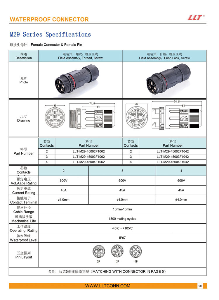

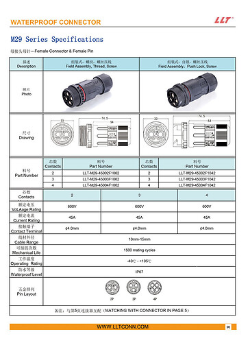

After researching and comparing with what most guys are using MR60/MT60 I’ve found this connectors: M29 female pin female connector_China Aviation Connector_Waterproof socket_Industrial connector_Shenzhen Lilutong Connector Co., Ltd.
llt-m29-45003f1062
The casing is 33mm diameter, not as small but keep in mind it has 3 4mm pins while MT60 has 3.5mm pins.
Not sure if they are gold plated as good sourced MT60/MR90 should be. So it’s an option specially if you want to make panel mount with LLT-M29-50003F2862
Is it for efoil or assist? For efoil, this connector is too weak, take one that israztrs for at least 120A. Depends also on your setup (motor, foil, board) and your weight. MR 60 is rated 60A and is barely OK for an assist but you‘ll burn it with a bigger motor like 65161. the one in your picture is rated 45A.
