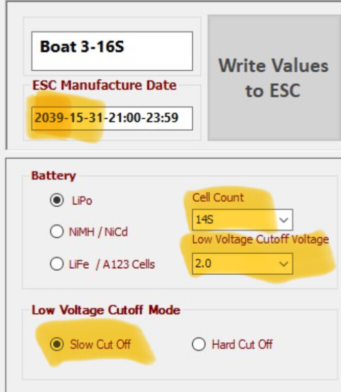

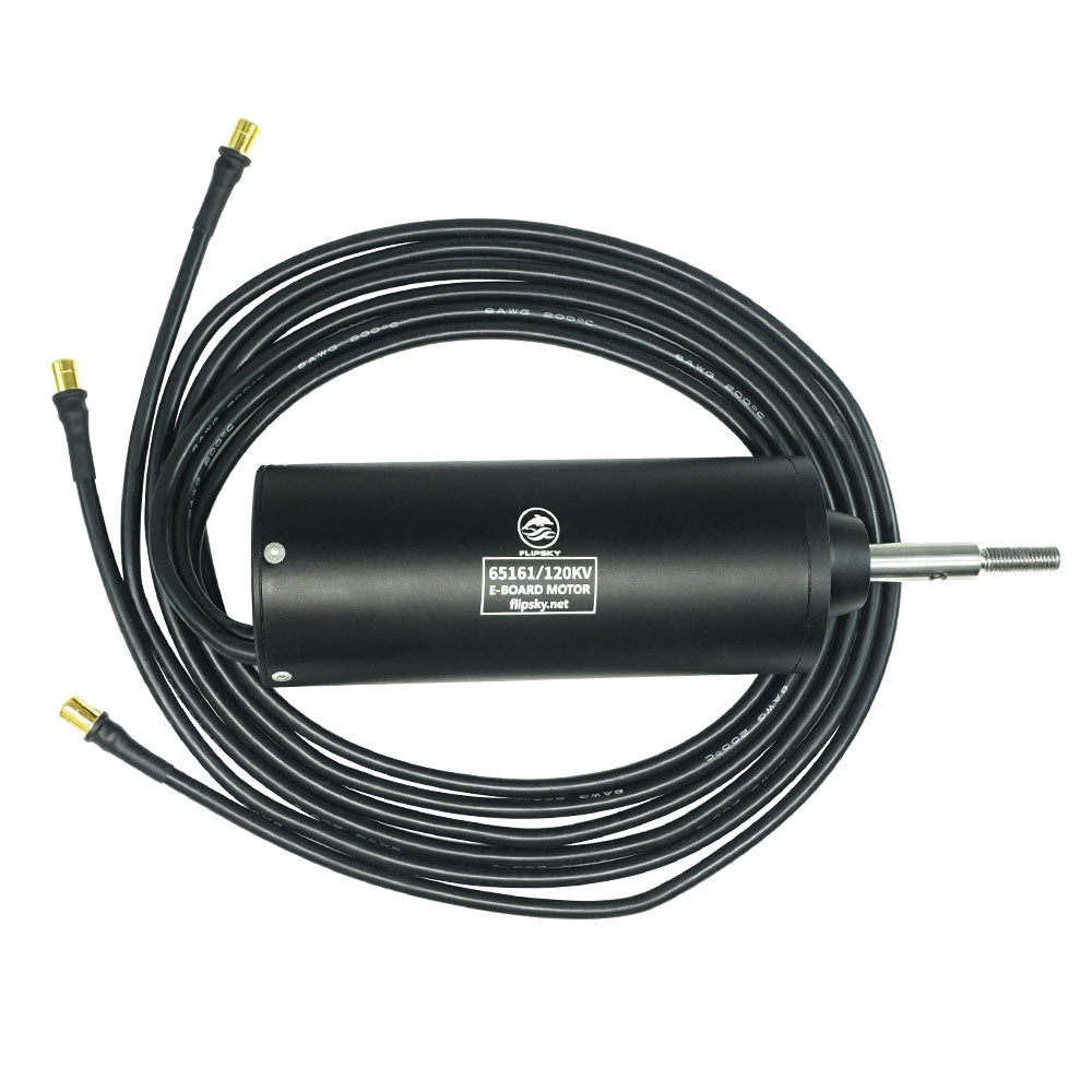

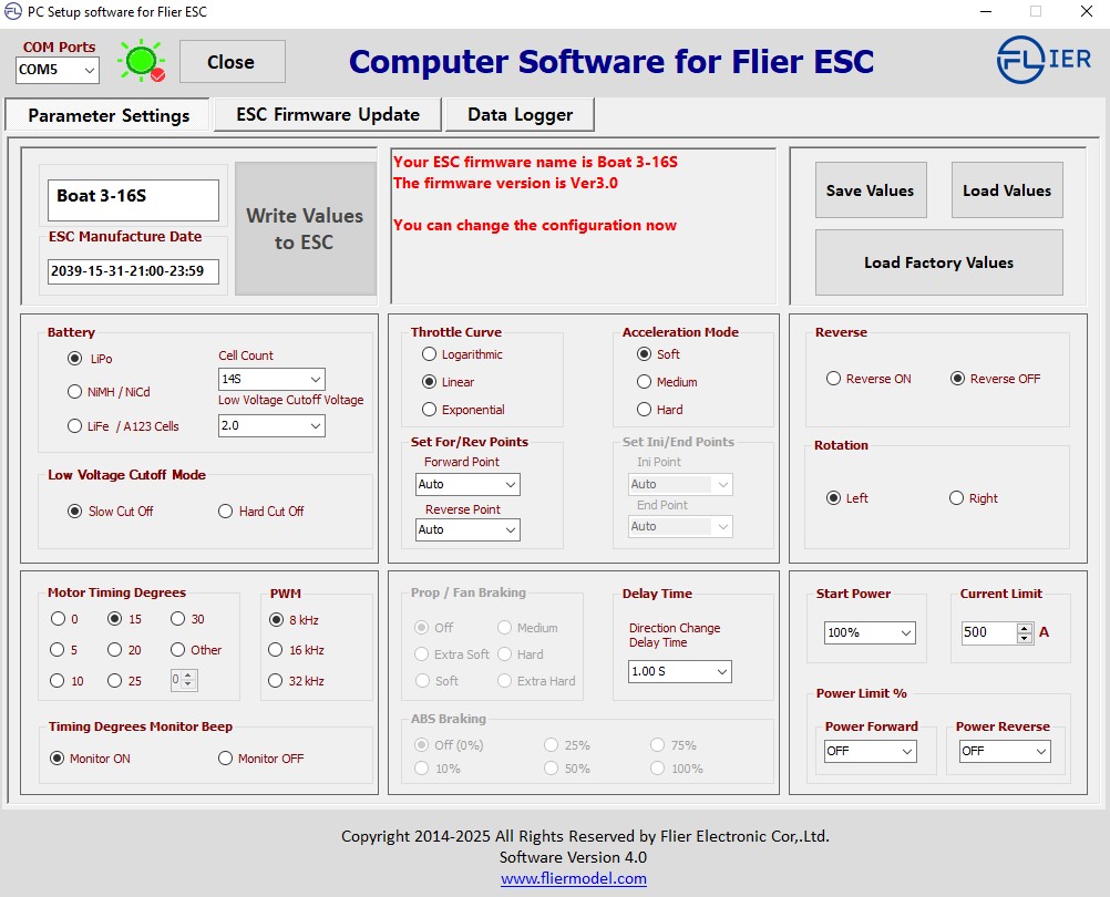

The picture will show my ESC settings. I am using 18650 cells (Samsung 30Q) and the link to the motor is below. How low do you guys set your cutoff voltage per cell? I have not tried to contact Flier as I suspected it was my BMS causing the issue. Is there a way to test if it is the BMS or ESC causing the cutoff? I am in the process of removing the duct but have to make a new part since my duct also supports the rear wing. My front wing is home made and probably also introduces extra drag. I would like to make a thinner one eventually. I never though of the possibility of the ESC heating up and causing the hard cutoff but that is very possible since my water cooling has been acting up. I can fix the water cooling issue and test again to see if that helps. My charger will only get me to 55V so I am currently working with at 8V operating range.

I’m not familiar with the software you are using as I use VESC tools with a VESC where you can set limit values for temp, voltage etc.
I missed this at first glance but this doesn’t seem correct.
I believe anything below 2.5V will cause permanently damage.
The date format is also pretty weird!
It also says Slow Cut Off which to me would imply that it would first cause it to slow down at some value above the 2.0V NOT abruptly Shut Off

500A Current limit seems a bit high haha. Would put it at 200A.
