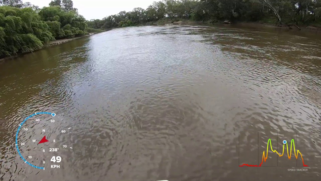

I’ve just been doing some testing on 16S with an SS56104 500KV and PLE040 gearbox with the VESC 75/300 and got to 54KMH (averaged up/down stream run). Running the Slingshot infinity 76 wing, with my aluminium 3 blade prop. Motor current was limited to 255A and I think it was hitting the limit, increasing from the previous test limit of 240A to 255A increased the speed so it definitely takes some amps to push this wing to these speeds. I wish I got some more data though.

Could you by time Share the logs? I would Like to See consumption vs Speed.
If I recorded logs on this ride I would share them! I’m really curious to know what the power consumption was at this speed and the speeds above 40kph. I’ll take it out again in a few days and get a log on 16 S and share it.
Here’s a log of the exact same setup on 12S. https://youtu.be/D7c8BObyICw
